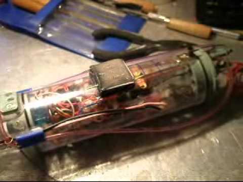

        After my succesfull testing i wanted to encapsulate the electric components, made a casing from styrene.
        Now the fun bit started, by using some clay all around i sealed it off, and started pouring in 2K glue, this glue will dry transparant and after hardening stays a little flexibel, done this in several layers.
        Lightblocked the fibers as much as possible and added some extra foam.
        Placed another piece of foam for the balance on the surface, the other one is used for when submerged.
        By using some long pliers and a makeshift rigg i could stabilize the magnetic switch inside the SD for glueing it tight.
        The compartment with the electric components will be kept clear, so i can inspect it visually when needed.
        By using a small rod i could add some glue inside the SD where the cables come through, i always glue cables on both sides, to some extend they are hollow, so if water finds a way to get in, you've got yourself a nasty leak.
        Last thing to show is, the other side of my magnetic switch, the magnet itself, made a housing with a little chain, i always try to keep all needed components on the SD itself, this way loosing them will become harder, by using the chain she will be connected to the SD.

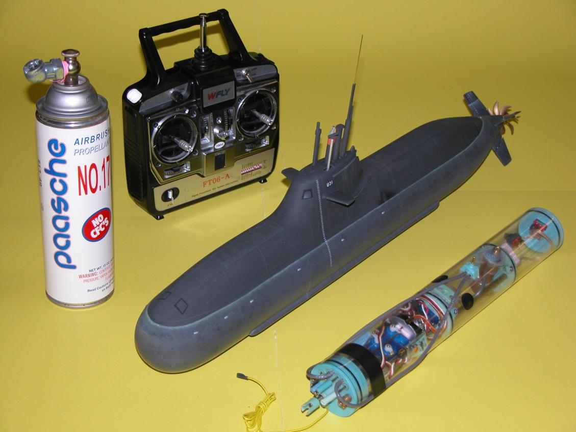

          Finished up all the electric stuff inside the SD, and made some succesfull tests, the magnetic switch is certainly the last item i could add inside the SD, it's official, it's full!!!!!
          The size of the 212 can be called small, but i couldn't resist to make some parts for static display, due to the detailed hull she deserves it.
          First step was, adding the safety lines and the little ladder at the front hatch.
          I've got to blame Mark for this, he provided us with some nice pics from the conningtower, a spray guard, and the additional things when cruising around in the harbour.
          On some pictures i noticed that strange rectangular thing below of the lights, it seems to be a kind off anti blinding shield for the crew when the lights are operational.
          A overal picture from the side, to my point of view it's a nice addition when on static display, i still have to open up the conningtower where the crew have their place when standing.
          Also made a short vid to show how things now finally work with the magnetic switch inside, enjoy.

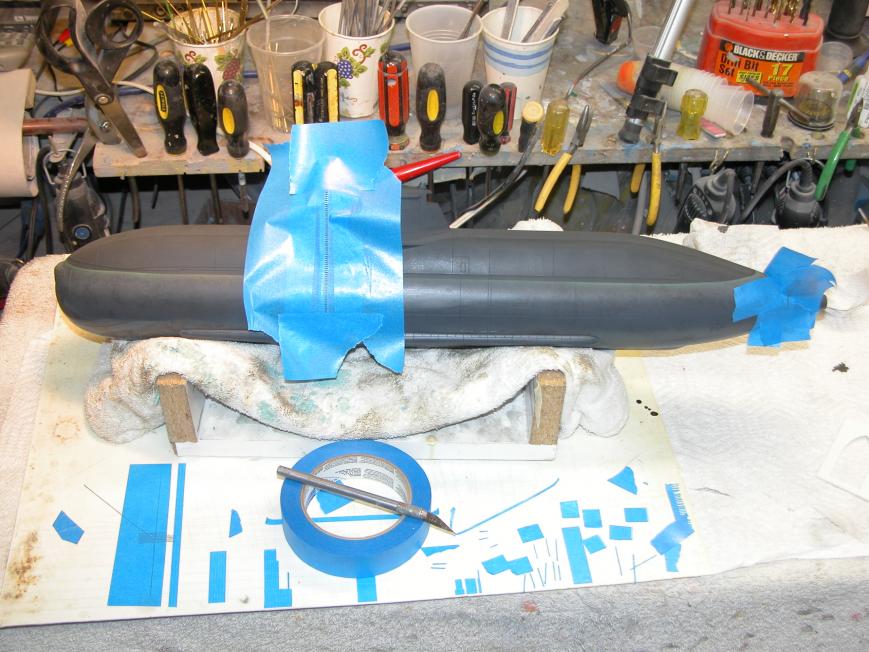

                      I've read about the weathering of the 212, the only thing not entirely clear is, how to add the toothpaste before spraying the underside, you mask it with a sturdy brush or use a piece of cloth?.
                      If you wondering why, well, shortly she will get her layer of paint, so i want to do some research in advance.

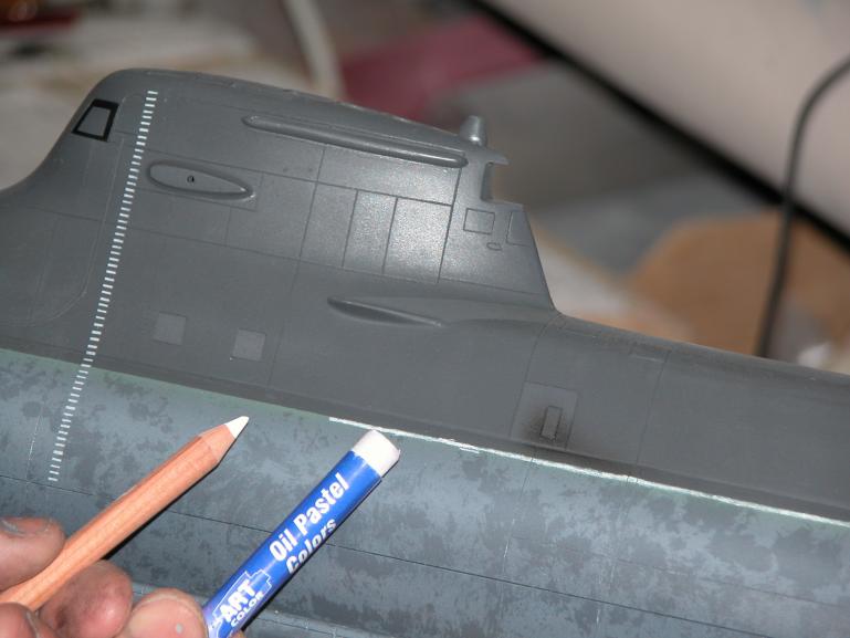

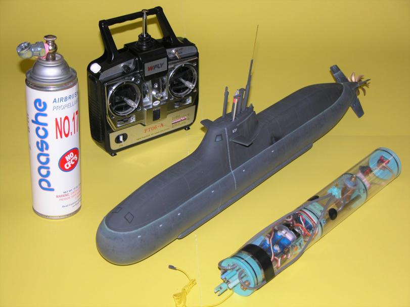

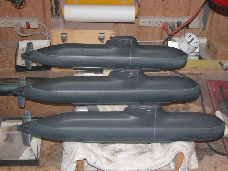

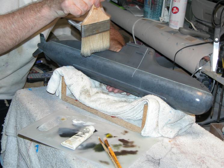

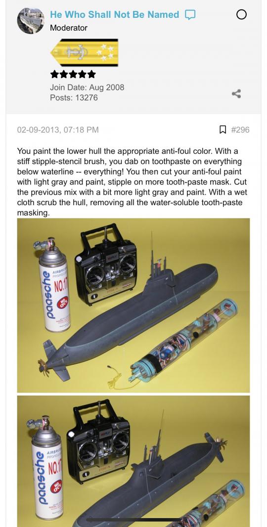

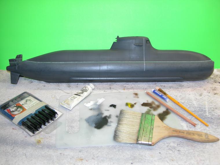

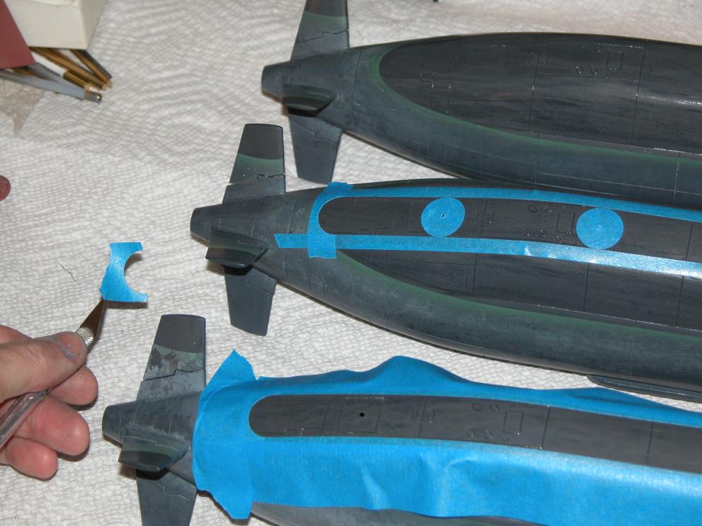

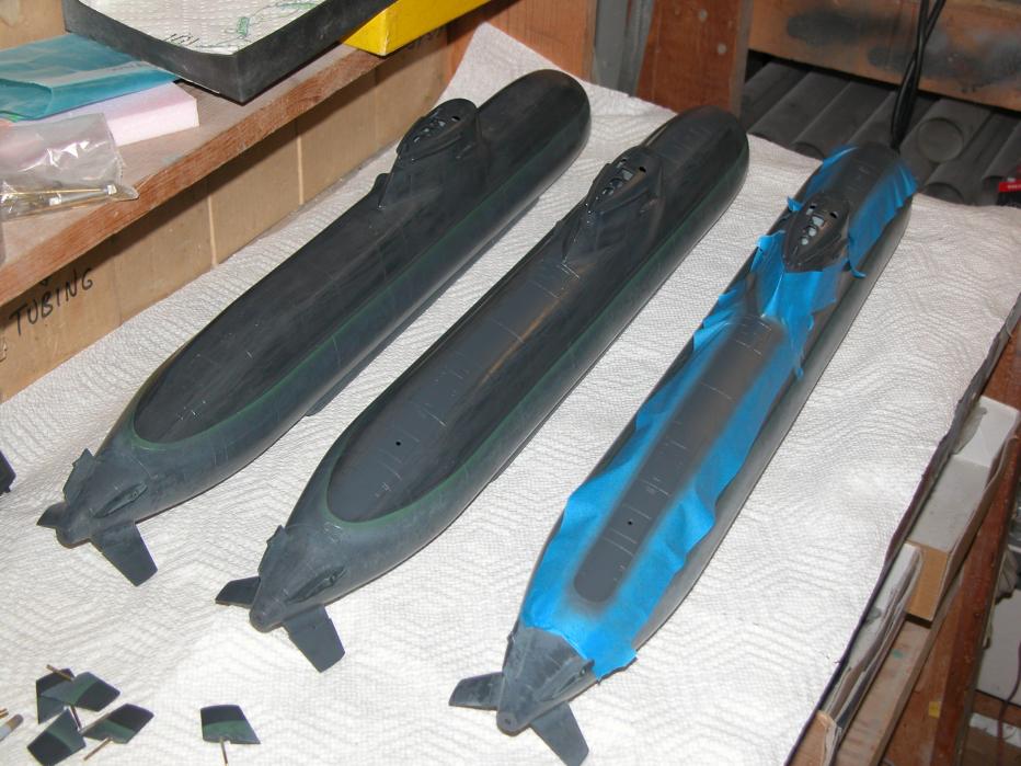

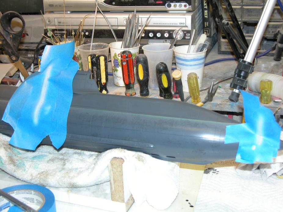

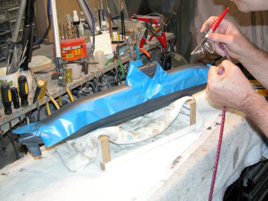

                        • 13941
                        #296
                        You paint the lower hull the appropriate anti-foul color. With a stiff stipple-stencil brush, you dab on toothpaste on everything below waterline -- everything! You then cut your anti-foul paint with light gray and paint, stipple on more tooth-paste mask. Cut the previous mix with a bit more light gray and paint. With a wet cloth scrub the hull, removing all the water-soluble tooth-paste masking. Click image for larger version

ID:	76191 I could not find pictures showing the tooth-paste masking trick, but here's what I got on the 1/96 Type-212, Manfred.

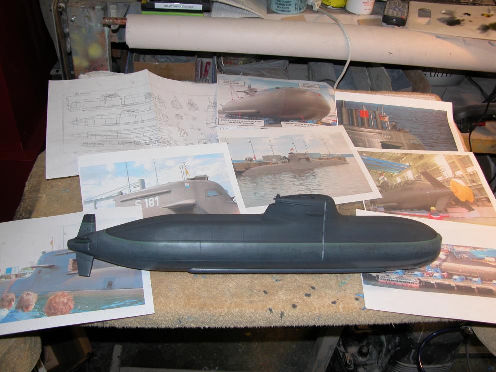

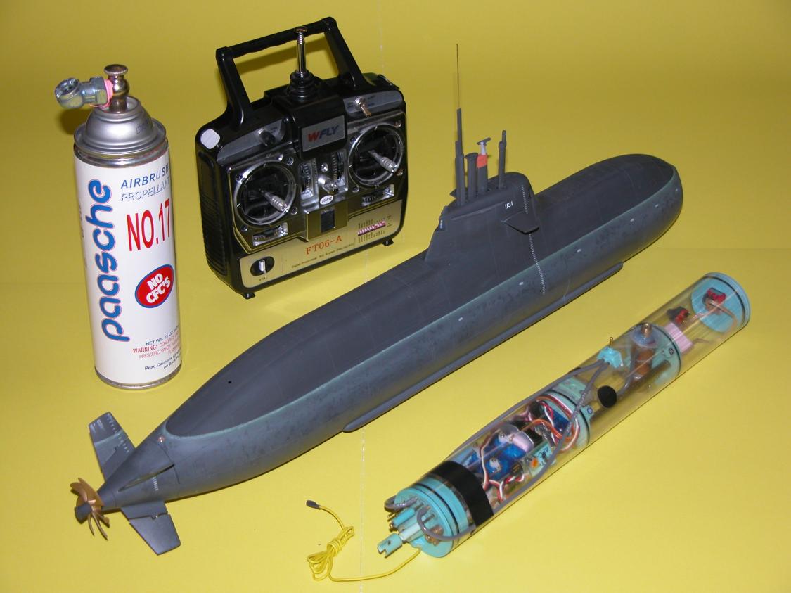

                            Last few days the tempatures are rising, so i left the XXIII alone, and got me some paint on the type 212, she finally has her natural colour.
                            Sofar i'm pleased with the result, wether i'll give her a weatherjob i really not have decided.
                            I also gave the inside a paintjob, it's a matter of personal opion, but i prefer this.
                            Made some extra anodes, which are placed at the underside of the hull.
                            The anti skid deck was sprayed with flat black, from the pictures i've found this can vary from dark grey to black, simply depending on which boat you build.
                            Within a few weeks there will be the yearly submeeting in holland, so she has to be trimmed again and ready for action, i still have to make some testruns before this meeting to be sure she's OK.

                                • 13941
                                #300
                                In the case of the German Type-212 'the appropriate anti-foul color' below waterline is a semi-opaque application of stippled on tan and shades of lightened 'hull' color. Yes, the initial boats were all the same dark-gray, top to bottom. It's the simulation of fouling below the waterline that gives the striking difference in 'color' between above and below waterline.
