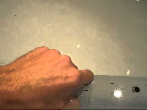

              The newly edited video, after rewinding the vid a few times it seems she will recover within two seconds after a launch,she was a bit higher in the water, probably because the torpedo's where not totally filled with gas.
              Once the torpedo is launched she is getting deeper in the water, exactly what you could suspect when loosing some bouyency, still i have to alter some things on the boat itself and then it's off to filling and painting her.

                I noticed that the bow is deflected down at the moment the torpedo leaves the muzzle. I wonder bow down will she go? As you're testing in a tub you can see the bottom of the bow hits the bottom of the tub and the action is stopped. Need to see how she"ll behave in deeper water.

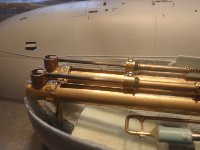

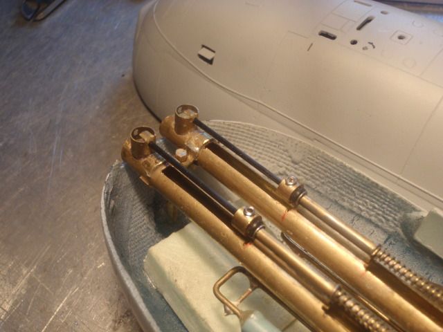

                    Also made the last adjustments to the launchtubes, like i wrote before i messed up the copper rods, i wanted to place stainless steel ones, but i found me some nice carbon rods with the right diameter.
                    It's space age stuff, but you can hardly bent it, i needed some very rigid rods and tried this stuff, these will be the last modifications on the launchtubes, i'm allready covered by foam dust from working on the tail of the XVIIb, i still want to add some details to the boat which i've found

                            I'm getting there David, i'm getting closer every day, the carbon rods even giving me a nicer slide action, you can't bent them by accident so you are assured a good sliding action every time.
                            There's nothing wrong with the actual design, i only messed them up by taking them apart to much, i love to tinker on other guys design, simply to see what is possible or not, and if i can add some improvements.

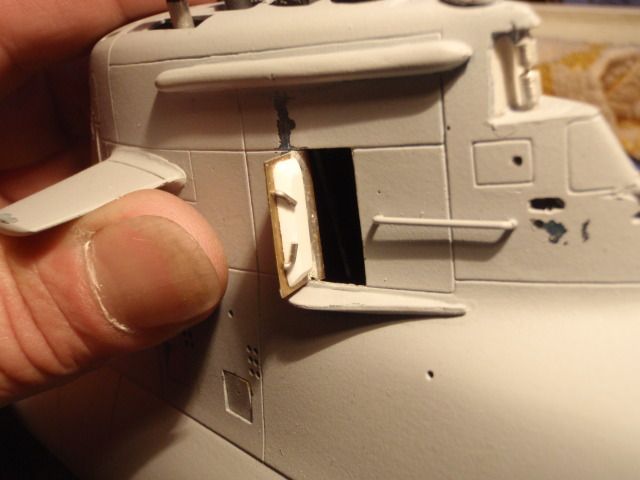

                                Still had to ad some things to the inside of the door, and i'm working on some things for static diplay, so it's not over yet.
