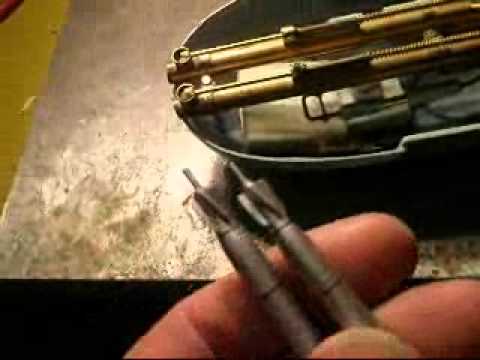

                    I agree with the find of Romel, if those nipples are to get commercially, it will surely be a good addition for the European market, for me it's working well, got me some butane lightergas yesterday and made today some promising trails.
                    Filling is easy and they shoot out without any problems, to illustrate this i made a vid inside the shop,just to show how everything is working, gave the credits to David for his design and building this torpedo system, enjoy.

                          Not much to show, but this what you get when you take apart the launchtubes, to get the tiny lockball out inside the breechblock, i used a magnet, worked like a charm, allready made the slits with the dremel, it's a bit messy, i'll clean them up and start putting them together, to be continued.
