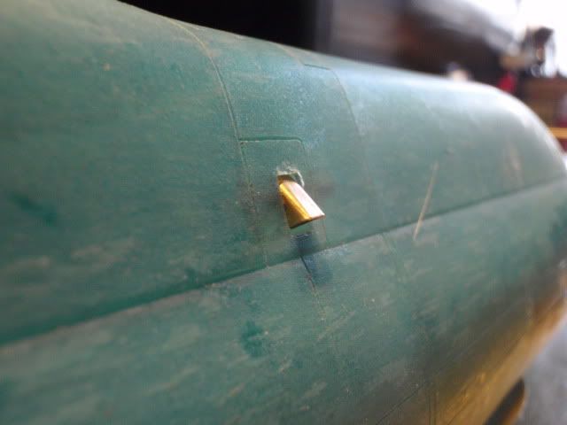

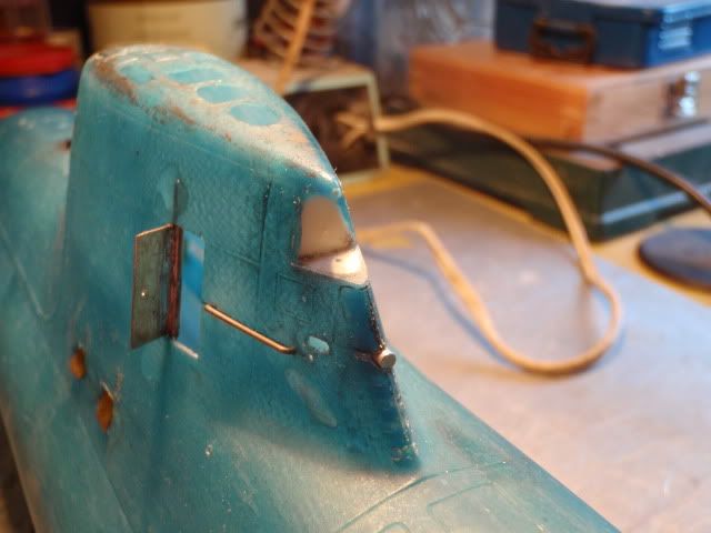

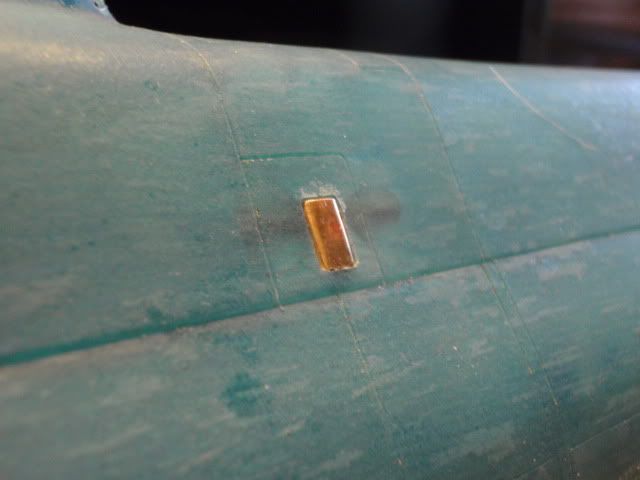

                      The meshed grill i used on the exhaust was wrong, ripped it out, they placed a kind of cover on the inlet, when using the diesel it will swing open on command.
                      It should look like this, deflecting the fumes down into the ocean to keep a low IR profile.

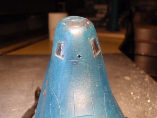

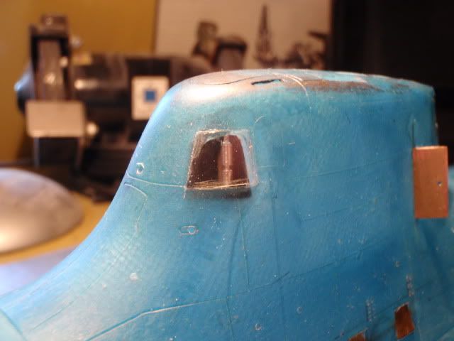

                      The navlights are behind the windows, carefully tacked with minimal CA, don't want to have that white haze, they will be reinforced with some 2K glue.
                      Started with filling up the cutted space for the rear navlight, added also the light lower inside the tower, done this with a scrap piece of aluminum.

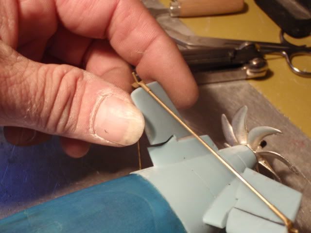

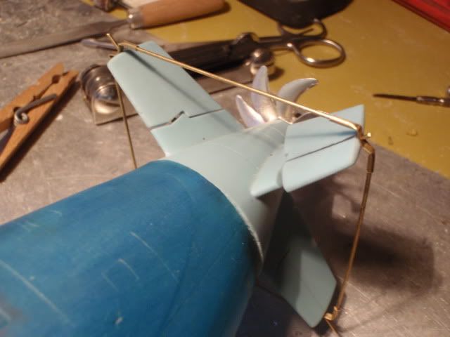

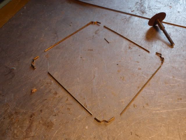

                      And now my beloved guidingwires, I wish i had listened to David, those things gave a lot of trouble, on each point of the four rods there is a hinge part, made them from thin copper tube, you can insert the rods into the bended tubes.
                      I had also had to make pins on top of the X tail feathers to place the hinges, you guys allready know the lovely story behind that.

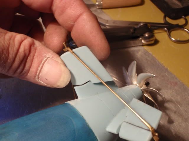

                      This is the first stage, just to see if it can work, i allready know now that the diameter of the rods is to big, have to change that, for me it proving that i can place the guidingwires without obstructing the tail feathers.
                      Greetings Manfred.

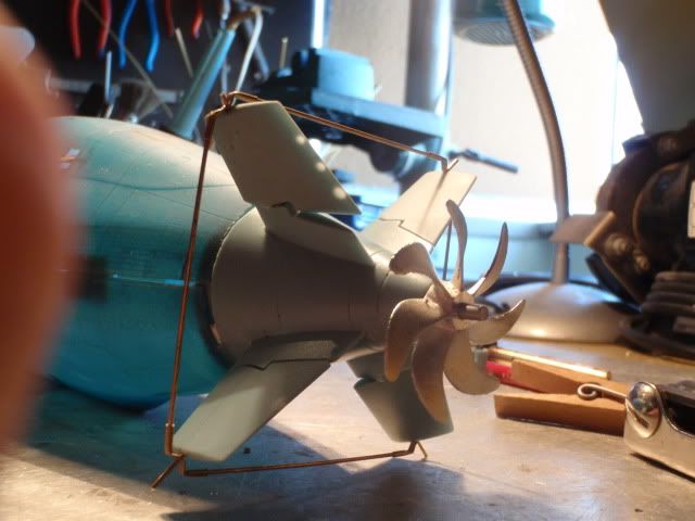

                              To please somebody more some more detailed pics from those God awful guidingwires, enjoy
                              Just to test if the feathers have enough room to turn.
                              Wether you like them or not, it's adding more to the model, but that's my opinion.
                              Greetings Manfred.
