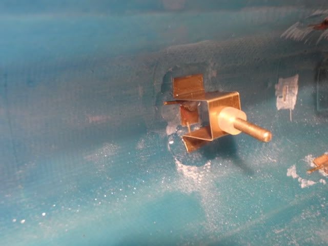

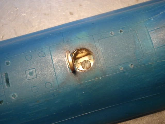

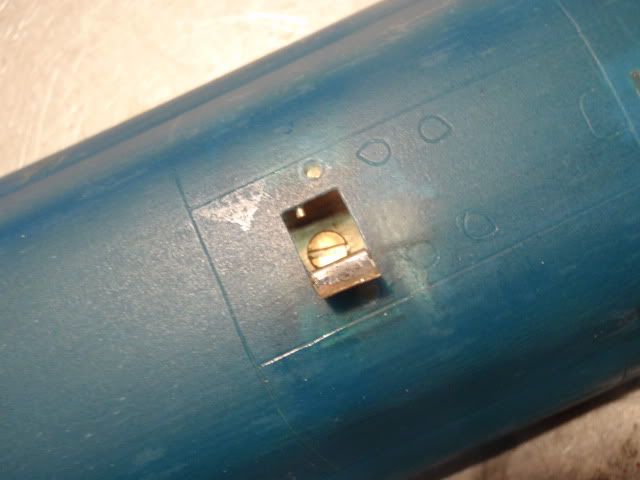

              After some playing with the V tail mixer i went ahead with some other issue's, still had to design a way to get the upperpart secured to the lowerpart, since i don't use the Z cut i had to find a other way.
              Also made a solution for the endcap that is being placed after the propellor and changed the guidingwires on the X tail, i'm slowly thinking about the WTC buildup, i've got to get a lot of stuff inside this cramped space.
              Like i mentioned before to David i wasn't pleased with the size of the wires, took it all apart and builded it up again from some smaller wires, now they look more scale, adding the little vanes was more or less a gamble, i could do without, but i wanted to try if it was possible to build.
              Still have to give them some profile by gentle use of putty and sand them into shape, anyway the beginning is present.
              Went ahead with the brackets for securing the upperpart, first job was glueing them on just under both hatches, added a screw and secured them by using a piece of silicone tube, this way you won't loose them during unscrewing the upperpart.
              Also made a clamp that will secure the backside from lifting up, it slides under the X tail part securing the rear.
              The deckscrews will be conceiled by the hatches, just like intended, did the same trick with the Walter V 80.

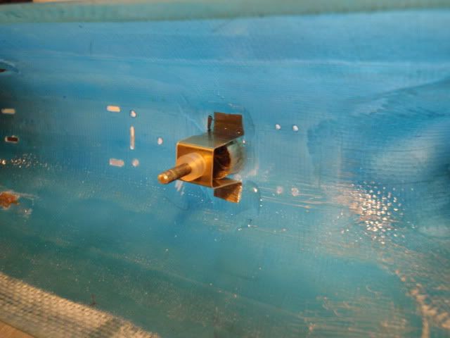

              This is my solution for the hub placed behind the propellor, instead of just pushing it on it's secured by a little screw, have no idea how you guys call them, but it's doing the job.

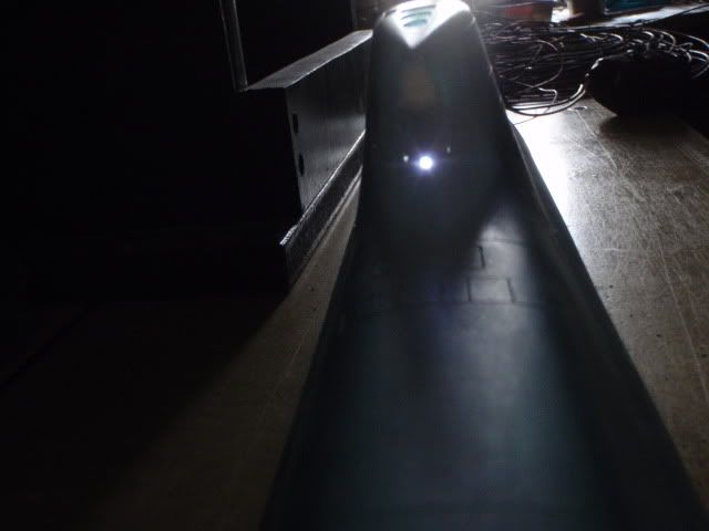

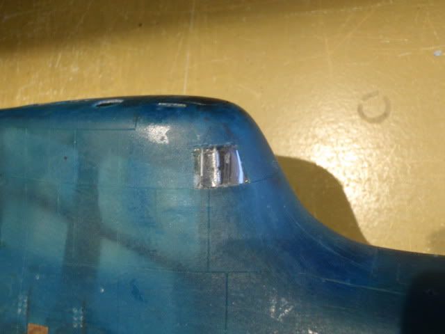

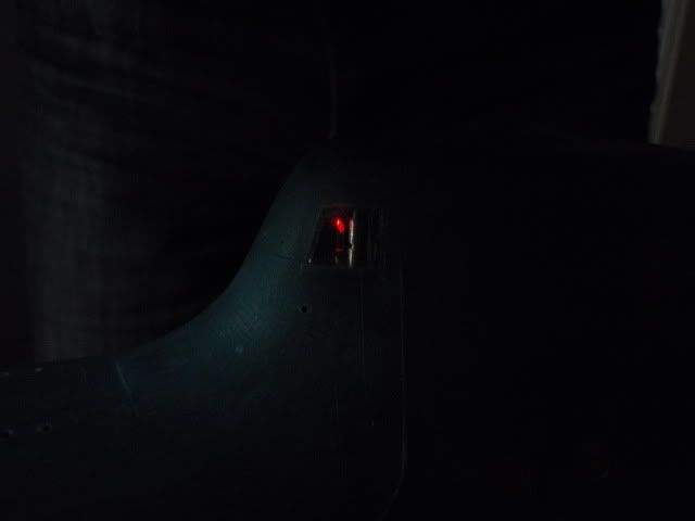

                          #72
                          Being old has some advantages, they call it wishdom by experience, the remark of Tom about the navlights kept spooking around inside my brains, today at work it struck my mind.
                          I'll show you guys what i've done in a short while, just a prototype, only to test if it could do the trick, have to refine it further.
                          The lower rearlight, if it goes well i'll add the upper rear light.
                          Leftside navlight.
                          Rightside navlight.
                          Frontview of both navlights.
                          The makeshift wiring to get me some light.
                          The easy way for securing it with some ducktape.

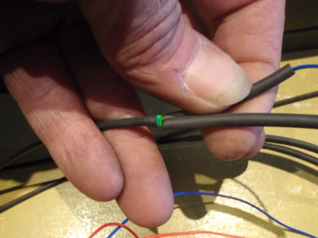

                          The idea that struck my mind was, using some optic fibre cable, we use it at our work, you can see the glass part in front of the navlight.

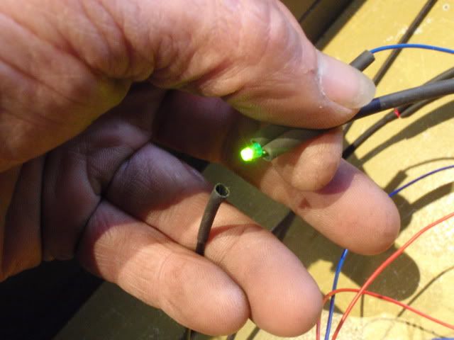

                          Used a small green led to create the light at the end of my optic fibre.
                          Made a makeshift coupler using shrinkhose to keep the optic fibre connected to the led.
                          Here you can clearly see the green light leaving the optic fibre inside the nav housing.
                          It will take some fiddling to get the maximum light from the fibre by shaping it into the best lens, God i love being old.
