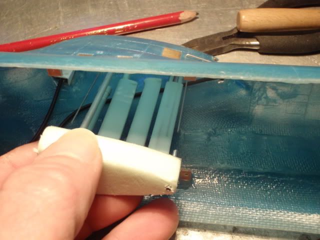

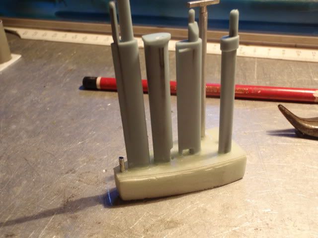

    This base, made from foam, i allready had made before i started with the liftingmechanism, it's a low tech solution for raising your antenna's.

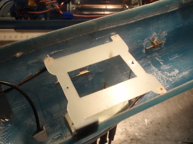

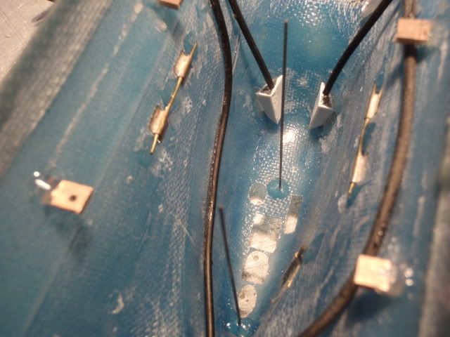

    Placed some guiding rods into the tower and added the glue to get them tight.
    This step i did directly after adding the glue, shoving the foam float into the tower, before it can cure.
    It's a tight fit inside the tower.
    Another plate placed at the bottom of the tower, with this one i can guide the rods, and align them in such way that the float will slide easely up and down the rods.
    Left the complete setup cure for a day in the wanted position.

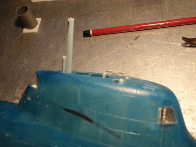

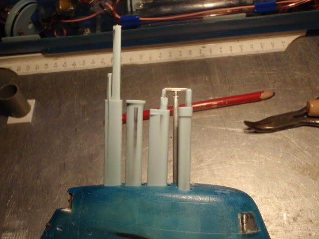

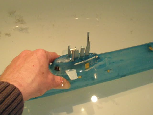

    Due to the simple nature of this plan B, it's not possible to retract them completely inside the tower.
    But what the heck, they slide in and out, replaced the radar antenna mast for a thin aluminum tube to get the weight as low as possible.

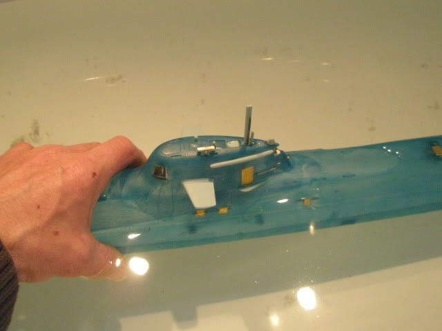

    Testing inside the bath, first stage, the simulated boat at the waterline, the masts are staying low.
    Second stage, dunk the boat underwater, the masts will rise because of the added float at the base, as you can see it's a simple solution and it's working.
    Only added modification is the little piece of lead, due to the shape of the float i have to compensate the bouyency of the bigger part compared to the smaller part of the foam, this way it won't get stuck inside the tower.

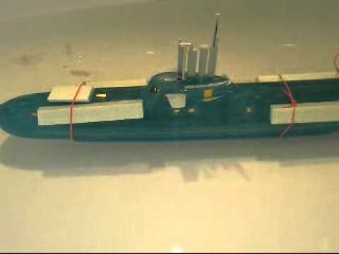

          Finally freed from the oblications that mothersday bring i grabbed some precut foam and dunked the 212 into the bath, this time with the goal to get her balanced.
          Read David's cabal report about trimming with foam over and over and took the plunge, with my dry hulls it's the other way around, adding lead for the most part instead of foam, once you get the hang on it, it's working fine.
          Scribed down the positions for glueing the foam parts inside, so this week get me the second run to see if i have the alter some things, i'm getting closer and closer to the maiden of this gritter.

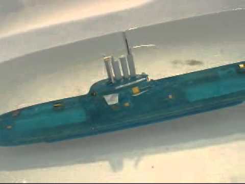

                            Made some runs on the surface to let her cool down and submerged near the shore, she is slightly positive balanced.
                            A nice scale like run, very responsive on the vanes, power only 30%.
                            It's also possible to use creeping speed with the same stable result, trimming accurate the beast pays off.
