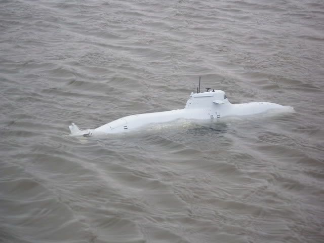

      And now for my report on the outdoor trails of the torpedo's, today i did some testruns, blimey!, they are hard to catch on video, compared to my electric one's they are tiny in the water.
      Some specs i got from the trials, did several shots and got me a marker at about 8 meters, recalculated that would mean 24 feet, so you were right at the weight thrust ratio, the butane produces less power, on the other hand you get a civilised launch which can be easely followed.
      I made some vids, but the launch itself is hardly to see, because i decided to get the videoshot from far away, i hoped to record the track of the torpedo but it slightly turned to the left out of sight.
      I'll edit the vids and will post them later, be patient.
        • 1645
        #258
        Edited the video and uploaded it, it's still hard to see, in the first clip after the title torpedolaunch you can see one torpedo running out of sight, from my stand of view it went out the tube controlled, speedy but not too speedy.
        It certainly invites to make some more vid's in the future, unfortunally the tempartures are dropping over here, so it will be spring next year to get me some better footage, even better would be a swimmingpool inside, this way i can follow the complete launch.
        It also gave me the oppertunity to get some running time on the 212, gave it up after half a hour because of the temparture, i've got to be patient for next time.

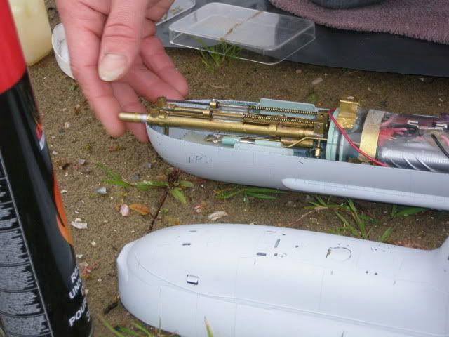

            Romel,
            You need to use the pliers against frost bite, when charging the torpedo it will cool down, you can see that at the filling nipple, it is turning white, because it is starting to freeze.
            Making a fixed position for the filling nipple is a bit tricky, because you have a sliding action from the breechblock, the hose itself is not that flexible that it can freely move without obstructing the breechblock.
            For now i keep it simple, just following the instructions from David's cabalreport about the torpedosystem and how to manage it, i did change something in the procedure, lubing the outlet of the torpedo with some vaseline, this way i don't need that much force to launch them on my front servos.

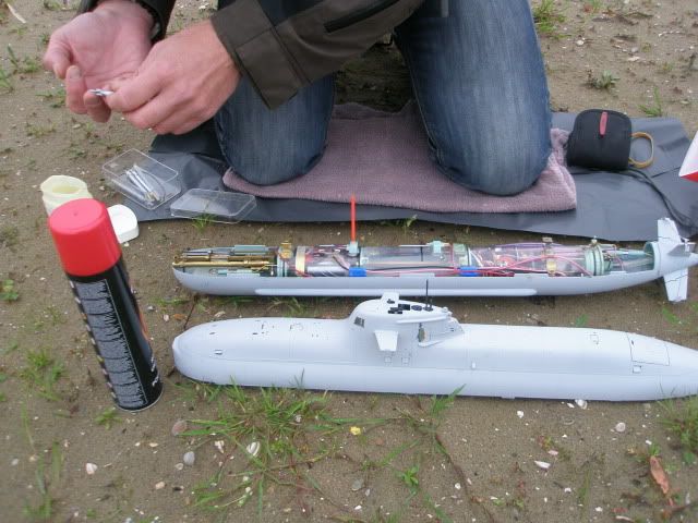

                    Today i wanted to clean all memorycards i have, and found these pics, some i've used at youtube.
                    Here i'm lubing the rear ends of the torpedo's with some vaseline, this way the breechblock don't have to use so much force to release the torpedo, and offcourse a lesser load on your servo
                    Loading the torpedo into the tube prior to fill it up with liquid gas.
