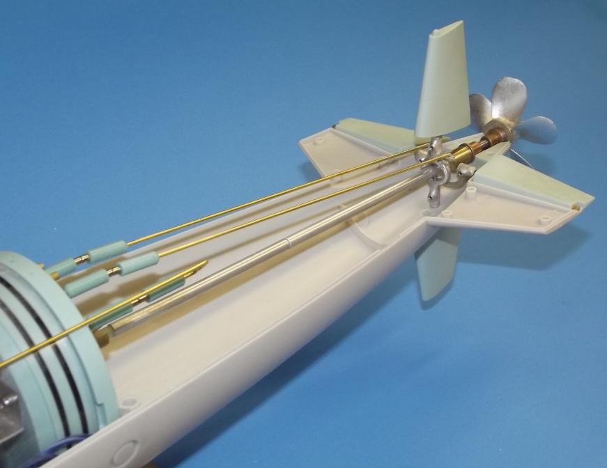

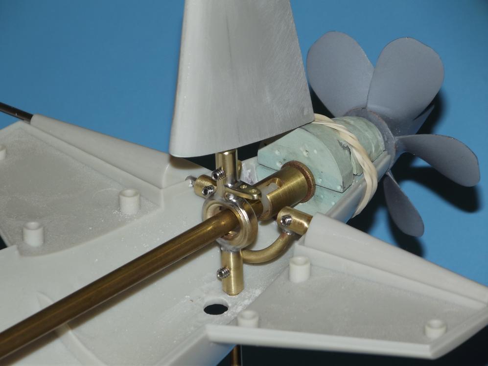

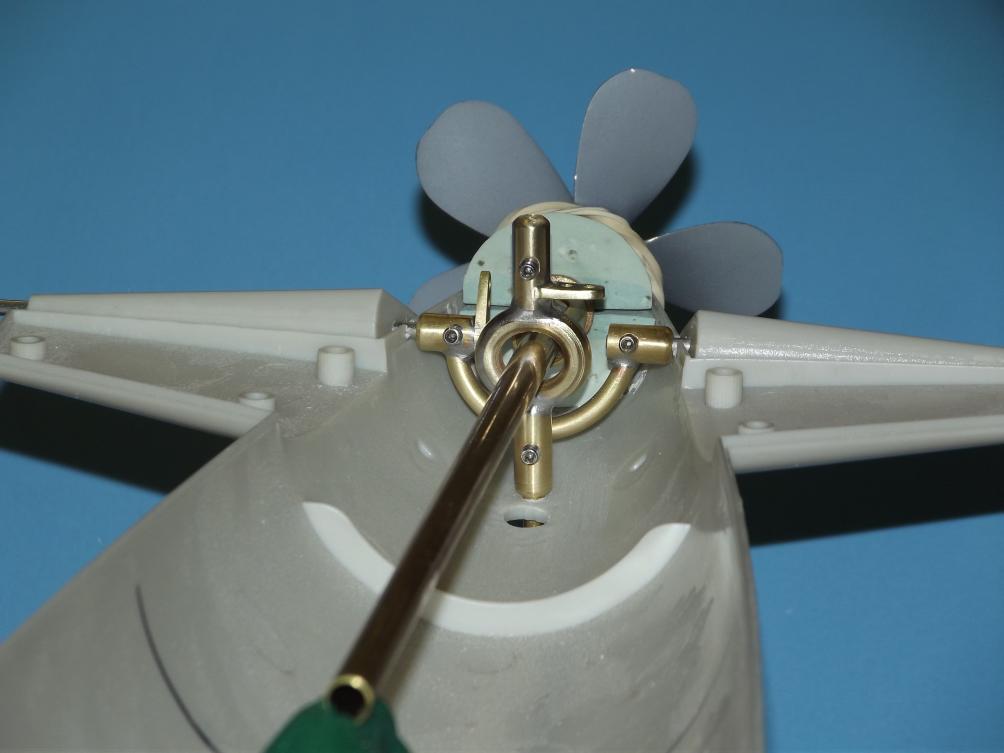

      Good, solid work there, but a bit too Rube Goldbergish for my taste; a simple two-yoke arrangement would have kept that linkage simple. Even in a tight pool, that SKIPJACK will turn just fine with the scale rudders.

        Thanks David!

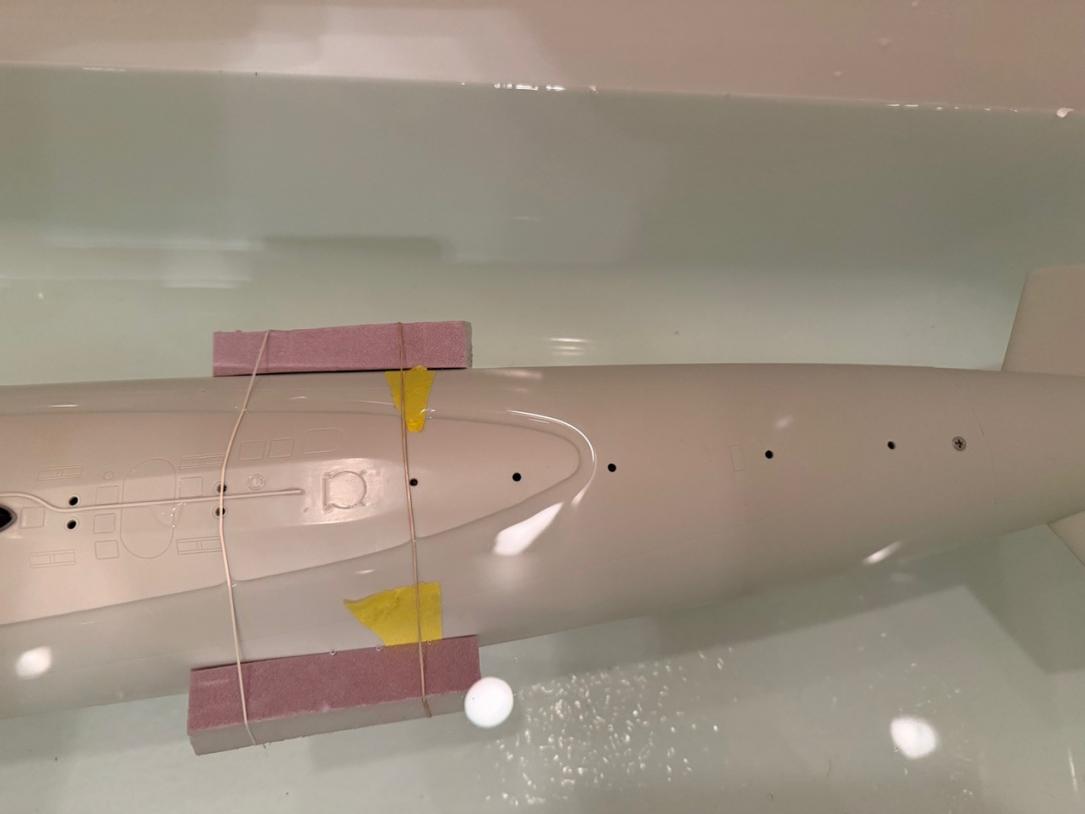

                          Help!

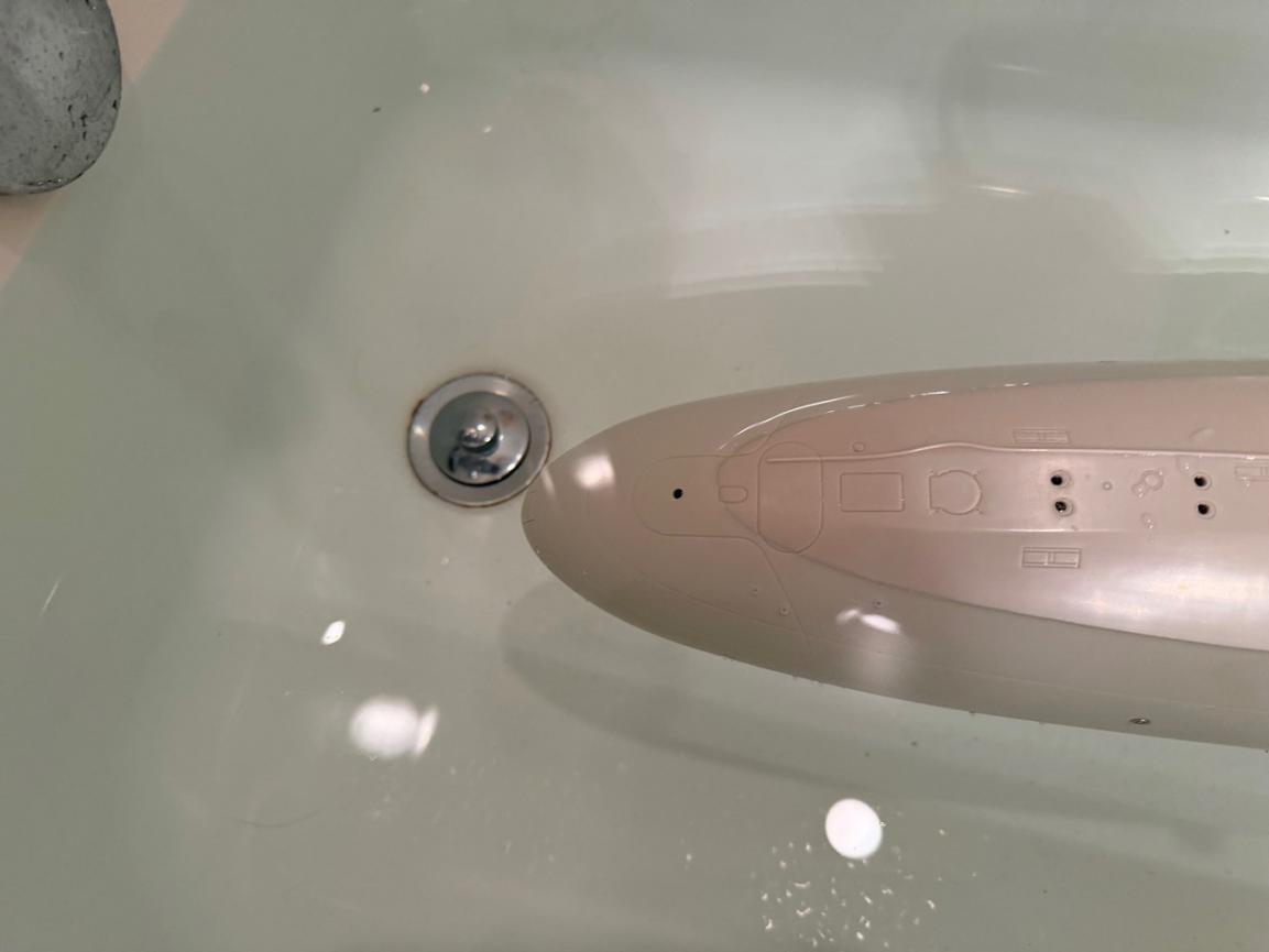

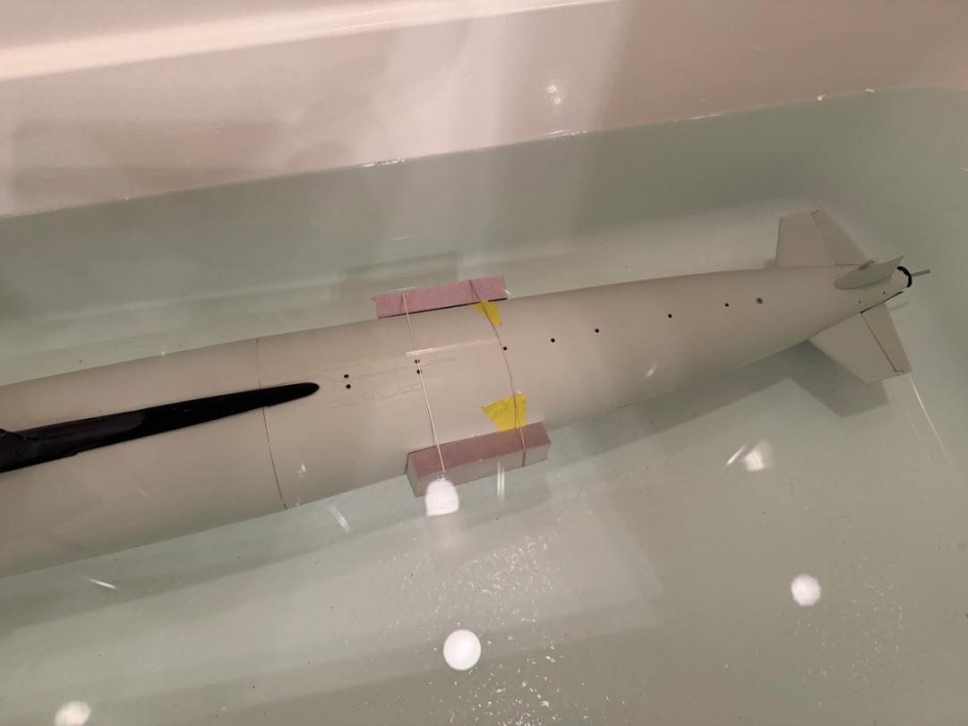

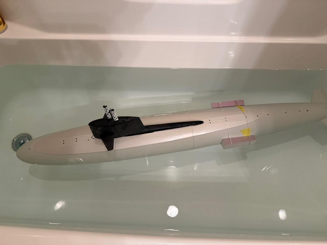

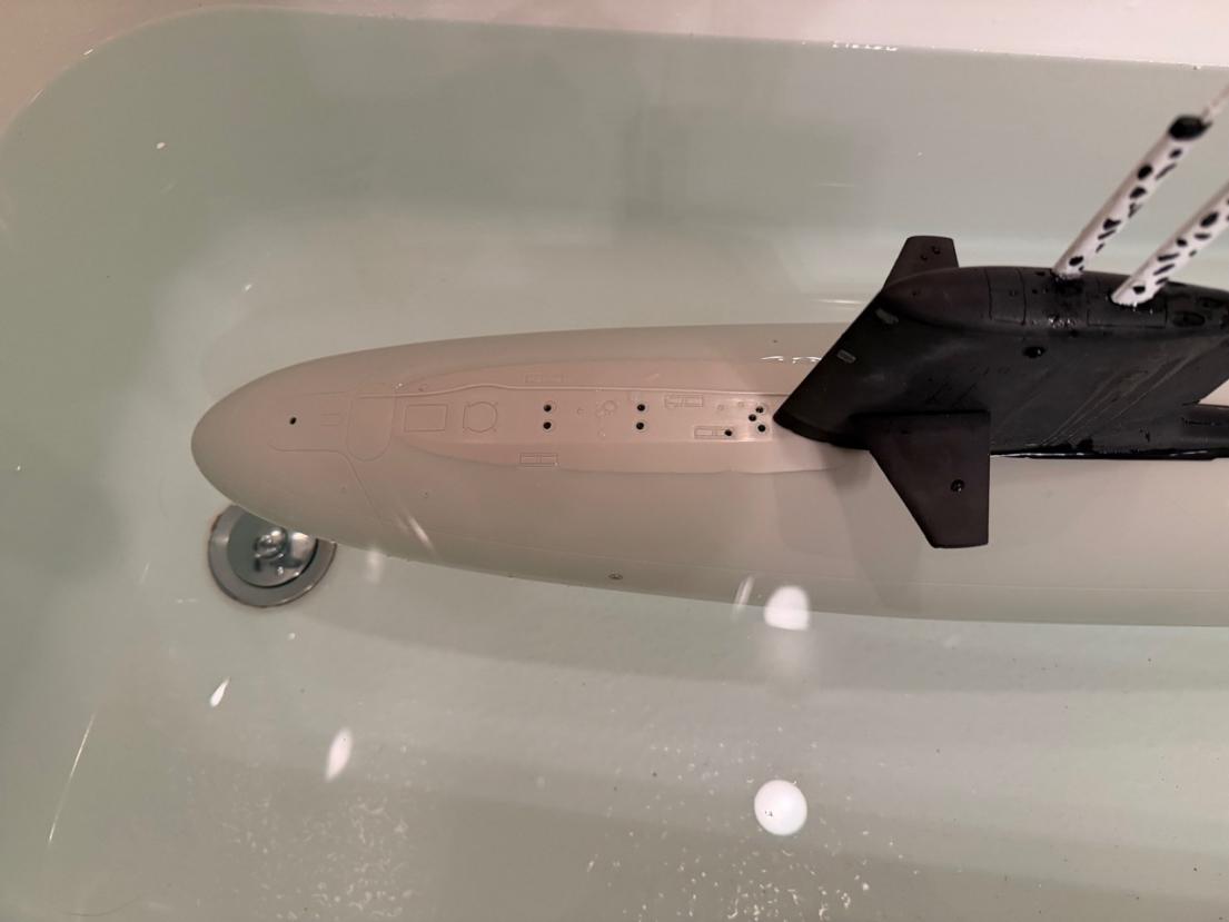

                          Ok, trimming.
                          Surface trim:
                          Needs to sit higher
                          Submerged trim:
                          Needs to sit lower
                          Surface trim
                          Submerged trim:

                            Any foam mounted above water line lowered so that it is situated below waterline. add more fixed ballast weight and compensate with additional foam as required.
                              David, thanks! will do
