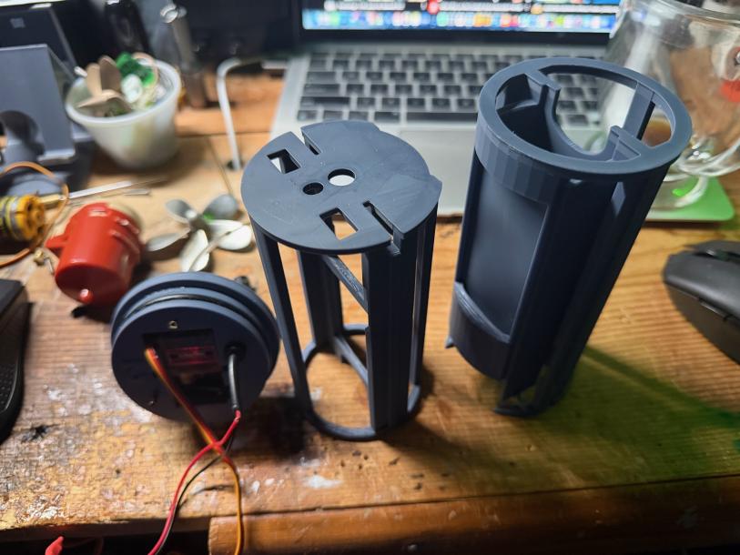

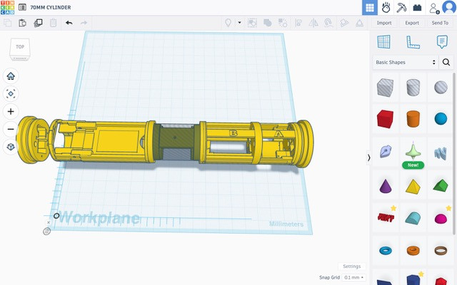

              Designing and resin printing a cylinder.... lots of work!

                #82
                Click image for larger version  Name:	IMG_0171.jpg Views:	0 Size:	67.7 KB ID:	191603
                Work?... WORK??.....WORK!!!!????????
                You fed filament/resin into a Replicater; tapped some keys; pushed a mouse around; and mashed the 'enter' button. That ain't work!
                  This is work:
                  hahaha, point made!

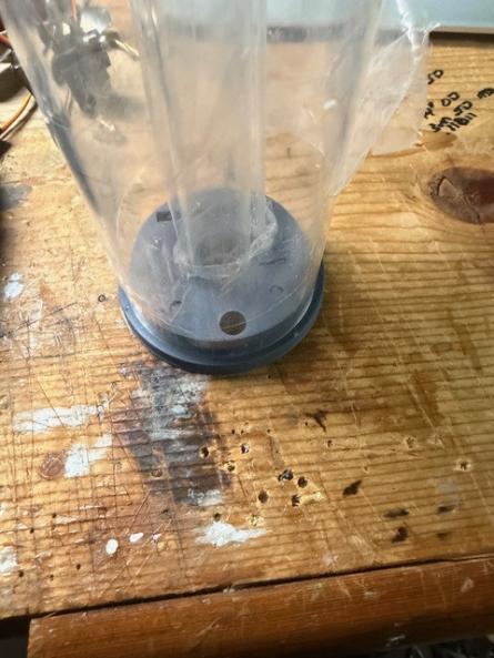

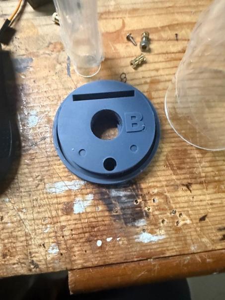

                          Advice needed! I need to adhere my ballast cylinder to the ballast bulkheads. As shown i created a channel in the bulkhead for the tube to seat. Was thinking I would fill channel with West Marine 105 epoxy resin then seat the tube?

                            #88
                            I would recommend clear RTV adhesive. Effects a watertight seal, has reasonable adhesive force, and will permit non-violent disassembly, if the need arrise.
