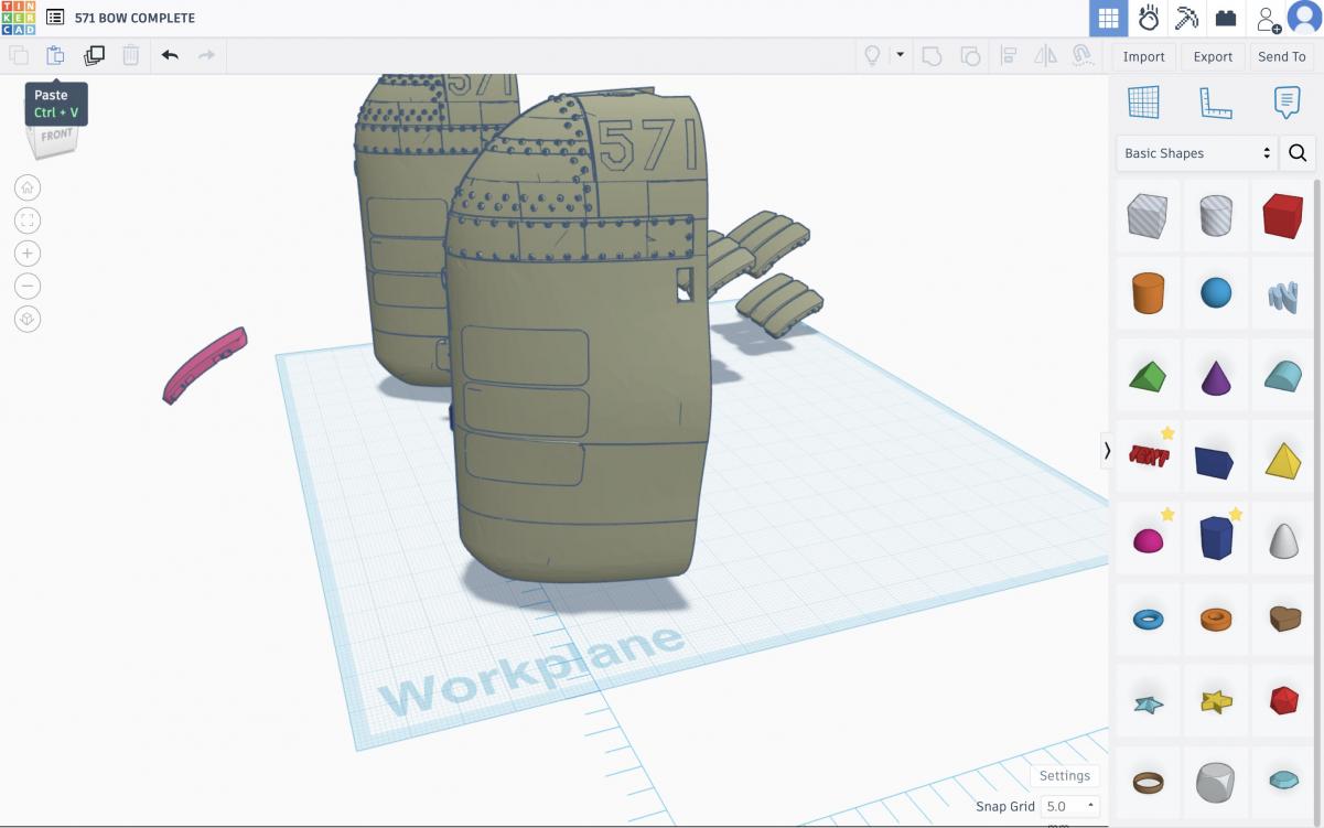

ID:	185836 My current project is 3D printing, assembling and converting to RC the USS Nautilus SSN571 STL File Package fromThe Nautilus Drydocks. Since I only run my Submarines in my pool I am scaling this model down to 80%. The bow torpedo hatches are very thin at 80% so I used Meshmixer to slice it and imported to Tinkercad so I could design the bow with closed torpedo hatches in the closed position, making it more durable.

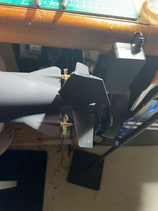

              Props and reinforcement cradles

                Looking awesome so far!
                I'm doing a print of these files for Frank, scaled to 155%, so about 83" overall length.
