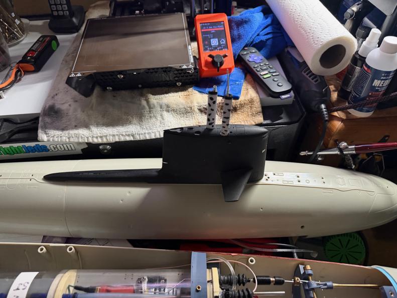

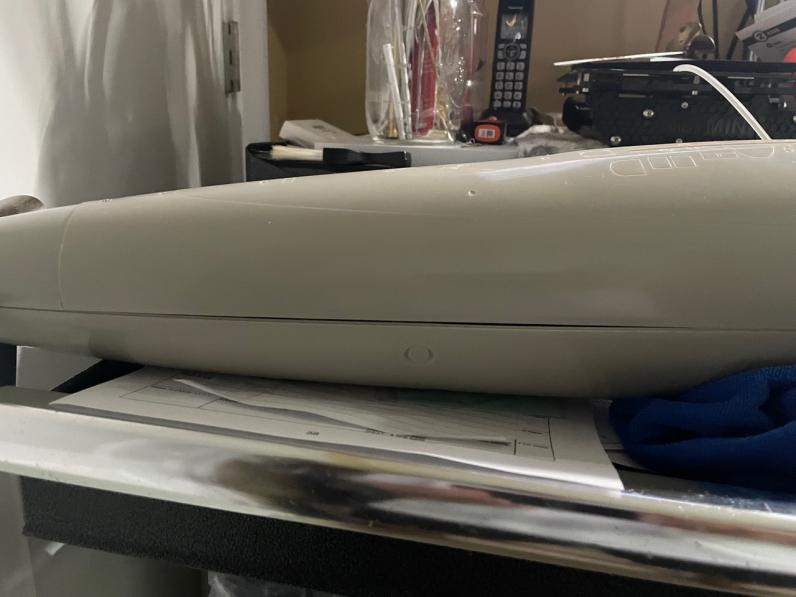

    1:72 Type 212 3D Print initial trimming completed

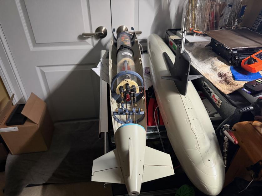

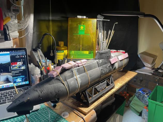

      1:72 Skipjack conversion using MAXIMUS-Modellbau fittings kit. Printing fittings on my new Resin printer

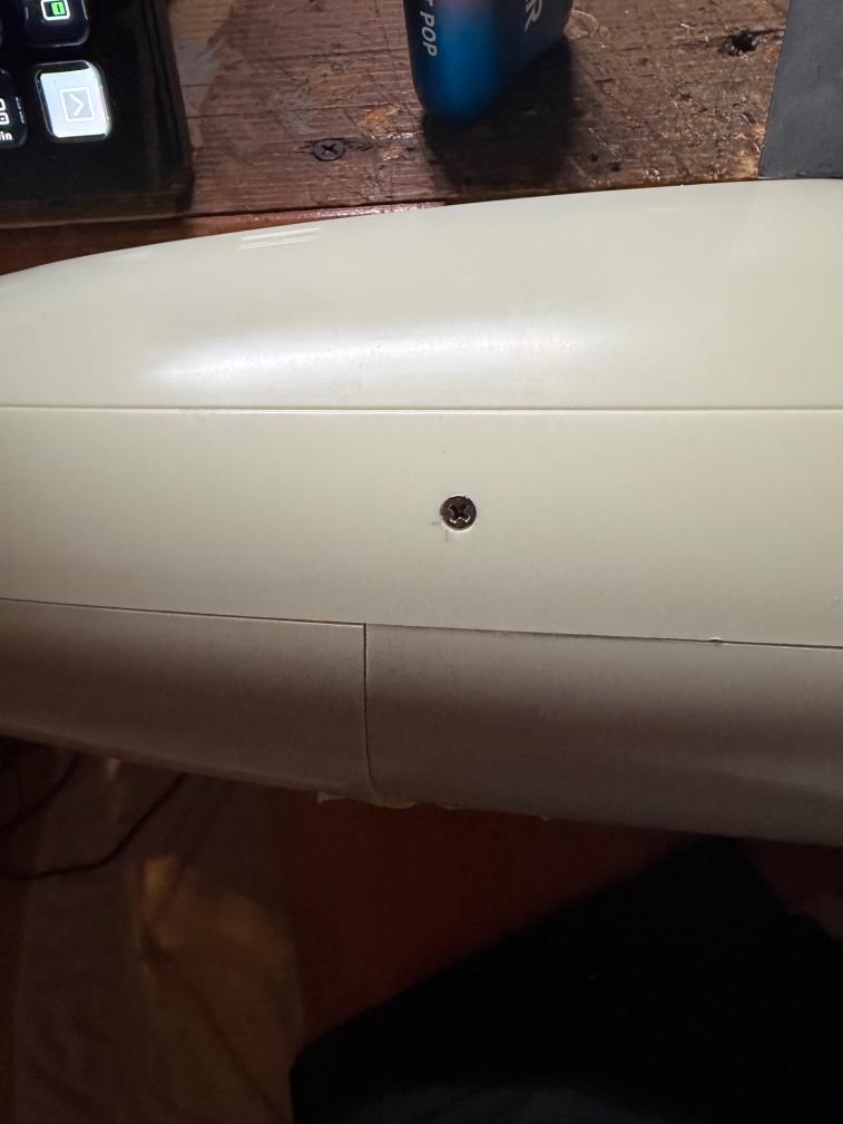

      • biggsgolf
        • Jan 2020
        • 1036
        #48
        Further progress Click image for larger version

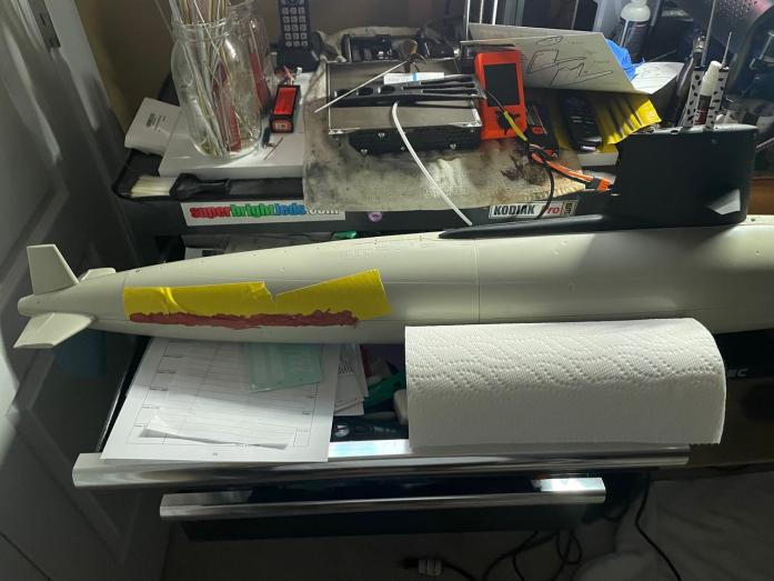

              #51
              Gap to fill Click image for larger version
              • biggsgolf
                • Jan 2020
                • 1036
                #52
                Click image for larger version  Name:	IMG_4120.jpg Views:	0 Size:	49.1 KB ID:	190870
                Filler applies, next sanding: Start with a coarse 36- or 40-grit sandpaper to shape the filler, then progressively move to 80-120 grit for leveling, followed by 180-220 grit to refine the surface, and finally 320-400 grit for preparing the area before applying primer

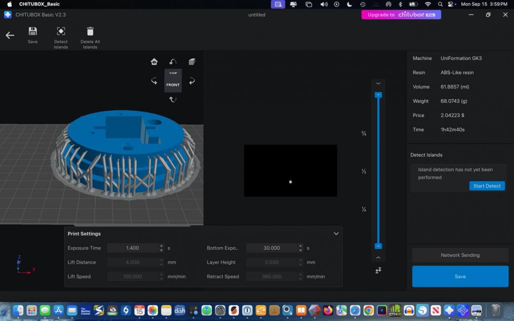

                  Resin Bow Cap 70MM Cylinder

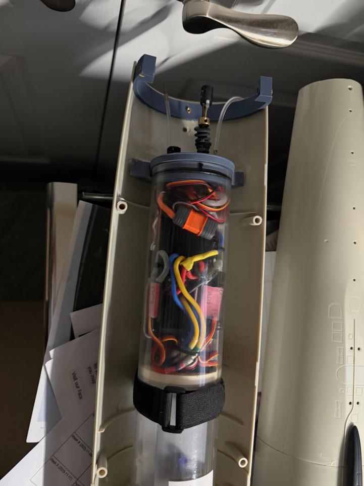

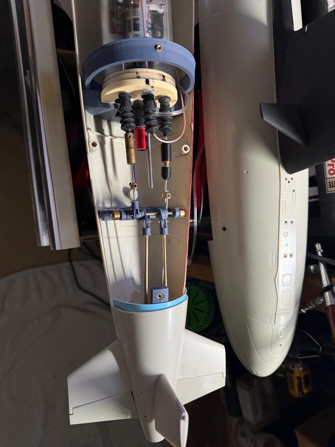

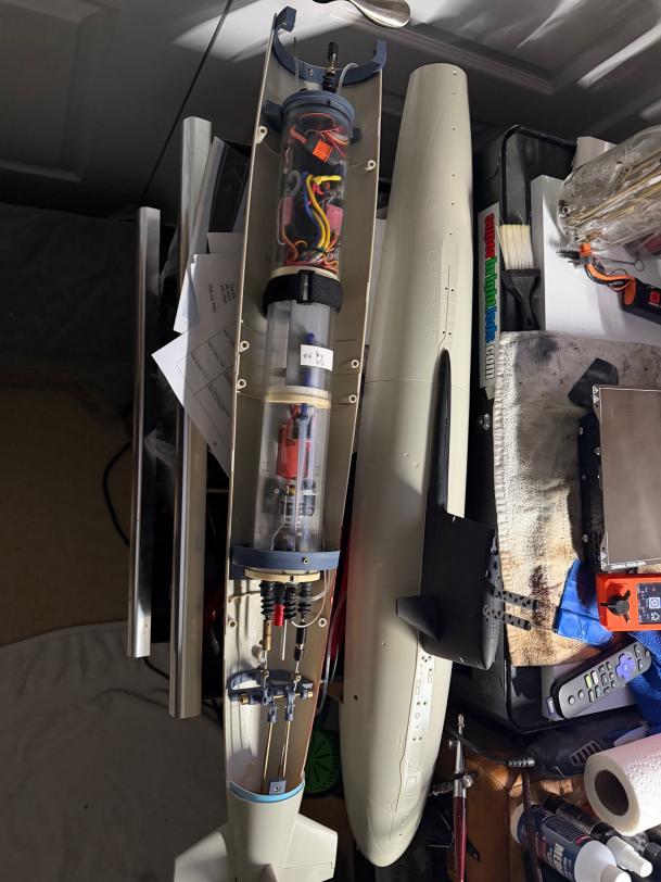

                    The Resin endcap works perfectly. All mechanics on the 1:72 Skipjack are completed. The 70MM cylinder may not be big enough so I am going to design and build a larger one.
ID:	191067 Click image for larger version

                      #55
                      Don't be an alarmist idiot!... go with the existing WTC, trim the boat out thoroughly and you will find it suitable for the task. DON'T RE-INVENT THE WHEEL on a whim!!! Get some run-time under your belt before you panic over imagined 'issues'.
                      Keep plowing, you're doing fine. Don't screw up now.
                      I HAVE SPOKEN!!
                      • biggsgolf
                        • Jan 2020
                        • 1036
                        #56
                        I HAVE SPOKEN!!
                        Haha, thank you! I hear you sir! I actually mentioned the possible ballast issue to head off "undersized ballast" comments, lol. We will see!
                          #57
                          You took my not-so-gentile prod with good humor. You're my kind of guy, sir. You'll be pleasantly surprised at how little water you need in that ballast tank to counter the displacement of the SKIPJACK's above waterline floodable structures -- no more than 15 ounces worth if I remember correctly.
                          Keep posting, the beatings will continue, my friend.
