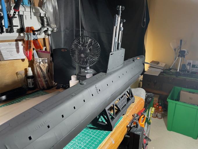

        Replaced the hatch, fixed tail seam and hull seams. Anchor arrived from Australia. Click image for larger version

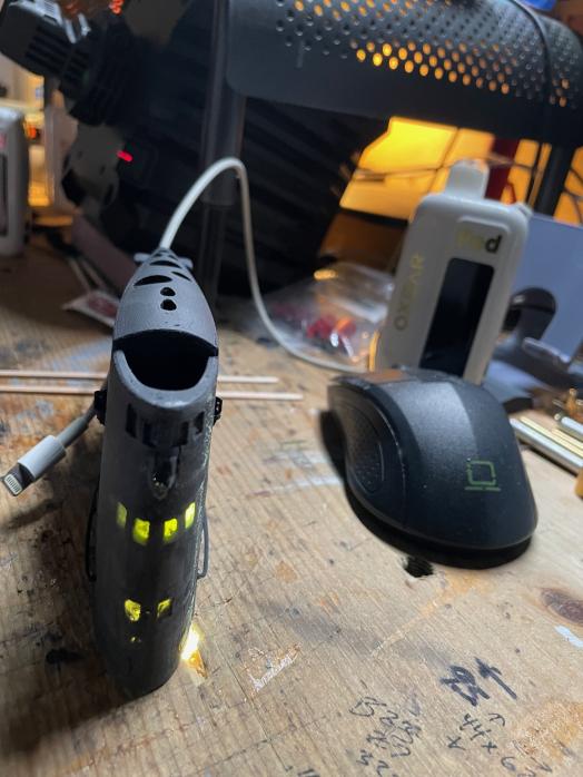

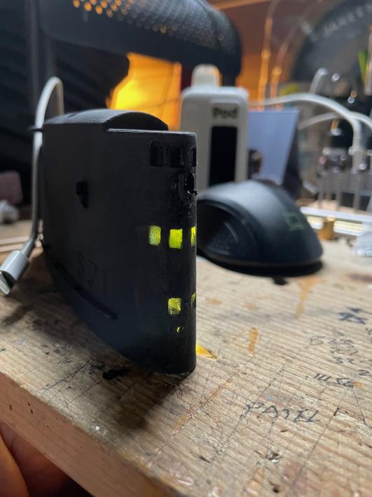

                Epoxied the windows, need to clean up the sail, guess I will have to have light behind them along with navigation lights, Click image for larger version
ID:	186188 Click image for larger version

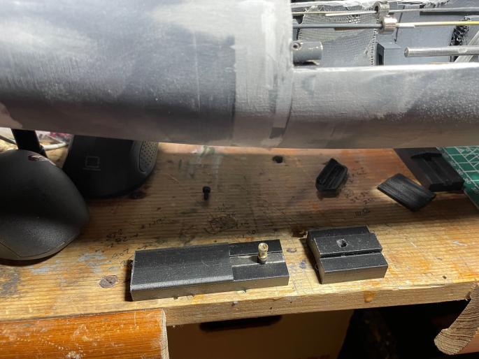

                  Designing upper hull hold down to tail Click image for larger version

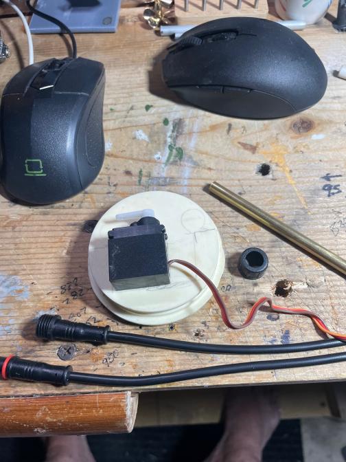

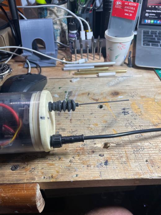

                    Moving on to installing forward servo and electrical wires for lights Click image for larger version

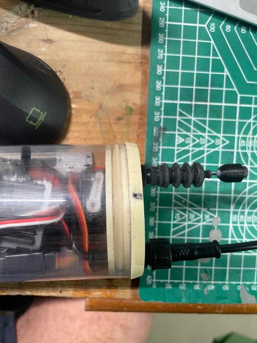

                      " Click image for larger version
ID:	186254 Done with this guy"

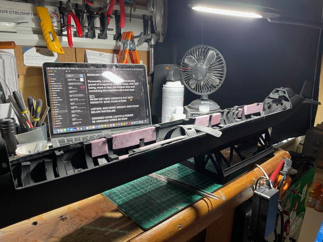

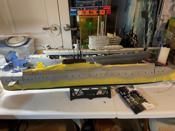

                          Trimming the boat Click image for larger version

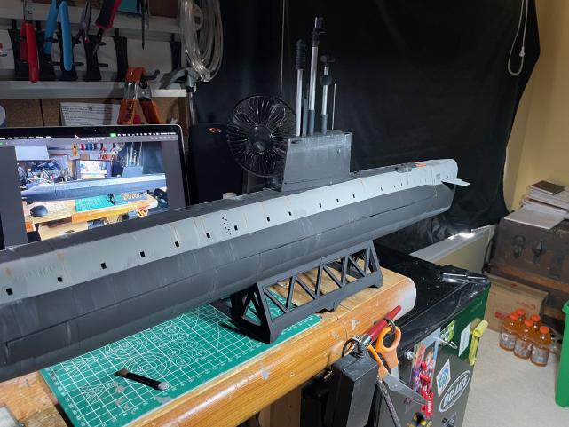

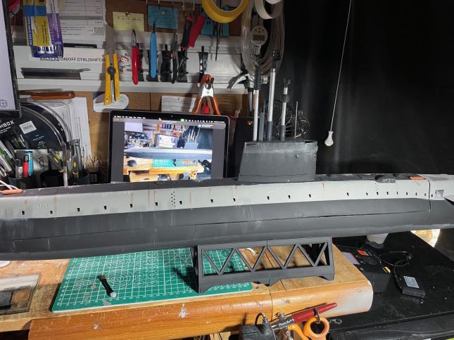

                          • biggsgolf
                            • Jan 2020
                            • 1036

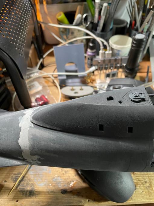

                            So, it took days to get her trimmed, at one point I ripped most of the weights and foam out. She is now trimmed for fresh water, will change a bit in saltwater. I primed her again. Due to sizing the files down so much and the layer orientation she is splintering on the outside, I covered the inside with fiberglass, we'll see.... Click image for larger version

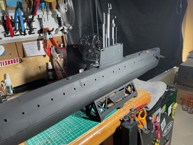

                              5:1 Light Sea Grey to Sea Grey Click image for larger version

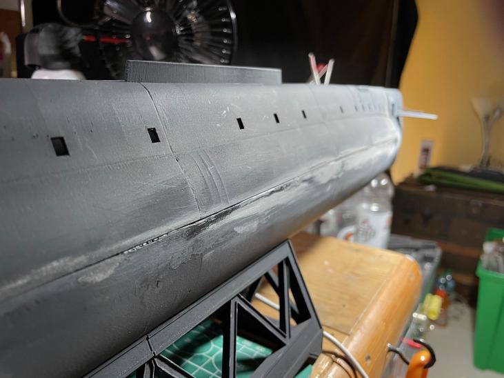

                                A bit of weathering Click image for larger version
