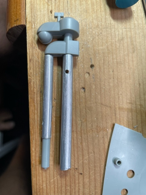

    • biggsgolf
      • Jan 2020
      • 1036
      #107
      Air tube goes in here, the hole is the vent Click image for larger version

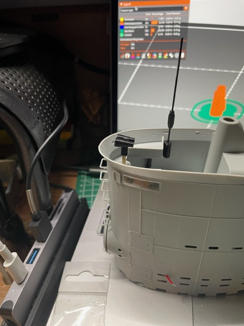

          #109
          Redesigned Antennas, brass rods to be black

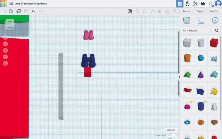

                  #113
                  I only run my Subs in my pool so I am designing a Rudder Extension for agility
ID:	175468 Click image for larger version
Name:	Image 10-29-23 at 9.05 AM.jpg
ID:	175469 Click image for larger version

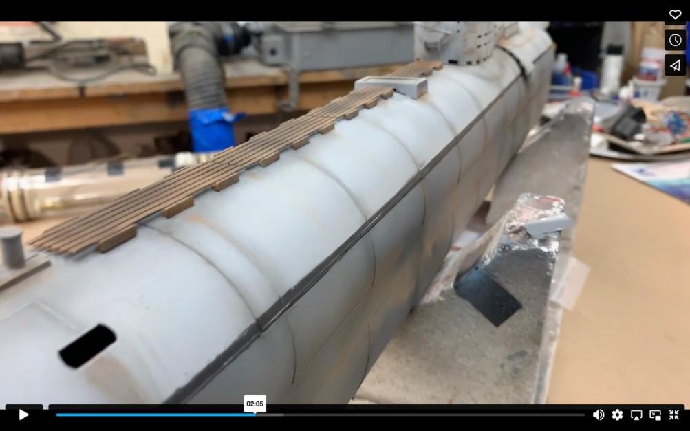

                        #116
                        To vent the free-flooding hull and reduce displacement of the above waterline structures.
                        David, are the "planks" (what are they called Sir?) steel or wood? What does a white stripe signify? Yellow is training? Click image for larger version  Name:	Image 9-28-23 at 3.00 PM.jpg Views:	0 Size:	56.5 KB ID:	175516
                        • DrSchmidt
                          • Apr 2014
                          • 1393
                          #117
                          Actually the wooden deck was only used in the habor. Underway they were removed....
                          • biggsgolf
                            • Jan 2020
                            • 1036
                            #118
                            David, are the "planks" (what are they called Sir?) steel or wood? Not sure how to paint & weather them? In your photos looks like you painted grey and added rust? What does a white stripe signify? Yellow is training? Anybody know how I should proceed?
                              • 13976
                              #119
                              Wood. Tan colored, with variations of tan to signify different sources of planking.
                              White status bands on the sail appears to be a research mistake on the part of Bronco. I have it on good authority (thanks, Manfred), that the sail vertical and horizontal markigns, which were yellow, signified a boat undergoing work-up for eventual operational use. Using that logic -- the boat would not sortie far from base, and not for extended periods of time -- I assumed the portable decking would likely have remained in place on some of the training units. Just a guess -- I so wanted that decking in place to hide the many vent holes I drilled atop the models hull to vent the boat as it transitioned from submerged to surface trim and back.
                              • biggsgolf
                                • Jan 2020
                                • 1036
                                #120
                                Thanks David, I also have vent holes under where they go!
