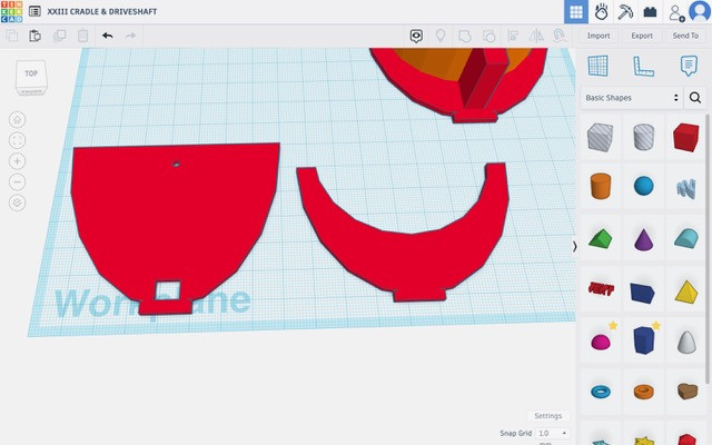

    Rough Fabrication of eventual Thrust Bearing Click image for larger version

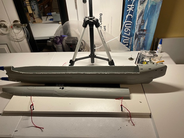

      Starboard cut done, went very well, used hand saw to cut where strings are located Click image for larger version

        You taking notes, Casey????!!!!!
        • biggsgolf
          • Jan 2020
          • 1036
          #34
          lol@David! In hindsight I maybe should have left the uncut areas until cutting the Starboard side
            #35
            Eeeeeuuuup.
            Insert three plastic shims of kerf thickness, tack glue in place, and proceed with cutting the other side.
            Idiot!

              Success! Thankyou David for passing on how to this! Click image for larger version

                OK!
                Hard parts done. Now. Finish that sucker!

                  #38
                  Eeeeeuuuup.
                  Idiot!
                  LOL!, basically what I did

                    I want to remind everyone following this as David said; DO NOT MOVE THE CUTTING WHEEL AGAINST ITS ROTATION!!!!!!!!!

                      Next I will clean up the cut lines. David, any advice on cleaning up the Kerf would be appreciated!

                        Now that the Diamond Wheel worked flawlessly, I will link them. Remember to not push the wheel too far in, keep an eye on that, the center of the wheel is thicker then the cutting wheel which is only .60 MM thick.

                          Most of the Kerf fragments break away using my thumbnail
                            I am at that.
                              #44
                              Success! Thankyou David for passing on how to this! Click image for larger version  Name:	IMG_1585.jpg Views:	9 Size:	90.1 KB ID:	174897
                              Excellent. How long did it take?

                                Cutting time 15 minutes per side
