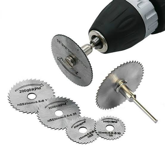

                Will a mini circular saw give a cleaner cut than a diamond wheel? Click image for larger version
                • biggsgolf
                  • Jan 2020
                  • 1036
                  I am doing what David does by using Diamond wheels, seems to me that a thinnest blade will be best and large teeth will jerk the model and rotary around causing major issues, just my opinion, mine are .60 MM

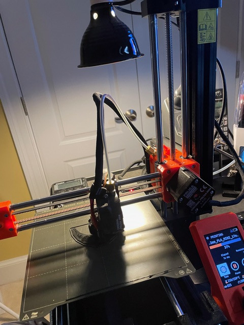

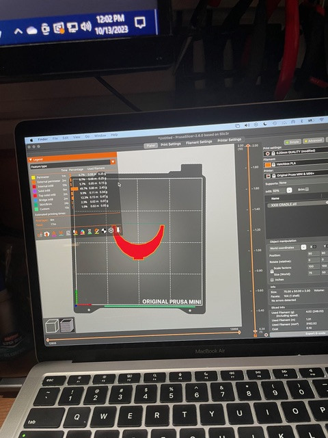

                                Rough fabricating the WTC Cradles Click image for larger version
