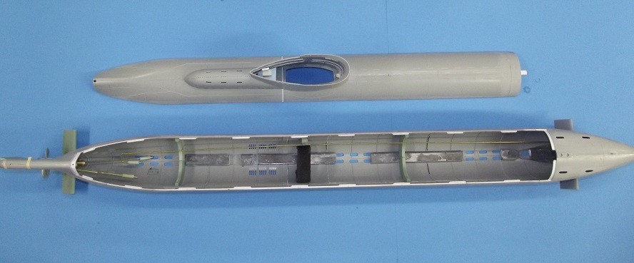

                    David why did you cut an opening below the sail? Click image for larger version
                    Could be for the camera system he put in it.

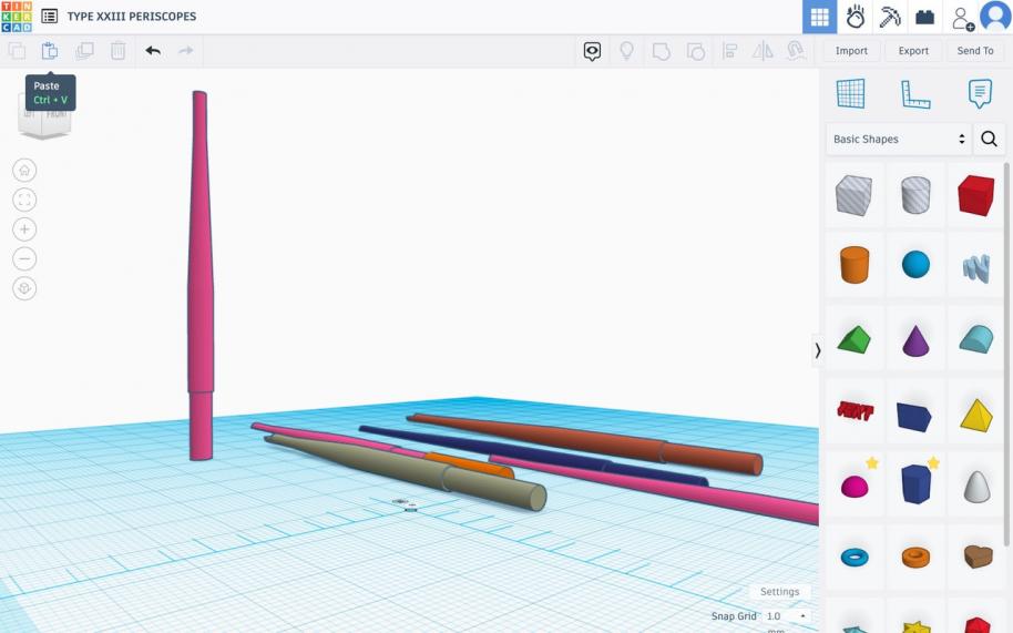

                      Creating Periscope which will house my antenna and be attached to hollow Aluminum TubeClick image for larger version  Name:	Image 10-26-23 at 5.09 PM.jpg Views:	0 Size:	49.8 KB ID:	175332
                          To vent the free-flooding hull and reduce displacement of the above waterline structures.

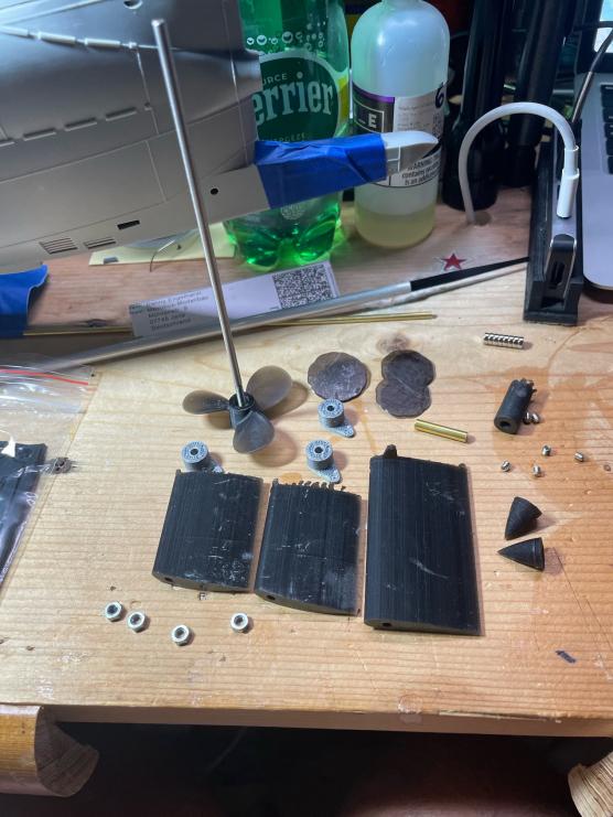

                            Fittings etc. from Danny arrived today! Not sure how many I will use yet Click image for larger version
