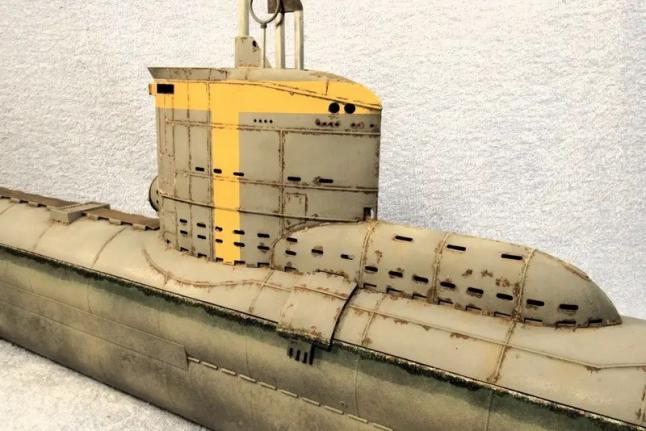

        What's happening here? Is this before the black wash?
        Nope.
        Two steps removed from when the wash was sprayed on. After scrubbing the wash into every nook and corner.
        I then achieve a very subtle streaking effect with a soft brush following the gravity line. That's what's being represented in this picture.
        Oil paint dries very slowly, so no rush. The drying is accelerated with a heat gun (careful, things can go terribly wrong here) and a few days of sitting by its lonesome. At that point I get into the rusting agent application.

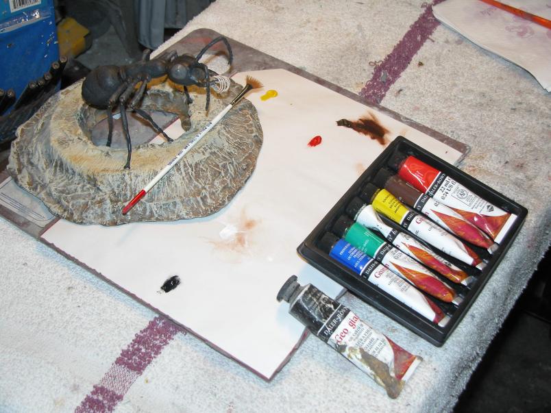

          What are these mediums and how are they used?
          Click image for larger version  Name:	Image 4.jpg Views:	0 Size:	49.8 KB ID:	176104
          Get this stuff. 1 pt Modern Masters ME208 Iron Metal Effects Reactive Metallic Paint - Walmart.com​
          Plenty of how-to tutorials on YouTube.

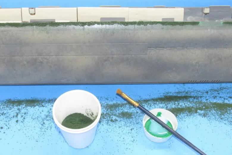

                      what medium(s) did you use to attain the beige/brown scum effect? Do you also have a photo? Thanks
                      Do I have a photo?
                      Do.
                      I.
                      Have.
                      A.
                      Photo????
                      You're kidding!?... right?
                      The adhesive is water soluble (but becomes waterproof once dry) 'artist medium', used to prepare canvas for paint work. Another visit to woke-land (art supply store) will net you this stuff. The green 'Turf' is sold wherever they sell model train stuff.

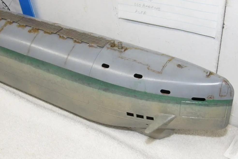

                        hahahahah, I know you got pics! What did you spray the lower hull below the scum line for the XXIII weathered look? Click image for larger version
                          #177
                          hahahahah, I know you got pics! What did you spray the lower hull below the scum line for the XXIII weathered look? Click image for larger version  Name:	Image 87.jpg Views:	0 Size:	48.0 KB ID:	176133
                          2K polyurethane dark gray below waterline followed by rag and texture-sponge stippling with lighter shades of gray. Some tooth-paste masking between sponge applications to mix things up a bit.
                              David, what paint and color green is the waterline?
