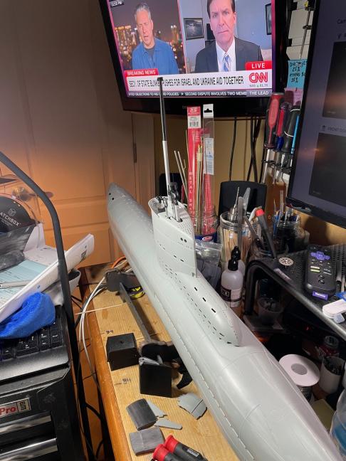

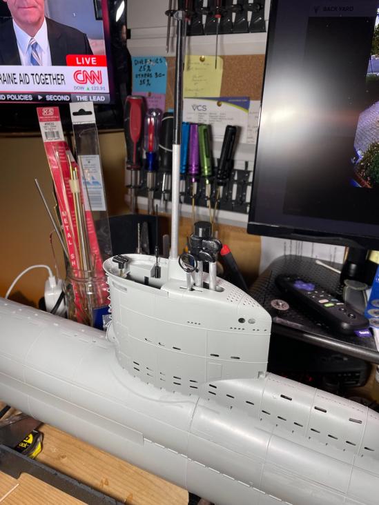

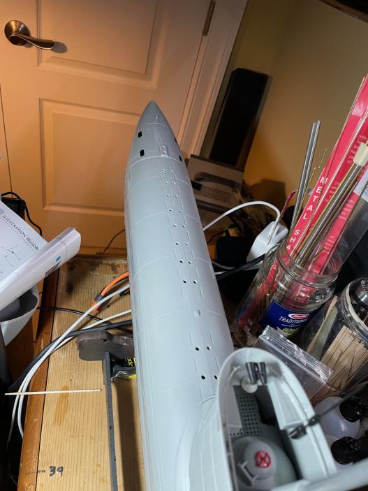

ID:	175536 More progress, also created air escape holes
    Click image for larger version  Name:	IMG_1839.jpg Views:	0 Size:	58.5 KB ID:	175534 Click image for larger version  Name:	IMG_1840.jpg Views:	0 Size:	56.1 KB ID:	175535

      Well!... now you HAVE TO install that awful looking wooden decking!

          That's why I left it on mine! Hides the man-traps!!!

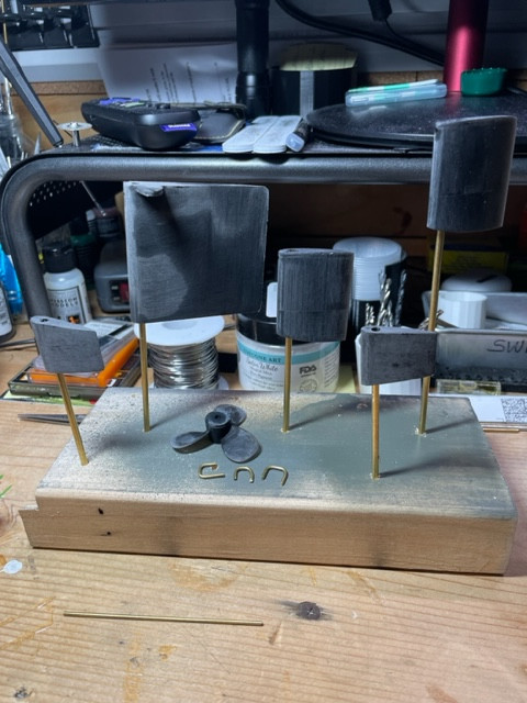

            Forward and Rear Dive Planes and Bearing Driveshaft Printed

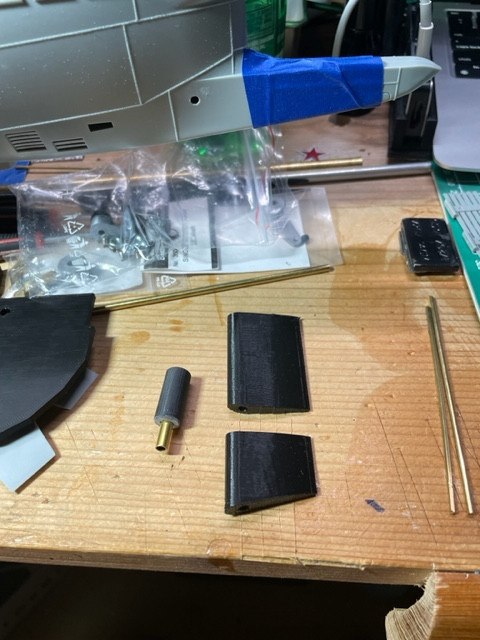

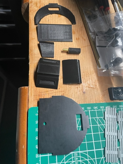

              Parts for conversion

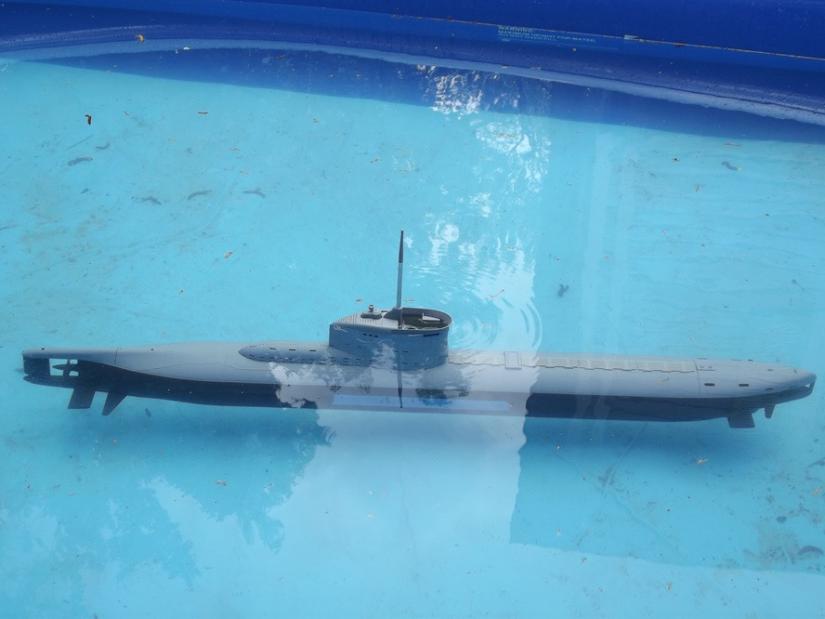

                              On a related note: In a recent video update from Bob, he reported on the poor handling of my Type-23 while he was here for a weekend. During a Sunday fun-run the boat refused to remain stable in pitch while submerged -- in spite of Bob's or my attempts -- it would not stabilize. We were both baffled (and a bit embarrassed -- we're supposed to be the resident experts on this side of the globe, and we both left the lake stymied!). Found the cause of that issue last week: Basic stupidity and failure to fully employ the pre-mission protocols.
                              I failed to hook up the depth-keeping sensor hose. That meant that the pressure transducer was taking its measurement from behind the boats center of rotation, not ahead of it. That meant that the bow planes were pulling the boat in the wrong direction when the bow went up or down. Then, last week the lightbulb went off over my head. So, when Jake and I were at the lake last Sunday I turned off the Type-23's depth-keeping sensor and the boat worked fine underwater -- proving the hypothesis I had worked out previously.
                              From hypothesis to theory in one mornings run. Duh!
                              And this Mirical of science performed by two old, washed-up, former Torpedomen!

                                Awesome!, this Hobby makes us think things out rather then just tossing an assembled boat in the water and navigating it around! Was wondering if you figured it out!
