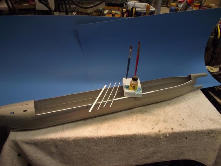

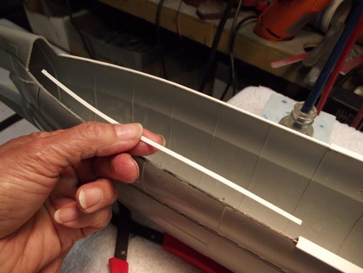

              Next I will clean up the cut lines. David, any advice on cleaning up the Kerf would be appreciated!
              Just run a knife-edge along the side of the cut, which will cut/snap off hanging shards of kerf.
              Replace plastic lost to kerf with. 040" (or thereabouts) strips of styrene.

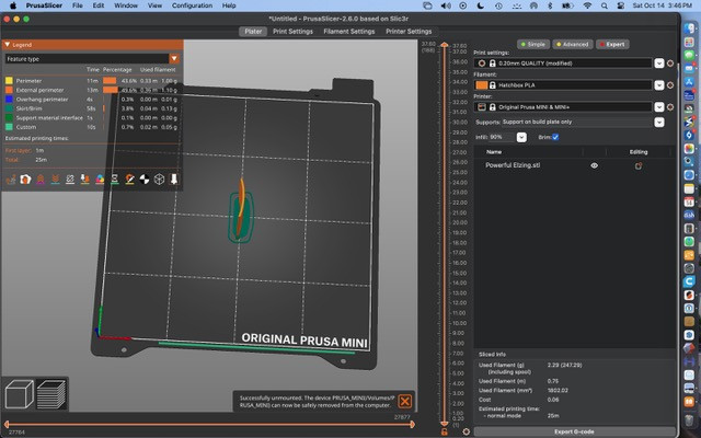

                  Fabricating tabs Click image for larger version

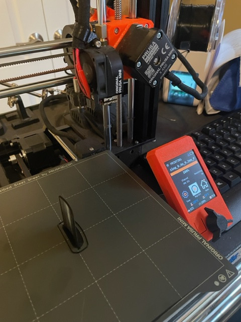

                    #54
                    First test hull tab Click image for larger version

                      #55
                      Tab is rotated 90 Degrees for printing

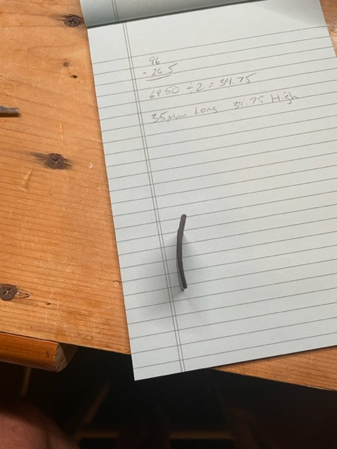

                        #56
ID:	174935Here you can see the curved tab better

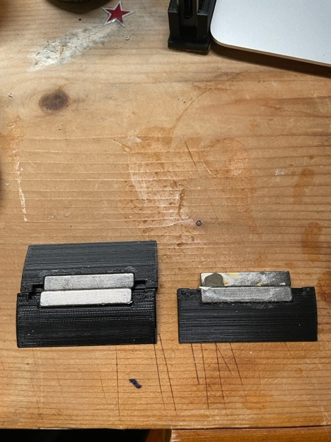

                                Fabricating magnetic hull closure parts Click image for larger version
