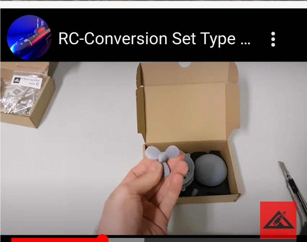

    I am going to use Prop from Danny, did not know Bob still sells them

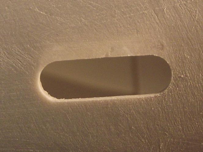

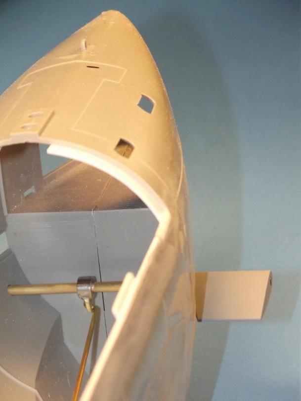

        Would it kill you to simply bend some .030" sheet styrene to the proper radius. Jeeez!
        This complexity warship HAS TO STOP!

        And tighten up those limber holes at the bow. An artifact of kit tool design rendered them too tall.

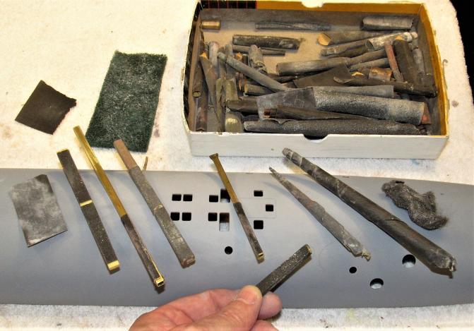

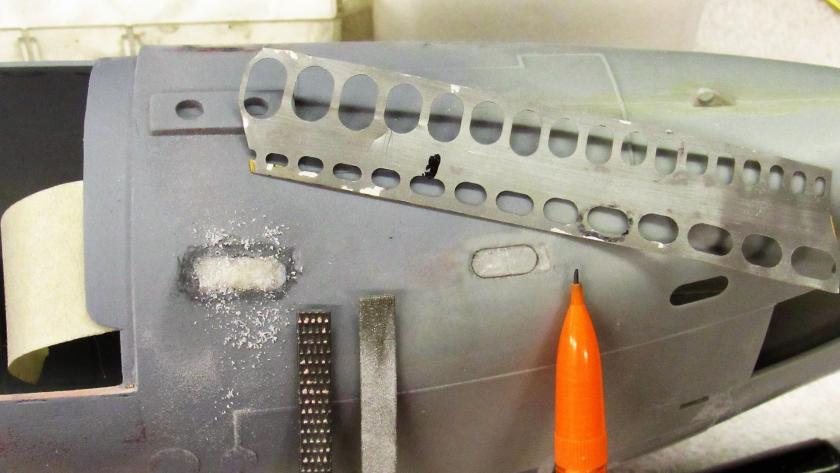

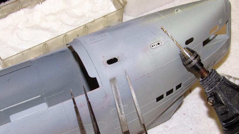

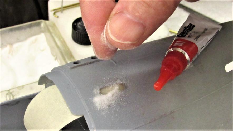

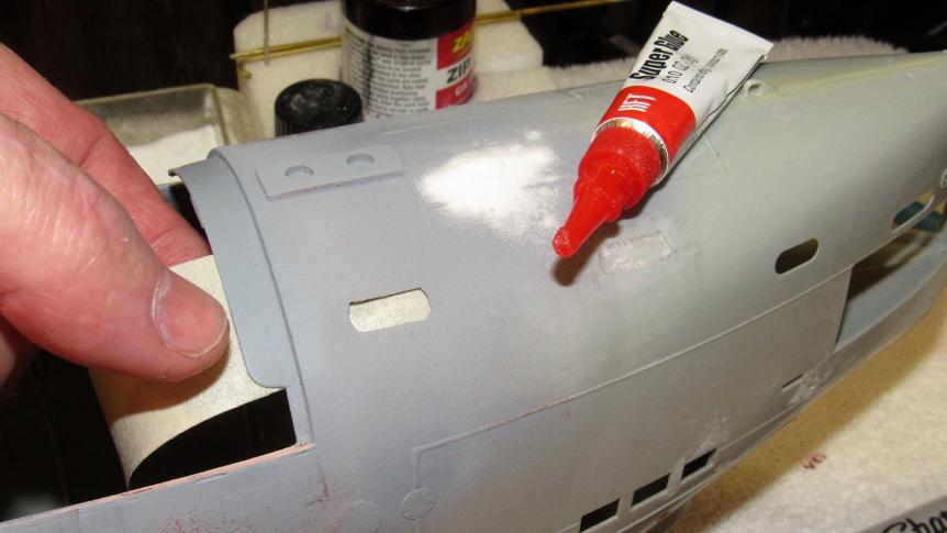

          #64

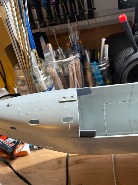

          Thanks David, yes, Styrene just arrived!, lol! This look better? Click image for larger version
          • biggsgolf
            • Jan 2020
            • 1036

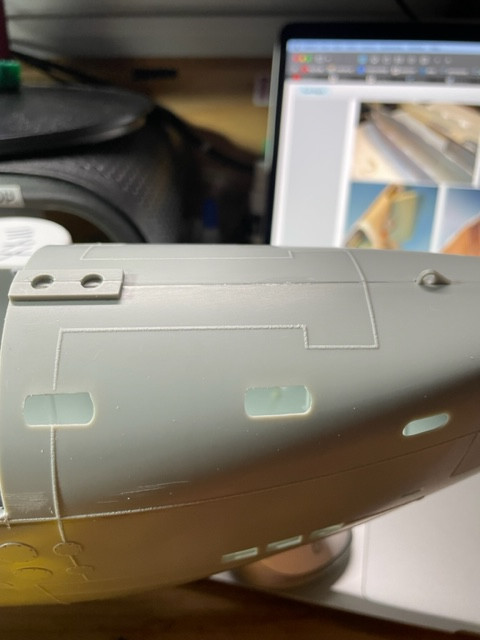

            #65
            When I use Styrene on horizontal cut line how should I lay it down? Can I use Nitro Stan Putty?
              • 13997
              No!
              What the hell were you thinking?

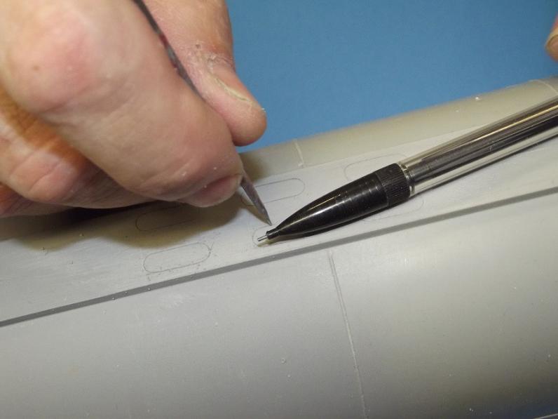

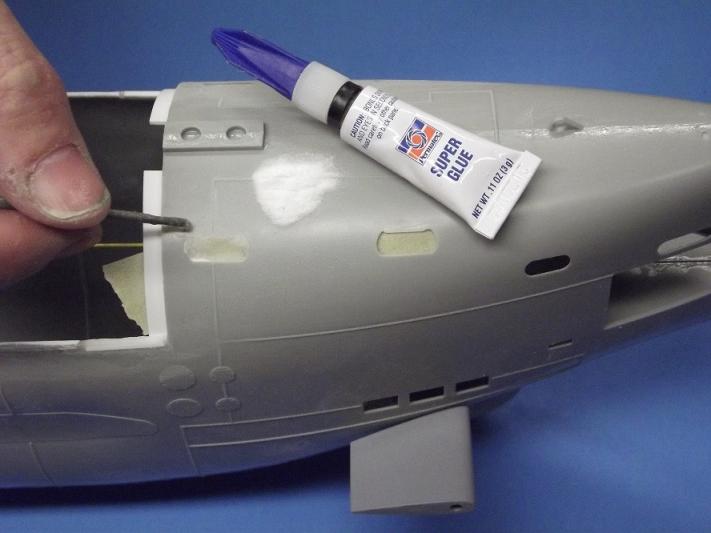

              You thought making the corners within the too tall limber holes at their tops match the form of the corners at the bottom would fix these awful sphincter looking holes???

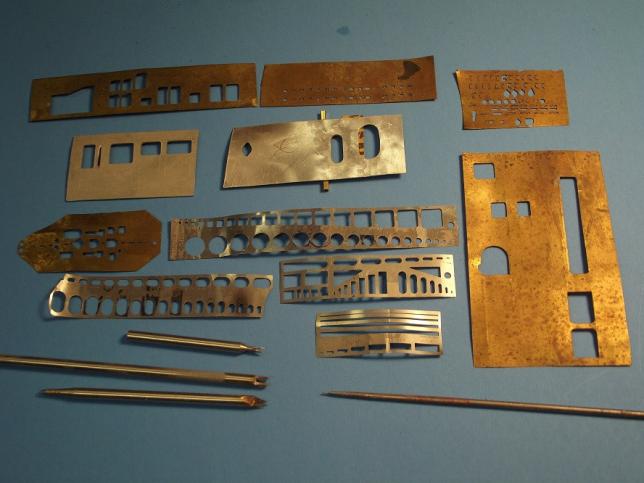

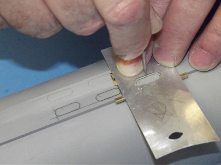

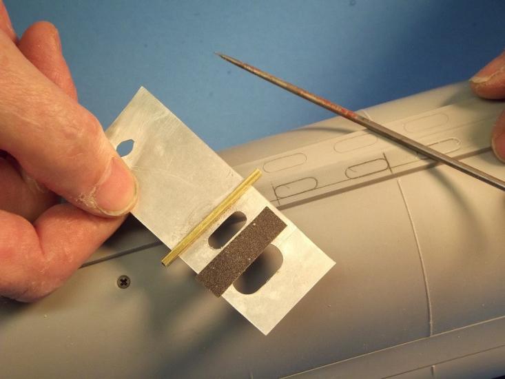

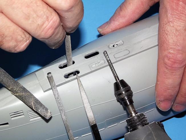

              Damnit!

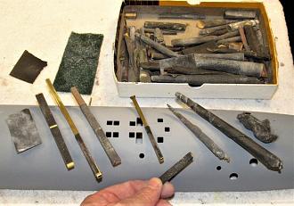

              Rebuild with CA-baking soda grout within the holes top edge to reduce their height. Fine-tune the holes with files, sanding sticks, sandpaper twists of #240 sandpaper and god-knows-what to get them to proper shape.

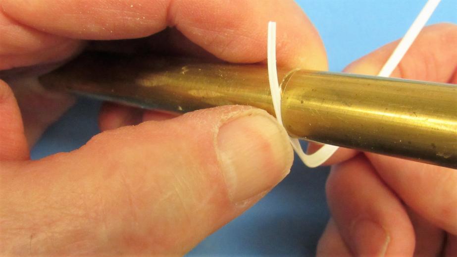

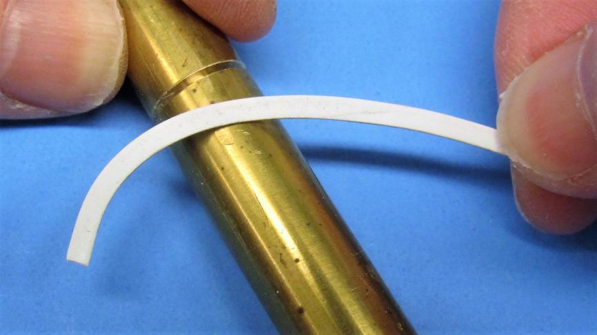

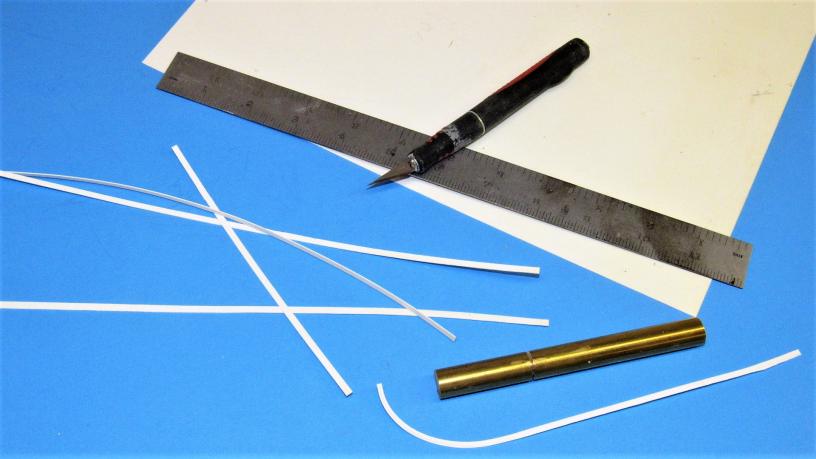

              Oh! Forgot to add these shots to show how to induce a tight radius into strip stock using a pinch-stick. File this trick away for future use. You're welcome!

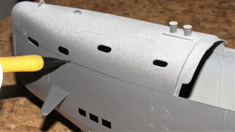

                    #69
                    How small should the limber holes be, L x H?

                        #71
                        Same as the extreme forward limber hole.

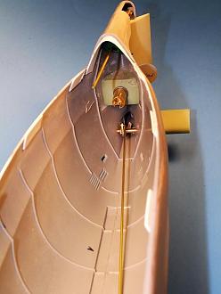

                            Nope. Just simple, no sweat, open flood-drain holes.

                                #75
                                Looks like it's 3D printed in resin. Click image for larger version
