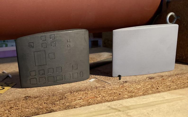

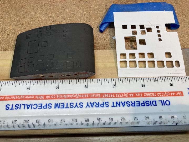

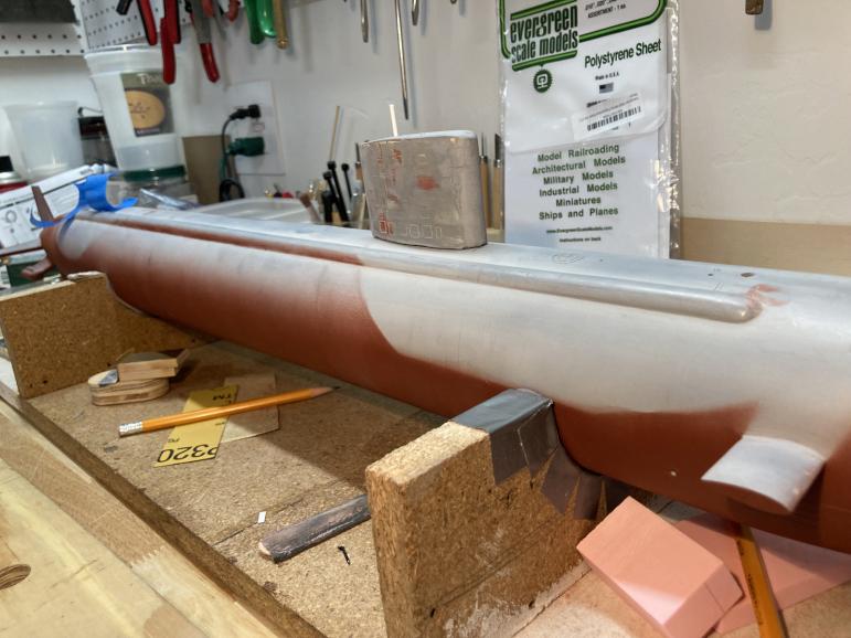

        Scribing the details on the sail is a challenge. In an early post I said that scribing into wood would be difficult and I've proved myself correct. The sail is going to really make the model and I want it to be right so I'm trying a couple ways to see which works best. In the first picture you see the sail sitting in place in grey primer and glazing putty where I've made some corrections. In the next picture on the left I've filled in all the scribing with glazing putty, sprayed it with flat black primer and laid out the detail with pencil. You have to look closely to see that details are not scribed in. Might work but I've formed another sail out of a pink material similar to Renshape to see if it's easier to scribe. With temps over 100 F for last week and this I won't do much, if anything, until it cools down a bit.

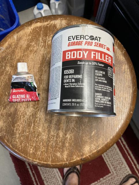

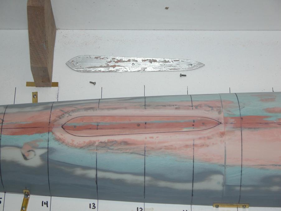

          On the few occasions where I have to scribe/engrave over a wooden substrate I first dig out 3/32" wide channels where the eventual scribing will take place, then back-fill those channels with Bondo. Much easier to scribe Bondo than cantankerous wood with its wavy wood grain patterns, knots, and sap

            Thanks David, I've tried filling in with glazing putty after first scribing but it's tough to make that work with glazing putty. i've also tried several layers of primer without luck. I haven't done scribing in several years so all this is taking more time than I thought it would. I just want to make this my best work. It will take more time than I thought - already been over a year since I started this model.

              Are you using a 2k glazing putty or the air dry stuff? The latter and paint are not rigid enough to provide a good scribe line.
              The putty tends to crumble and give way, and paint is often a bit too soft (unless it's 2k stuff).
              Polyester putty will work well, but you need to ensure the scribe line is entirely within the putty area, if you cross into harder or softer substrates, it'll make the line wander.

                  Thanks for the comments. I've used both of these products and I agree crumbling is a problem with the air dry putty. The Evercoat 2 part does work better on most parts but the sail is where I run into difficulty, probably because there are so many details to scribe at this scale. Anyway, I appreciate all the help and suggestions I get.

                    ... and the tools you use to engrave -- stencils and scribing tips -- make a big difference as to success or failure. And layout with use of a flat surface, machinist's surface gauge, proportional dividers, and 1-2-3 blocks are aids in assuring exacting lofting from two-dimensional drawing to three-dimensional subject.

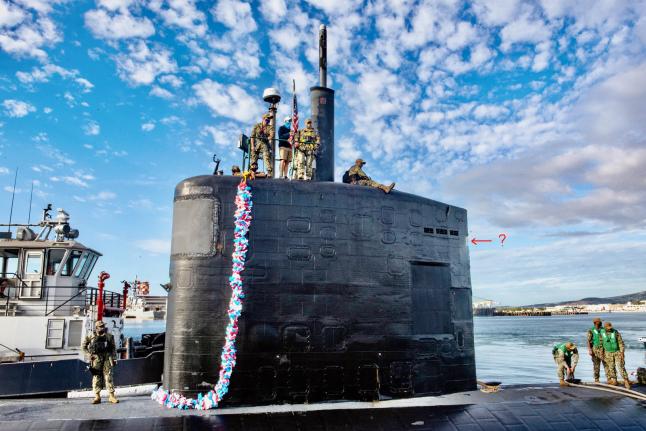

                      You may be already planning for this, so just a reminder that the running lights were raised on 751 & following by a ShipAlt, 'cos the "bow" wave when running at speed on the surface completely obliterated any light projection, thus making the lights verrrrrryyyyyyyy hard to see!! Any recent/current pictures of the forward 1/3 of a 688I sail should show those light positions and outlines. Keep pluggin', this is gonna be a nice model!!!

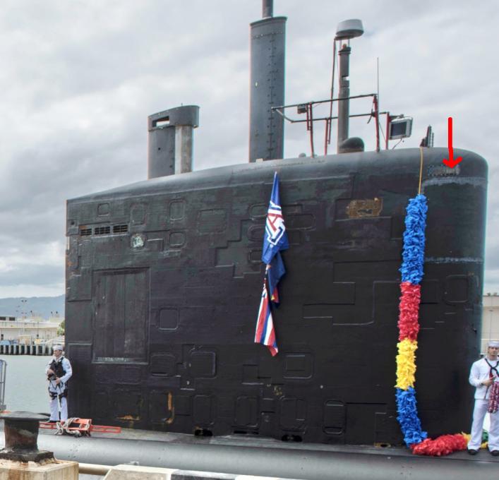

                        Thanks Bill, like this ?

                          Why does the surface of above sail look that funky? As if plating got lost....

                            That's the beastie! The light cover is a sheet of 5/16" thick Lexan screwed in place with a butt-ton of stainless flat-head screws. They are constantly being replaced when those vessels come in for refits.
                            Herr Doktor- The chunks you see missing are anechoic tiles that have torn off from water flow. Has been a problem for the 688 class since they started carrying those tiles. All of these coatings, for all nations using such, take a terrible beating in their natural environment!
