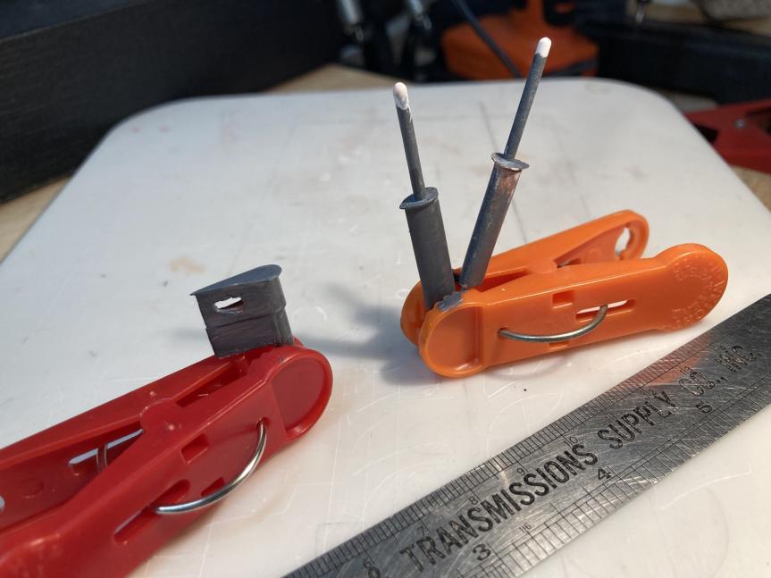

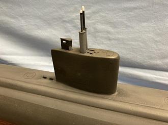

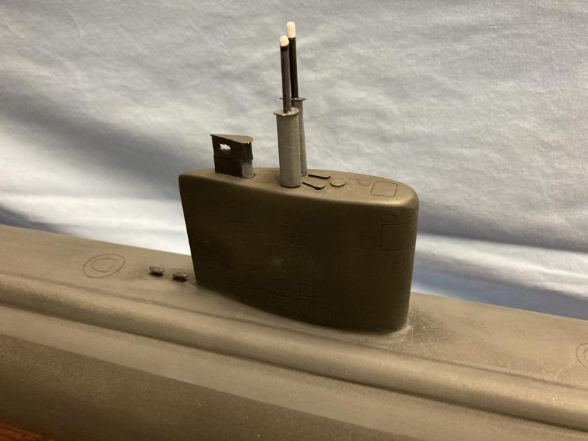

    Temperature in the garage this morning is 48F, been low for weeks and too cold to airbrush. Worked on masts for awhile but not much else. Once it warms up I'll repaint the hull and install masts, retractable cleats and other details.

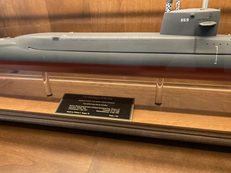

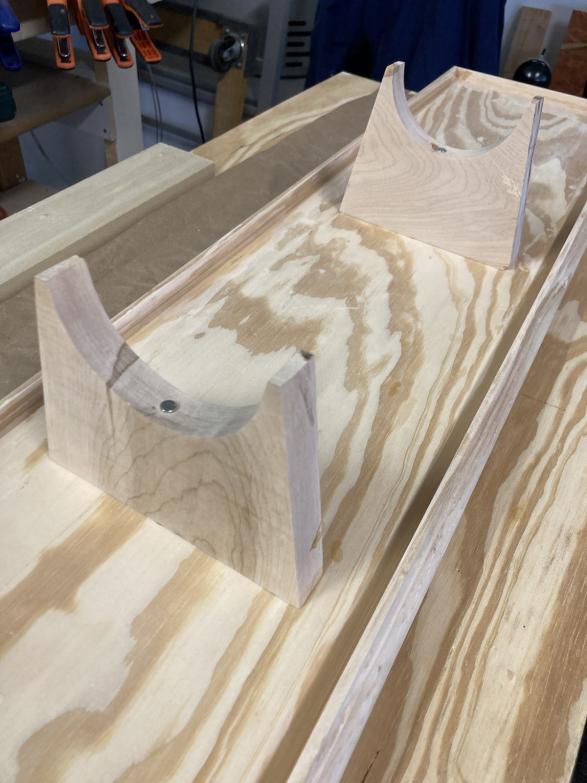

      Tucson is still a work in progress. While waiting for warmer weather for a final coat of paint I decided to work on the display base. My original plan was to build it the same way I did my Will Rogers model several years ago.

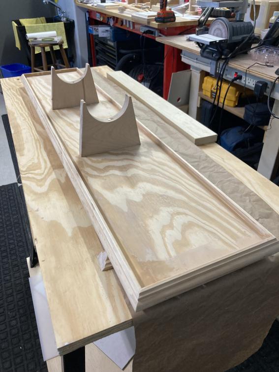

      When I found out the price of acrylic rod and walnut I changed my mind and will go with wood I have laying around.

      I'll use molding on the perimeter of the base and finish it off with a dark wood stain. Stay tuned.

        Submarine Base.

        Rare Earth magnets in cradle for securing Tucson - mooring lines not required.

          Don't forget to put some felt or flocking in those saddles, the wood end-grain will tear your paint to shreds!

            Very nice looking stand for that Tucson!

              Great tip about using felt on the saddles, thanks. Just trying to make it look like I know what I'm doing so I appreciate all comments.

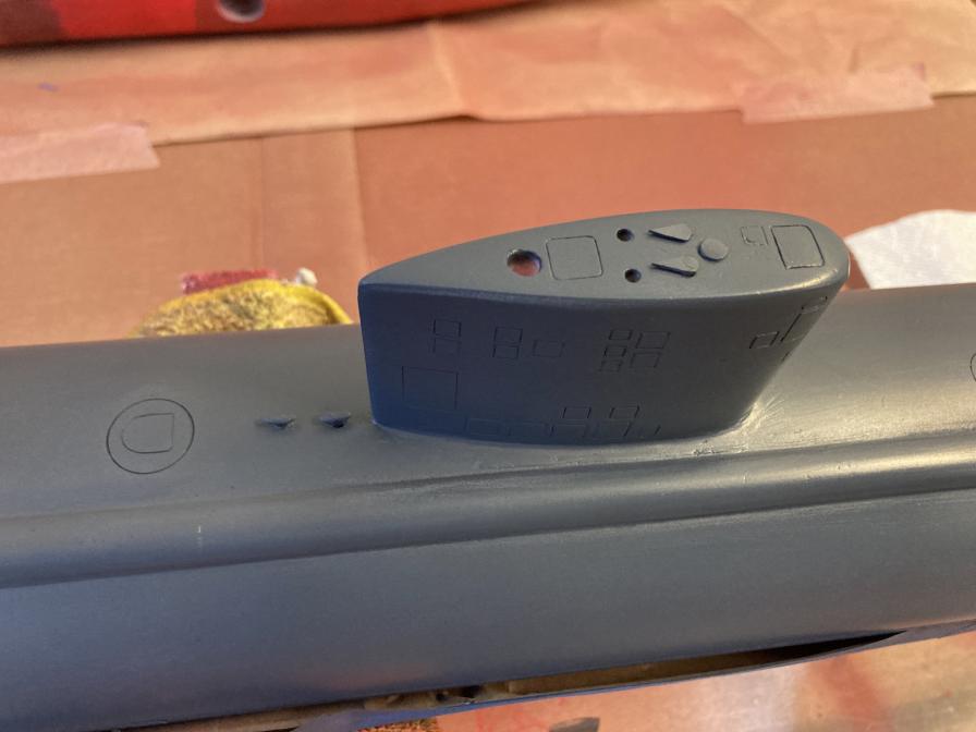

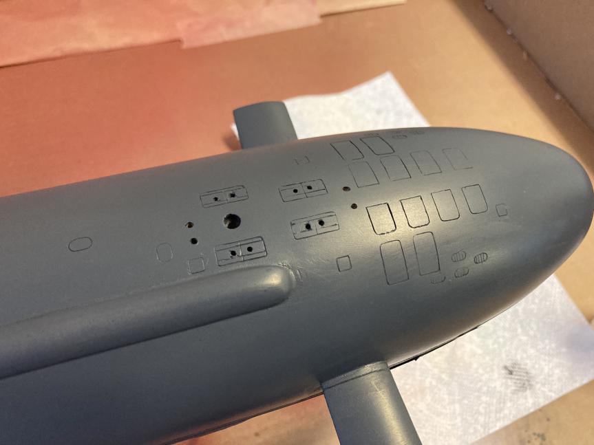

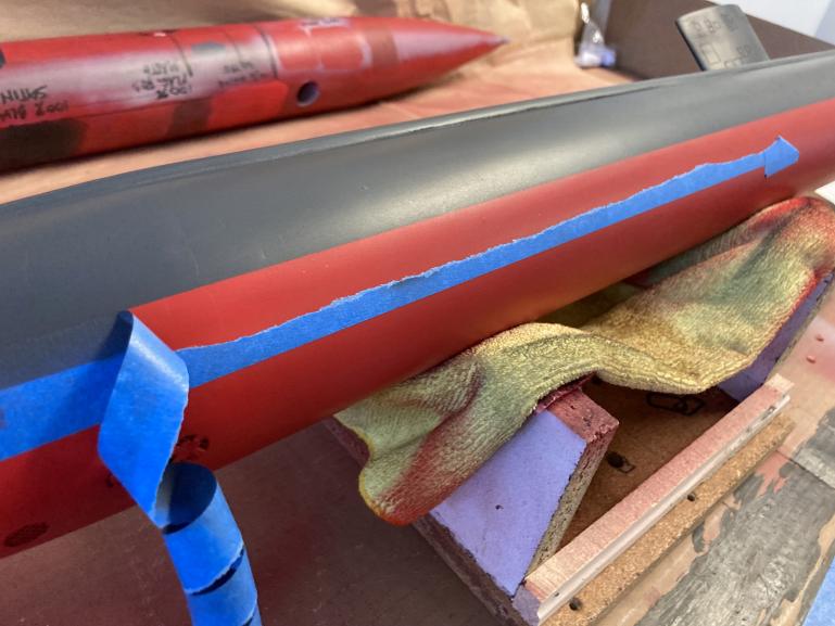

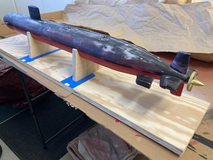

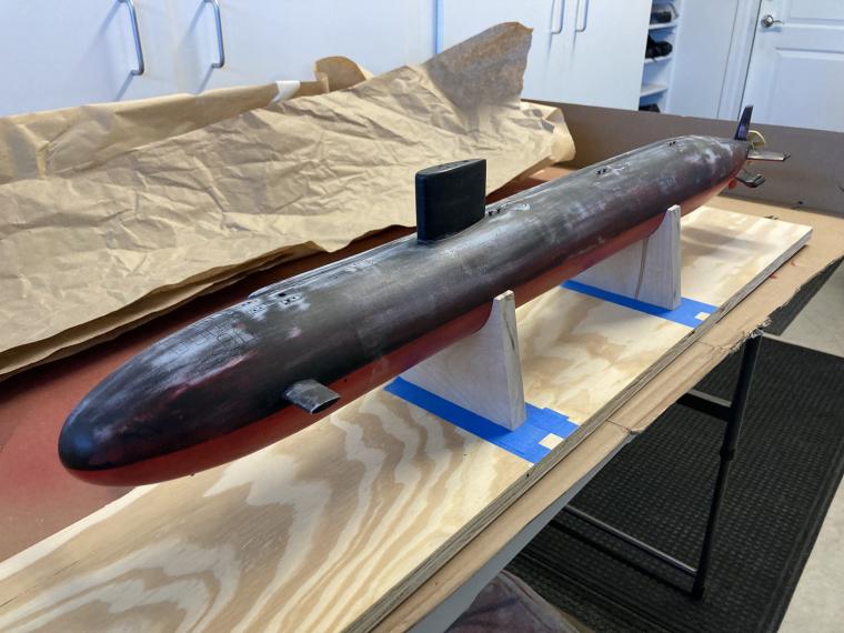

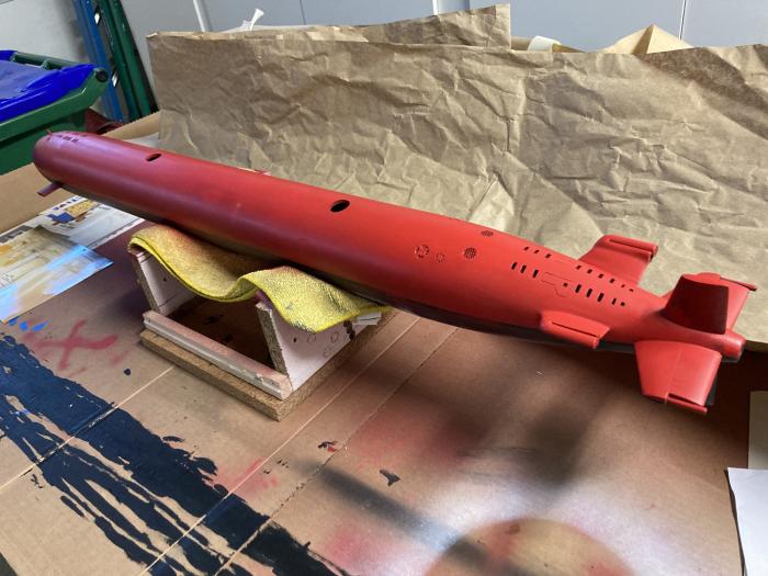

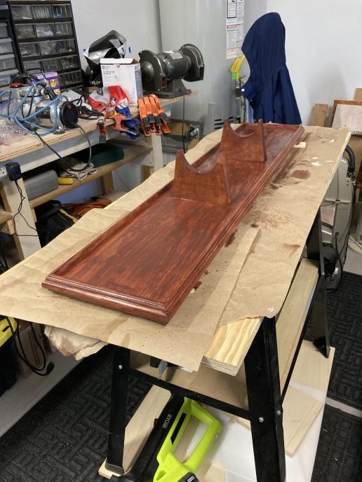

                The sub base is almost ready, just need to add some felt or other material as suggested previously. Weather here has been warm enough to airbrush so after playing with different ideas of color I did both underside and topside. Still have some touchup where blue masking tape had too much tack (even after de-tacking on my shirt) but I'm pleased with the look. Next will come antennas, snorkel, retractable cleats and capstan. At some point I will need an acrylic display case and appropriate nameplate.

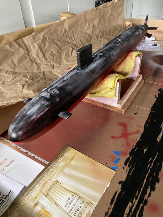

                    Still not having good luck with red acrylic on lower hill. What is your experience with airbrushing acrylic over rattle can grey primer?

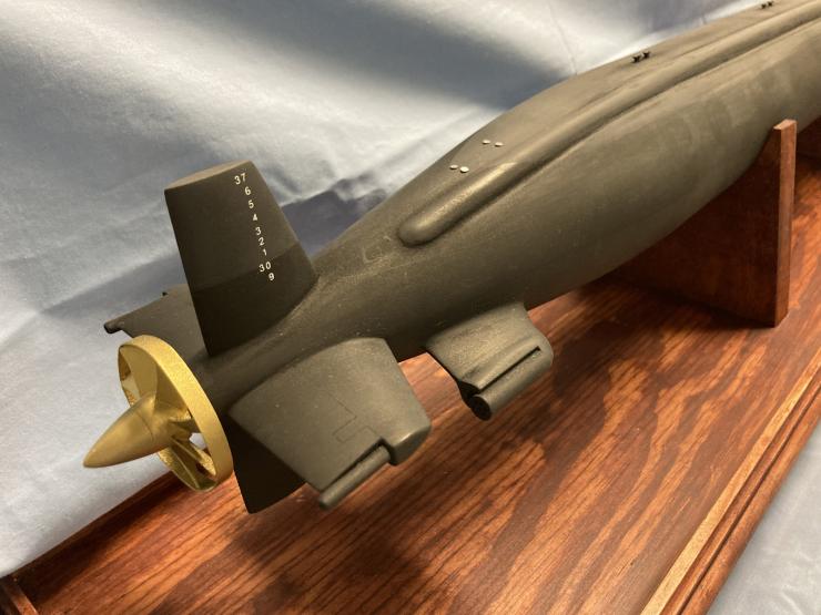

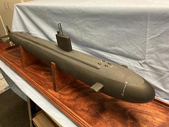

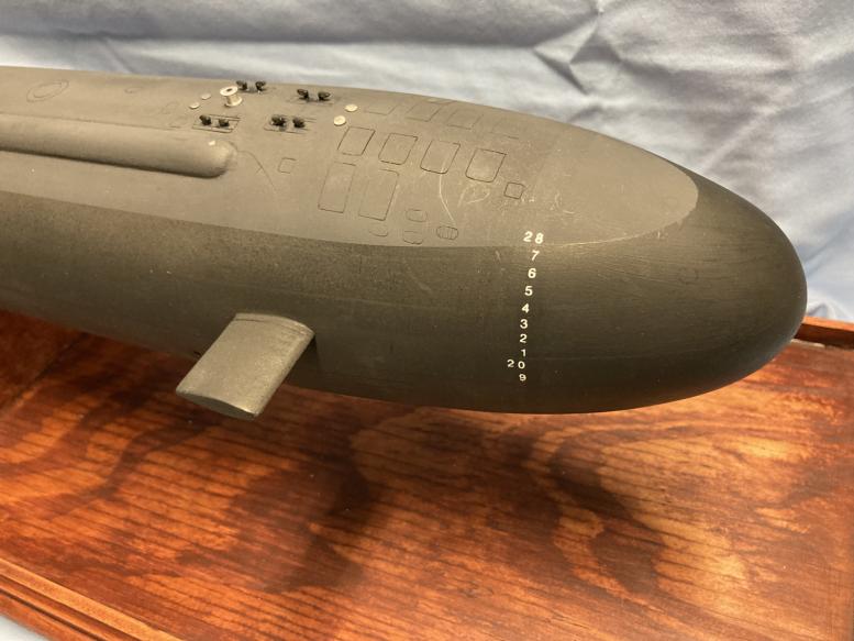

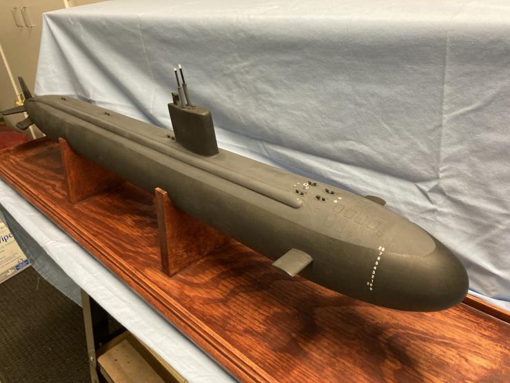

                      Funny thing happened while trying work out paint problems. I found this on the web and so I changed my plan on the paint scheme. The model is now finished, just waiting the nameplate.

                          Beautiful model, awesome work; however the paint scheme is not correct. The photo in the floating drydock in Pearl Harbor is misleading as it's from the front, and doesn't show the side of the boat. The sonar dome all the way around is black, and it's covered in rubber. behind this topside is F-150-series (topcoat black), which goes down to within a foot of the anticipated waterline. The sail is supposed to be another lighter color of black, also a F-150-series, but as I recall it was lighter (I think it was boot black), but navy supply system/ submarine deck crews as they are most time you saw them painted topcoat black. What you don't often see, and is really apparent when a sub gets freshly painted until it hits the water is that there's anti-fouling black(this is bluish-black much in contrast to topcoat black) from about a foot above the anticipated waterline down to where the anti-fouling red starts, basically the lower half of the submarine from the stern planes/ tube forward to the back edge of the sonar dome. After a while in the water, the anti-fouling black just looks like a fouled portion of the topside black, vice a fouled version of anti-fouling red, so it's really what look that you're going after. I saw Tucson when it was still being built inside the MOF in new construction when I went to the commissioning ceremony of the Charlotte. Saw it on the patio when they wheeled it out, on Pier 6 behind us when it was being outfitted, gave a brief to the Weapons Officer of Security measures he'll receive or need to anticipate going through the Panama Canal when they switched coasts, and did an inspection on her when she was in Pearl a couple of years later. Tuscon, Greenville, and Cheyenne also received their dihedrals 'before' they were commissioned during new construction vice all the previous hulls that got them during Post Shipyard Availability (PSA) or after. It was the second Flight-6, 688-I boat having MOD-25 propulsion improvement. It also was a victim of Greenpeace when they snuck into the shipyard, and started using hammers on the VLS hatch seats before some workers questioned who they were. No serious damage was done, except to security. Toledo was the boat before it and around the same time it also was a Greenpeace victim when they came into the shipyard via a boat. I think they only spread paint that time. We were across the pier and got spared. Probably because we had full security at the time. Sunday morning, not enough coffee.
