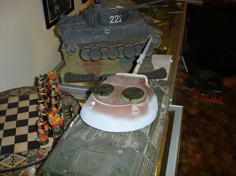

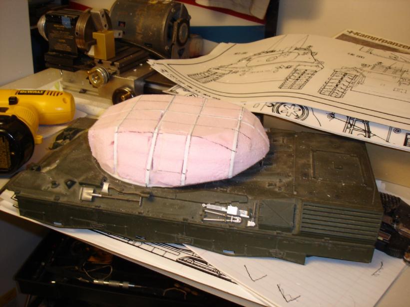

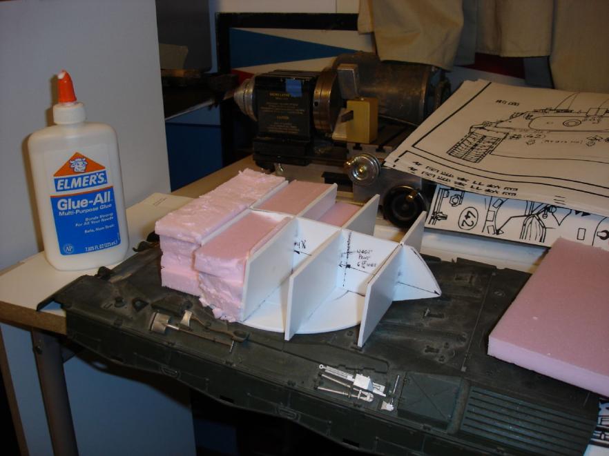

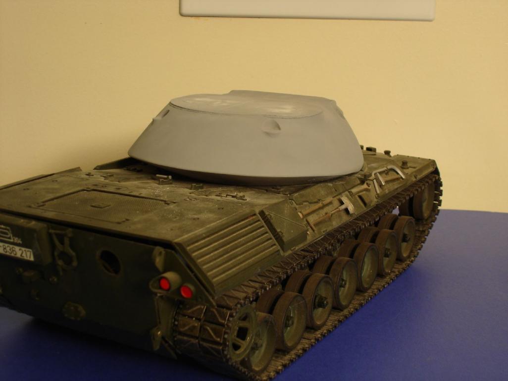

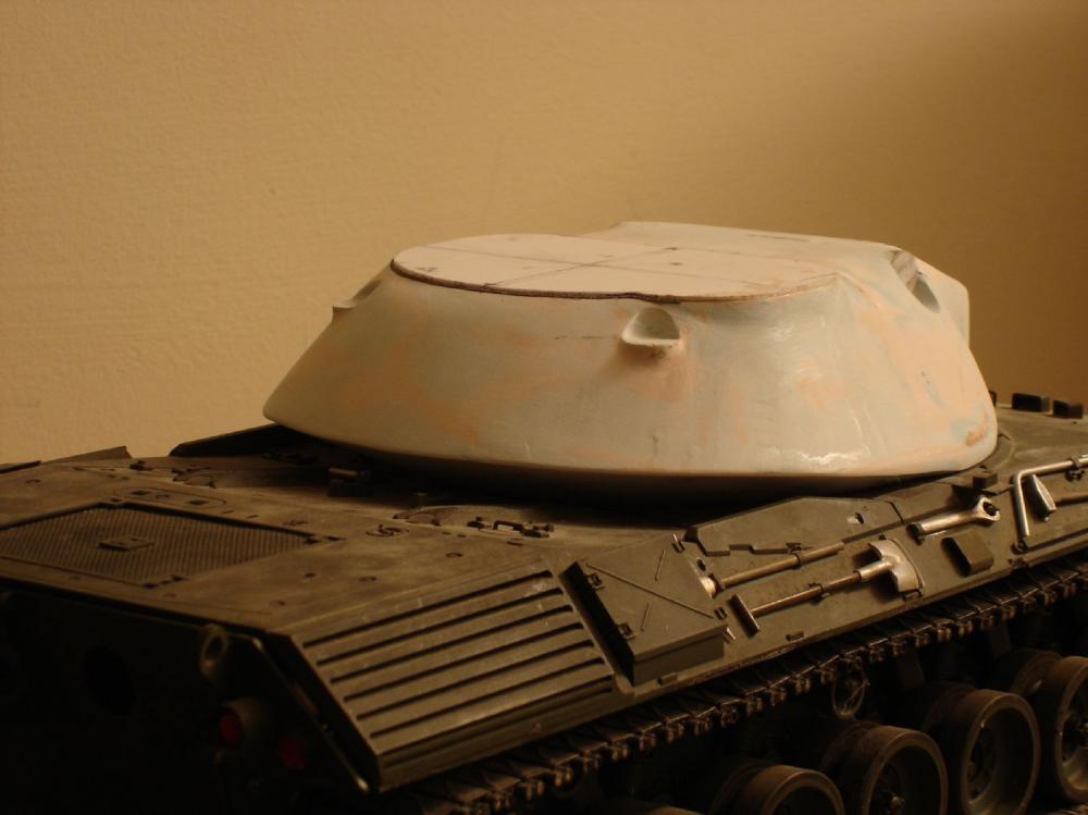

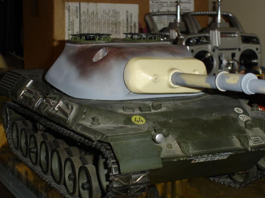

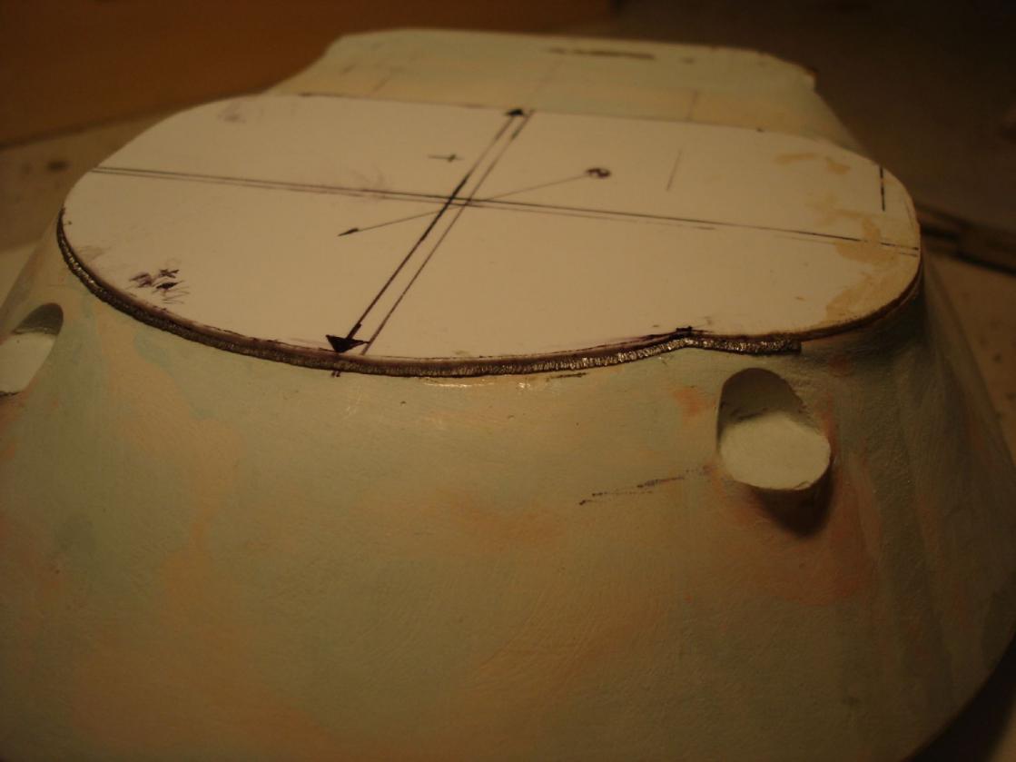

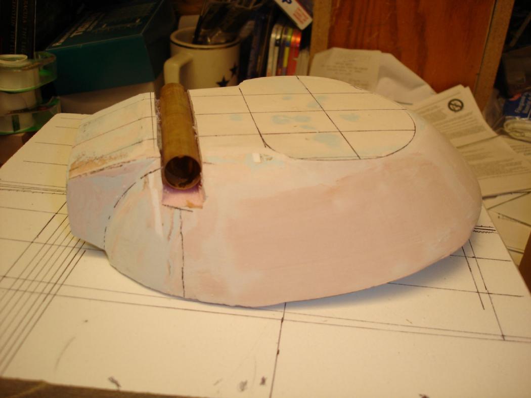

        ***WARNING-NOT A SUB*** You have a few choices once you've made that master, which is looking awesome. I love working in foam, as it's so fast to work up a form. I use autobody fillers, which partially dissolves your master while you go, but it builds back pretty fast, as enough of it is left to move forward. I use styrene as rough templates, then keep drawing grid work on it and fill and sand to shape. Dave talked me into casting this work, and roto-cast some in Alumulite, then we laid up one in GRP which I used that one. Did the mantlet the same way, but just cast that piece conventionally. The gun was machined in three parts, then cast. Sorry, I don't have photos of the casting process. This work actually made it into some Cabal reports back in '06-07. The ones on here only go back to about 2008. Your sail work looks great, that's a showcase by itself for detail.
          • 13937
          This is just some of the work Dave and I got into to produce a stout, yet light weight gun barrel part for his tracked bang-bang machine.

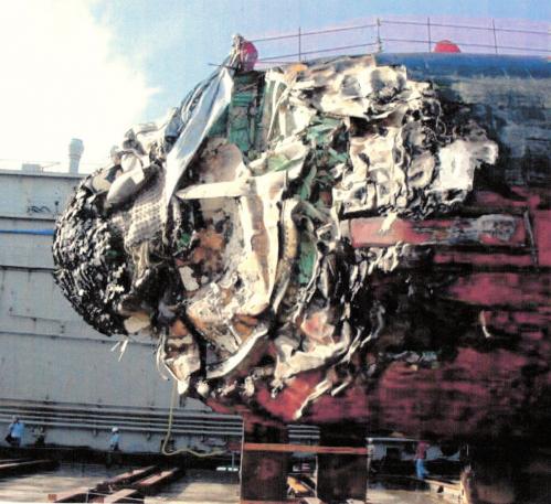

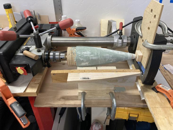

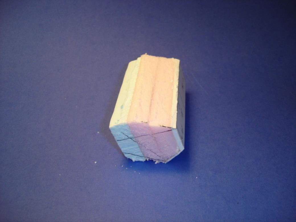

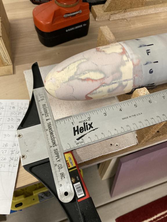

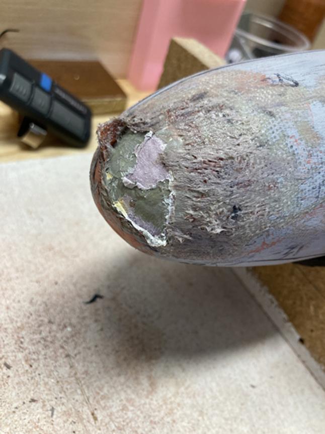

            After several months I'm back at work on the Tucson model. Recall the problems I had with the epoxy that didn't cure. In addition the exothermic reaction of the epoxy melted some of the pink foam and made an even worse mess. It reminded me of the picture below.
ID:	166666Click image for larger version
Name:	BOW DAMAGE.jpg

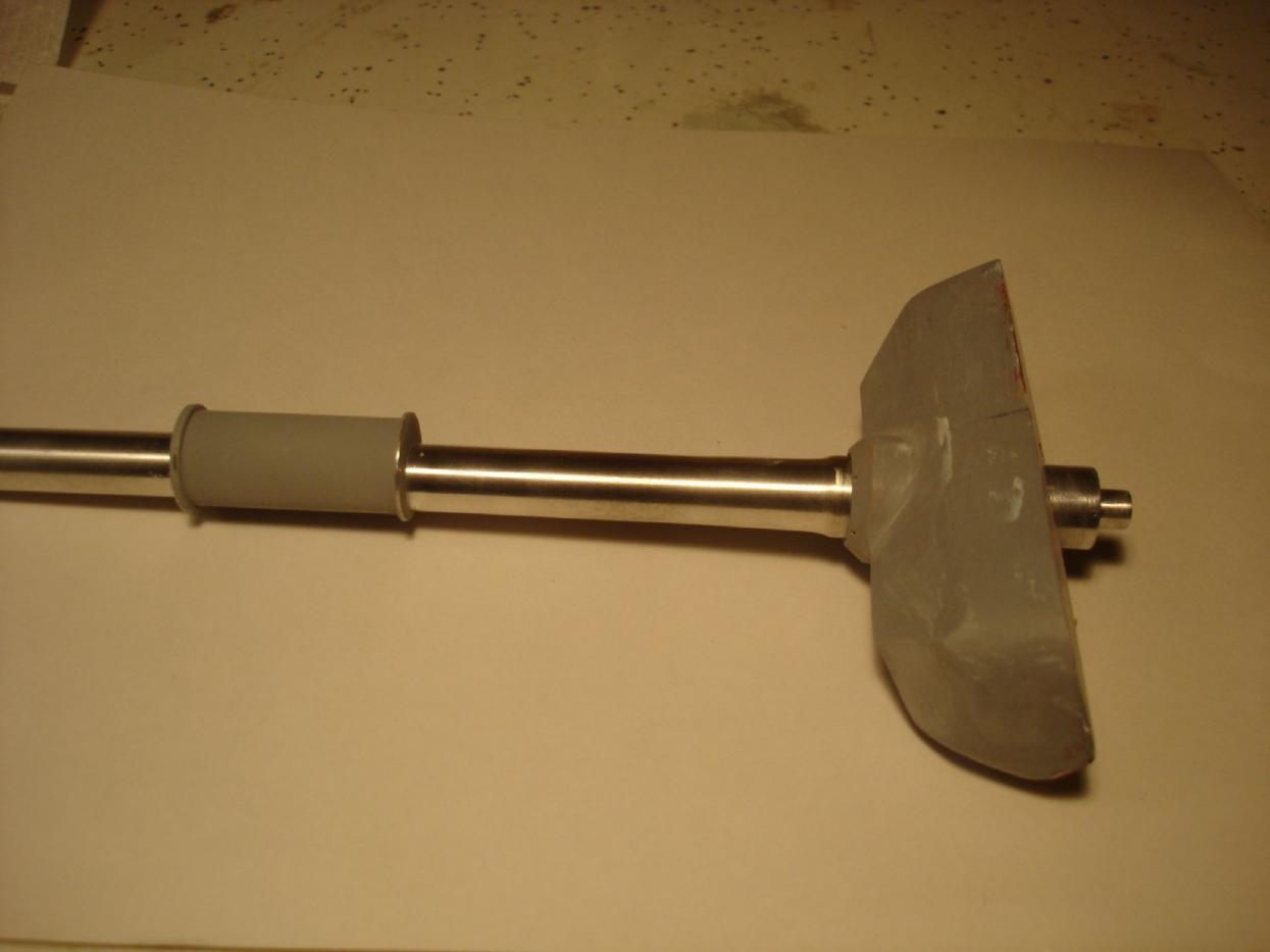

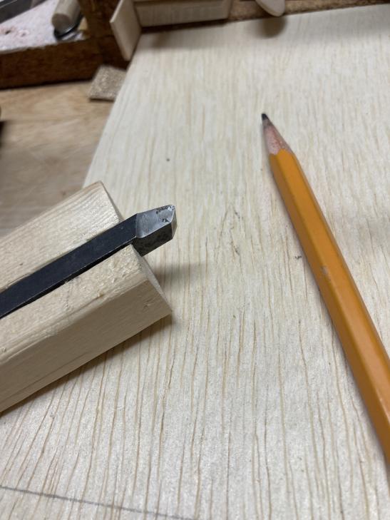

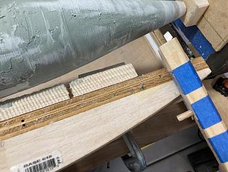

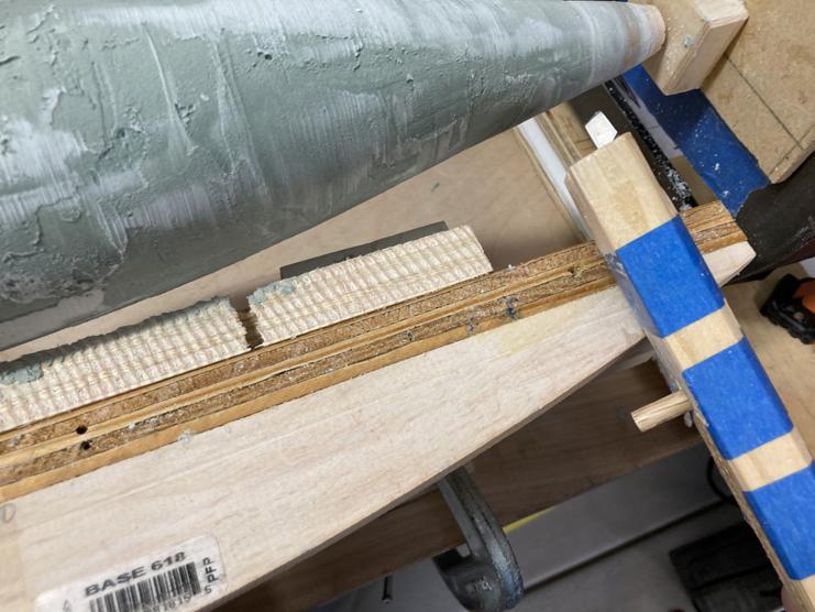

            So I started over turning the bow and stern sections from wood covered in Evercoat. My drill press became my lathe. A tool bit I made in metal shop over 50 years ago was put to work again. The dowel on the bottom of my tool rests against the guide for an accurate contour.

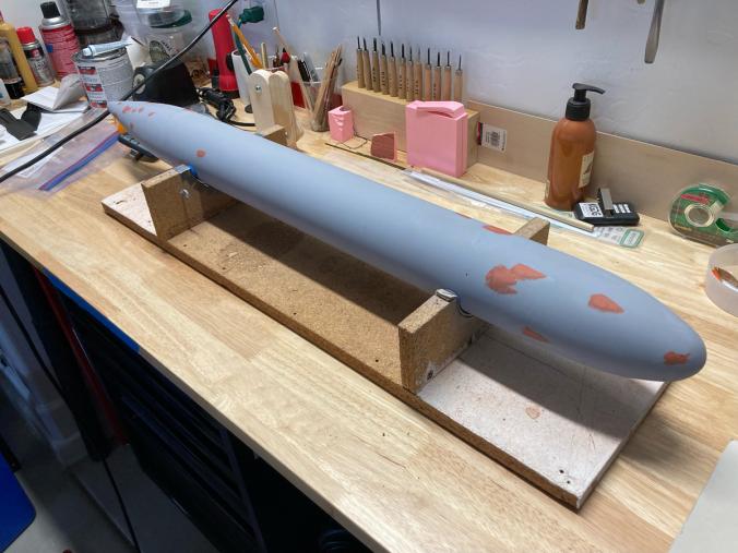

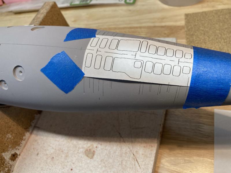

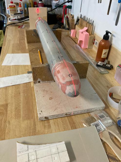

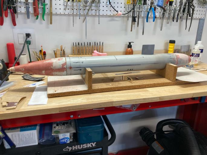

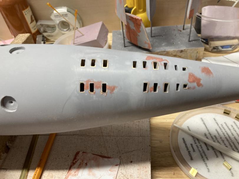

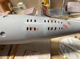

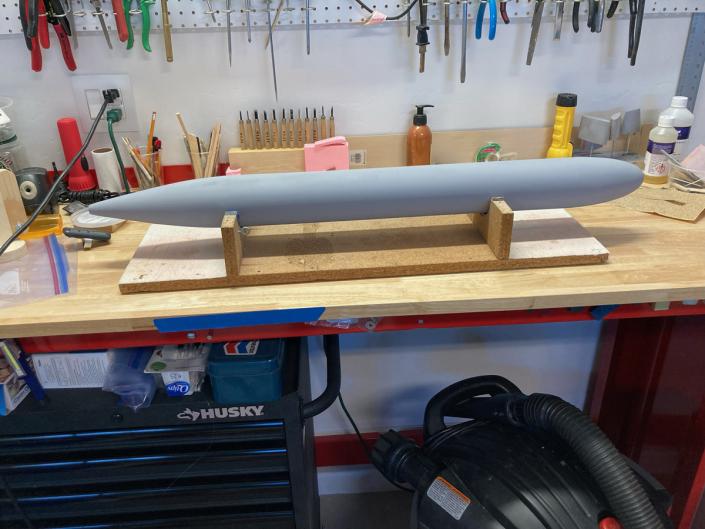

                Some recent work. Before priming I established upper and lower hull centerlines. Then drilled 1/16" holes to hold upper and lower centerlines. These will be filled in after the scribing is finished. Primed, filled with glazing putty, and sanded where needed (several times). Also drilled 3/4" holes for mounting rods. Starting to lay out lines for scribing.
ID:	166793Click image for larger version
ID:	166794Click image for larger version
ID:	166795Click image for larger version
ID:	166796Click image for larger version
ID:	166797Click image for larger version

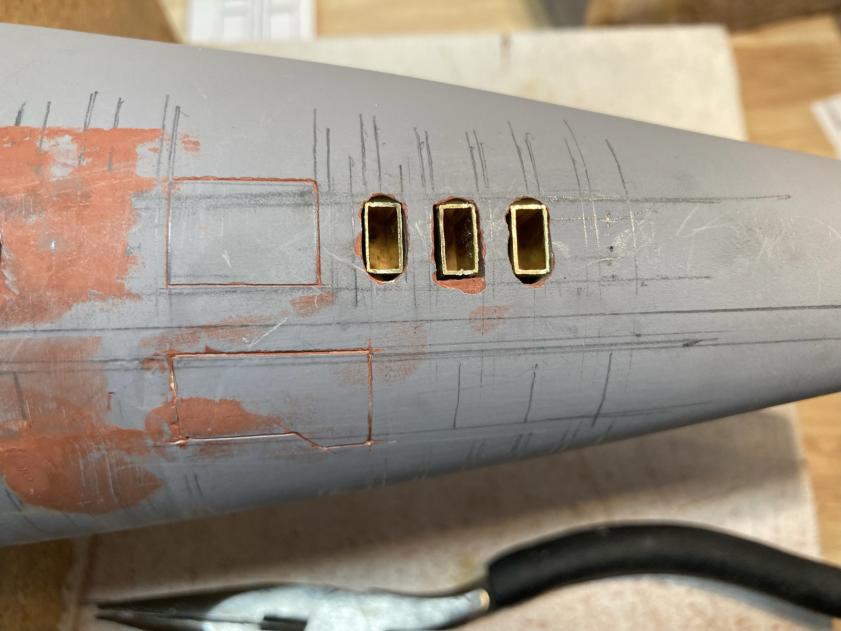

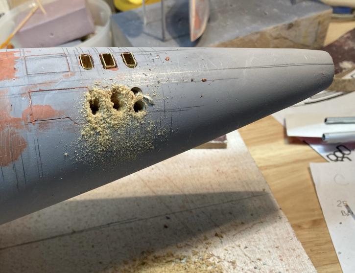

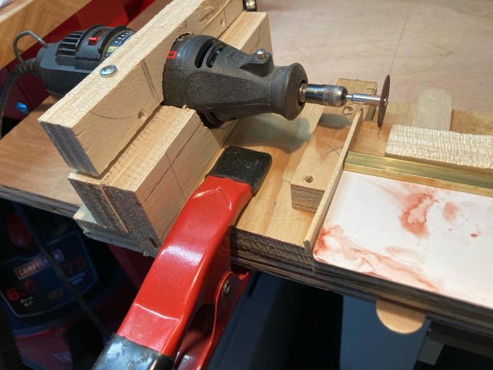

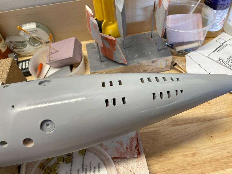

                        I'm using K&S rectangular and square tubing to create the floods aft on the underside of Tucson. Evergreen plastic shapes would have been much easier to use but my local Ace Hardware did not stock them and Hobby Lobby was much farther away. I created a jig to cut the brass tubing since I need several. It's been a long time since I did any scribing so my first attempt wasn't worth keeping. I'll rework that after some more practice. I thought about modeling the SPM (the Outboard) as I did on my Will Rogers several years ago but at this scale that was not going to be practical.
ID:	167227Click image for larger version
ID:	167228Click image for larger version
ID:	167229Click image for larger version
ID:	167230Click image for larger version
                        I just started to work on the forward floods and will have more on that later.

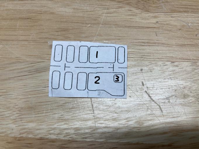

                            A question looking for an answer. This is a photo from the drawing showing Tucson underside aft. I'm guessing one is the cover for a stern anchor and the other is for a secondary propulsion motor but I'm guessing. So, what are numbers 1, 2 and 3? Anybody have an answer?
                            Will Rogers
                            SSBN659
                            • SubICman
                              • Jun 2022
                              • 87
                              1 is anchor, wrong shape tho, 2 is secondary propulsion skid and 3 is a flood grate on said skid
