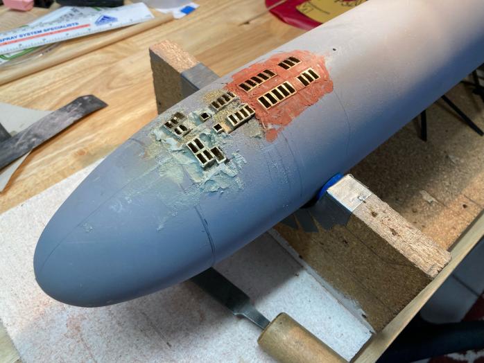

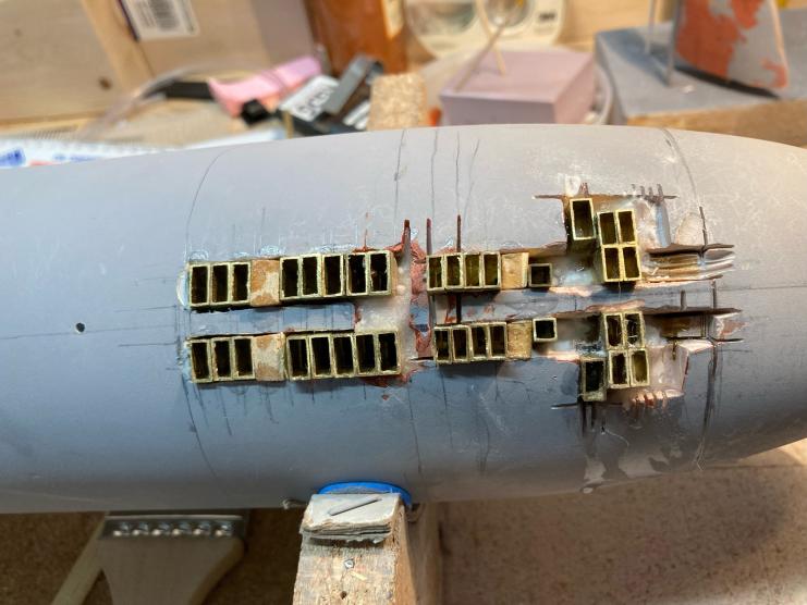

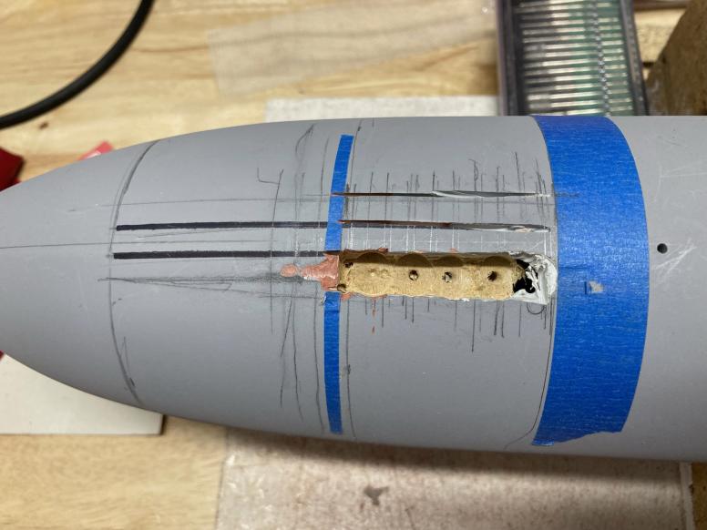

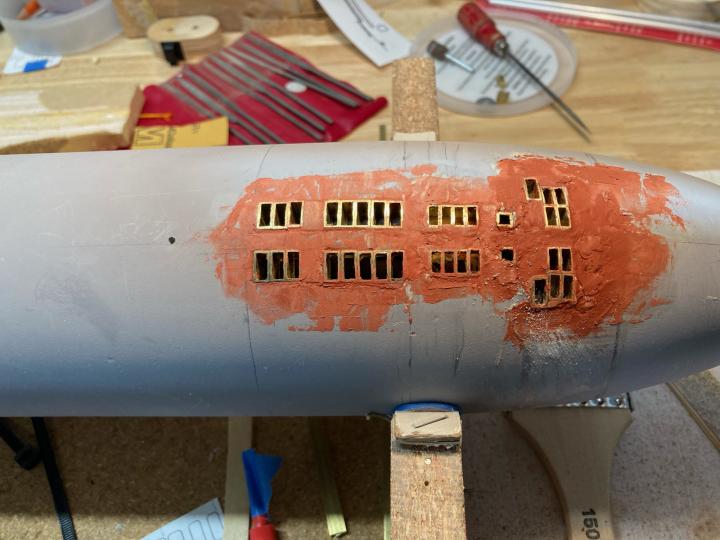

                    Two medium sized uploads worked. These show how I drilled out the bow underside to insert the brass tubes which were secured in baking soda and CA glue. The photo in my previous post shows where I used Evercoat filler and Bondo glazing putty.

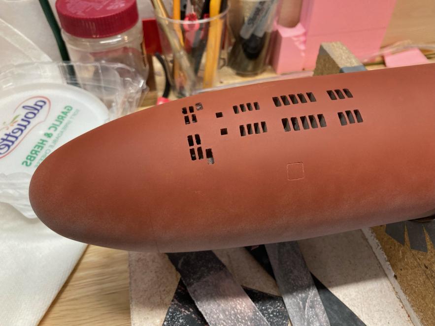

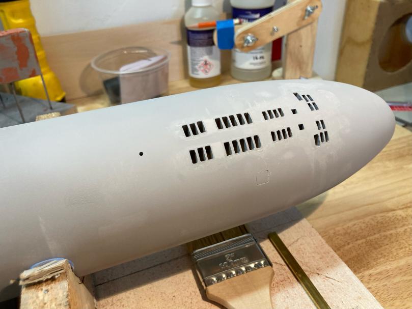

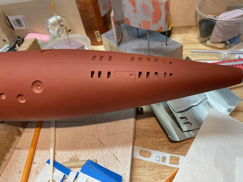

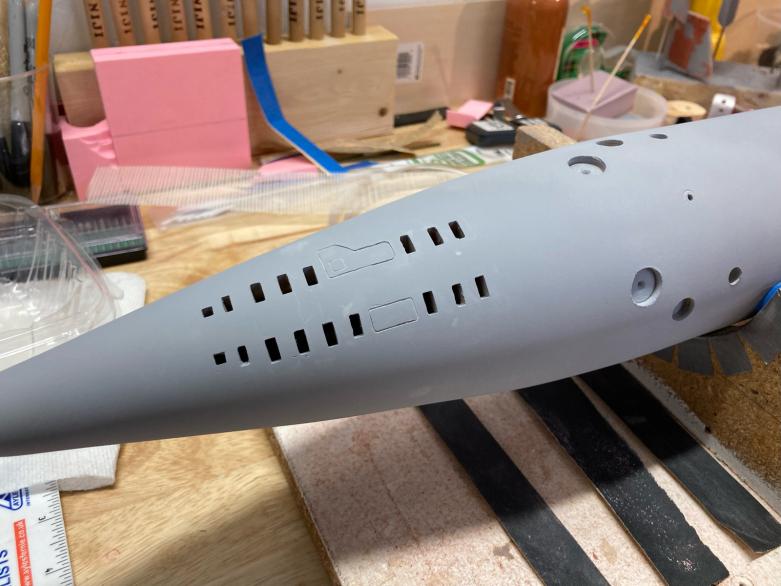

                        Finally got some red primer on the underside to check my work. Now layout of the topside details begins and I'll have some questions.

                        The first one is what are these openings?

                          Those are limber holes for the free flood area around the vls tubes we call the bath tub.

                            #43
                            Thanks, I assume then they are on both sides. Correct me if I'm wrong.

                              #44
                              They are indeed on both sides.

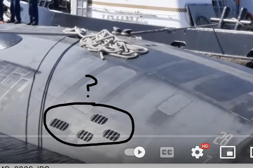

                                Too cold to work out in the garage so I've been searching the web and found this shot of the GREENVILLE on dock. These two areas don't show on the drawings I have. What are they?
