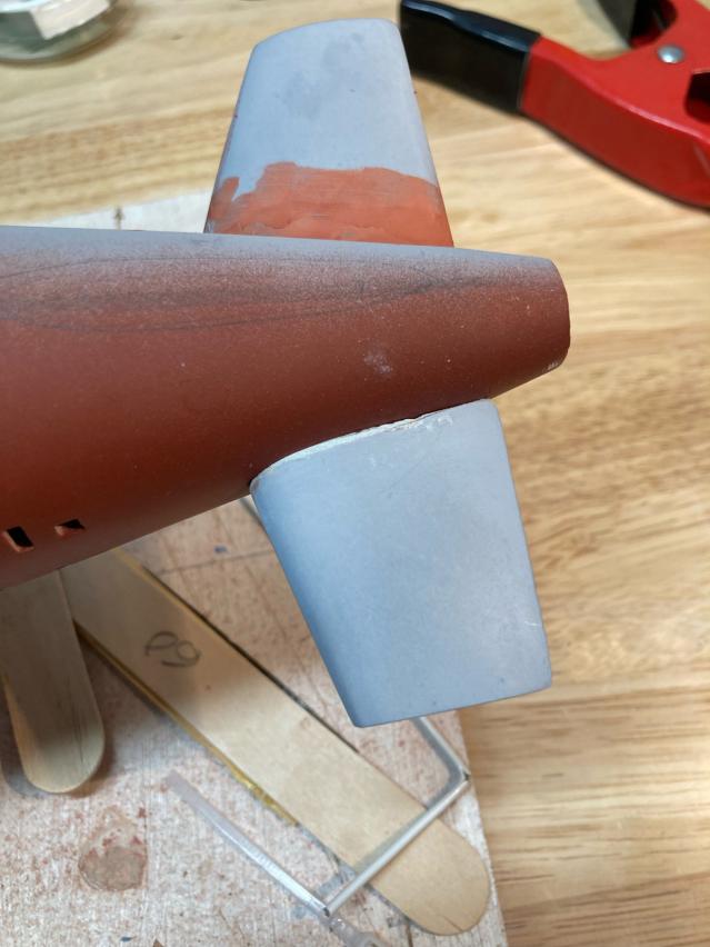

    Making slow progress. Upper and lower rudders. Next will be stern planes with fat line and thin line towed arrays.
Name:	Rudders 1 copy.jpg
ID:	171041Click image for larger version
Name:	Rudders 2 copy.jpg
ID:	171042Click image for larger version
Name:	Rudders 3 copy.jpg
ID:	171043Click image for larger version
Name:	Rudders 4 copy.jpg

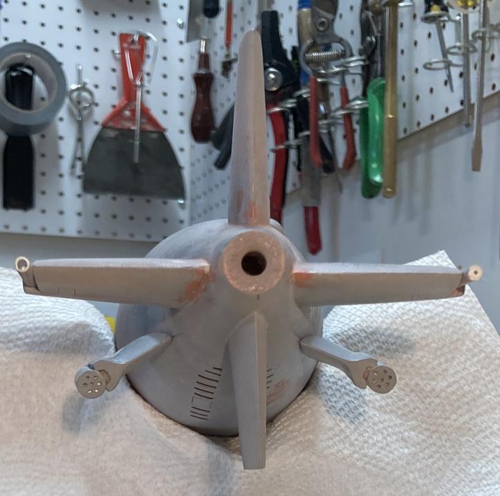

      Had some spare time this morning so here are fat line and thin line arrays as I formed the bottoms to conform to the hull. Next I'll permanently attach them with CA.

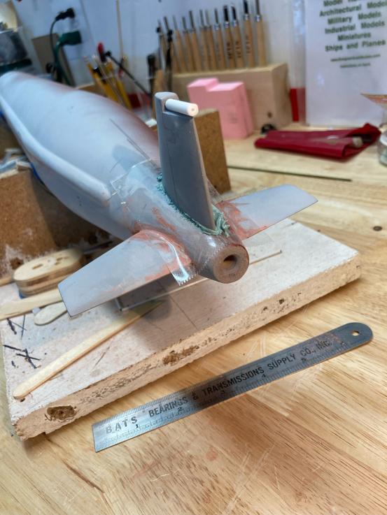

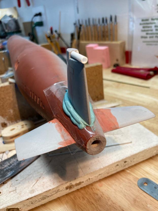

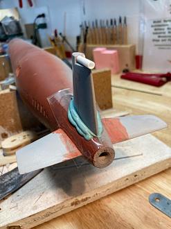

        Finally was able to do a dry fit of the countermeasures to check alignment before permanently attaching them. Looks like I need to make some adjustments. The fat line and thin line arrays are now permanently attached
Name:	Stern 1 copy.jpg
ID:	171088Click image for larger version
        Lots more to come.

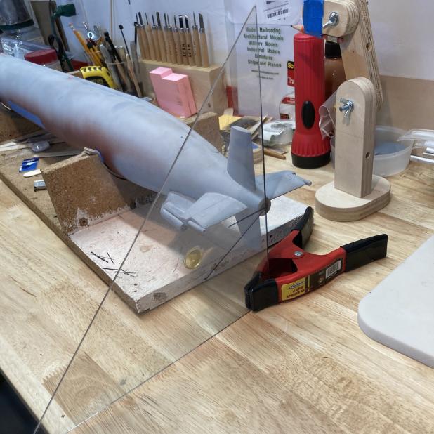

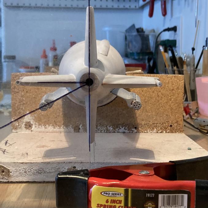

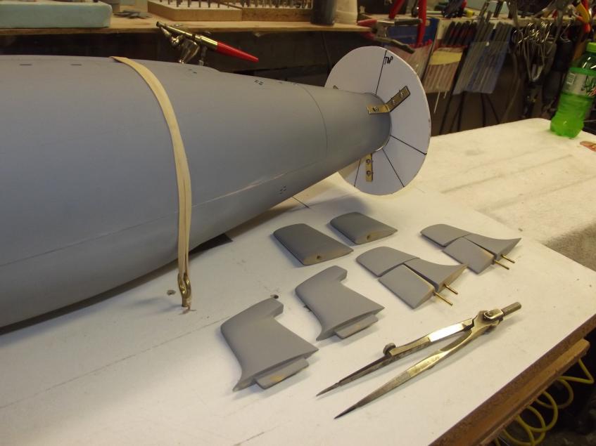

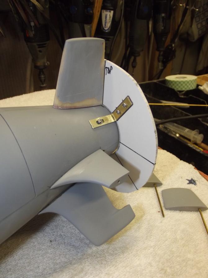

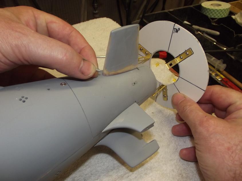

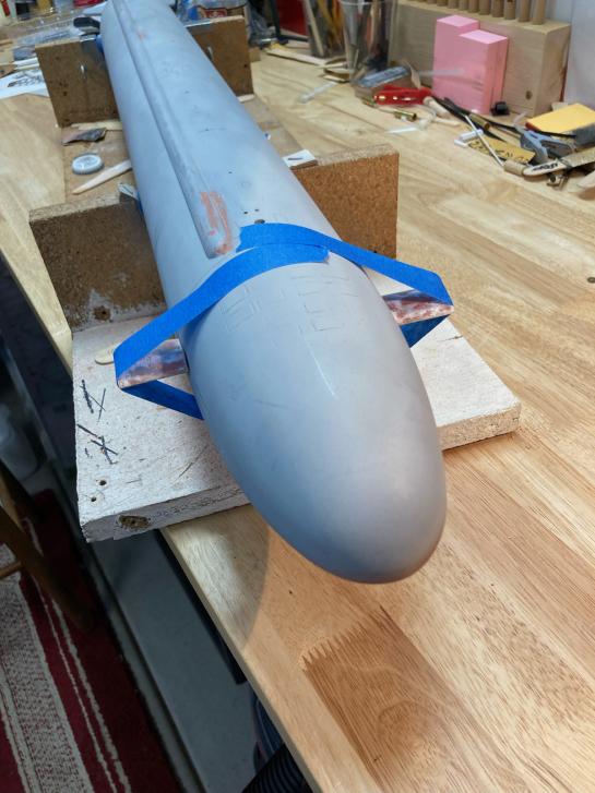

          Ok, I need some help David or others too. The alignment I did in the post above is not working for me. After two tries I still can't seem to get the 2 countermeasures aligned to my satisfaction. Anyone have any tips or ideas for an alignment jig?
          Thanks,
          Will Rogers
          SSBN659
            • 14010

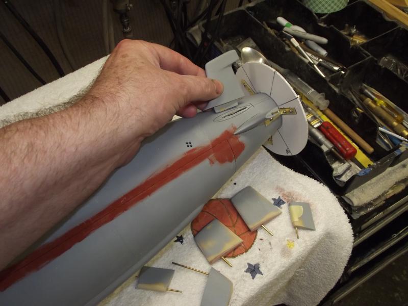

            #95
            Thanks,
            Will Rogers
            SSBN659

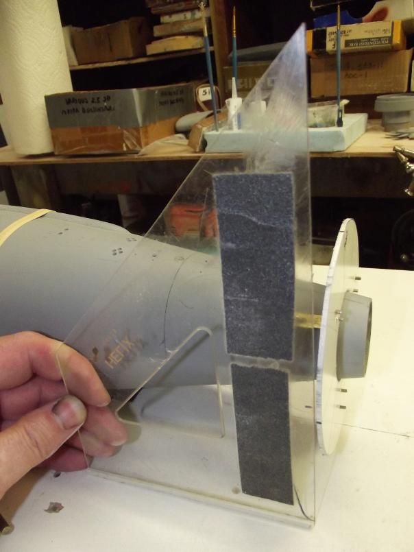

            Girdle the ass-end with a temporary alignment jig. Like this one used to get the tail-feathers right on a 1/96 SEAWOLF.

            • SSBN659
              • 418
              #96

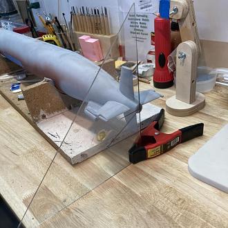

              Many thanks David, you gave me an idea. Always appreciate your help. I marked up my right triangle with felt tip marked and used it as my jig. For the starboard side I just reversed the triangle. I'm happy with result. Now, back to work

                #97
ID:	171134Click image for larger version
ID:	171135Click image for larger version
ID:	171136Click image for larger version
                Will Rogers
                SSBN659
                Slick trick with the right-tringle, Will. Very slick! I'll file that away -- much simpler than my deep-sea-nuclear-powered-overkill alignment jig. KISS on display.

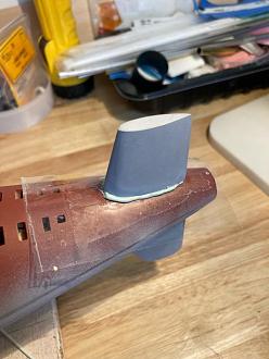

                  #98

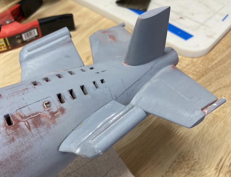

                  A quick update on the forward planes progress.
Name:	Forward Planes 1 copy.jpg
ID:	171257Click image for larger version
Name:	Forward Planes 2 copy.jpg
ID:	171258Click image for larger version
Name:	Forward Planes 3 copy.jpg
ID:	171259Click image for larger version
Name:	Forward Planes 4 copy.jpg

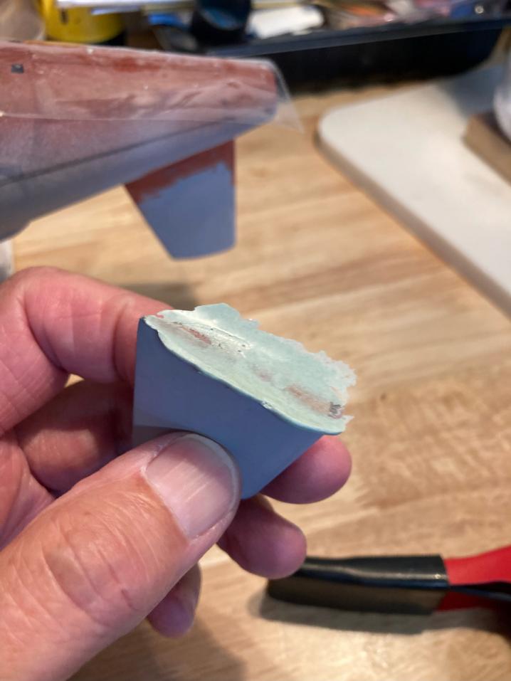

                  The last photo shows where I used baking soda and crazy glue to fill the void between the plane and the hull. Doesn't look good right now but some sanding will fix that.

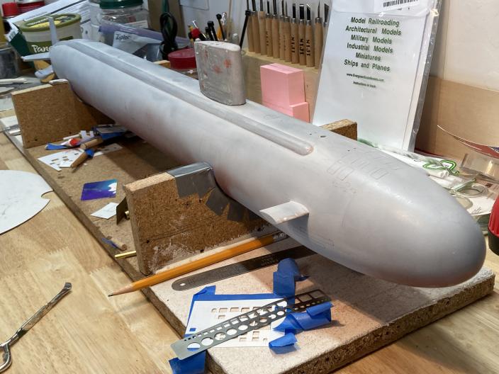

                    • SSBN659
                      • 418
                      #100

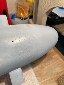

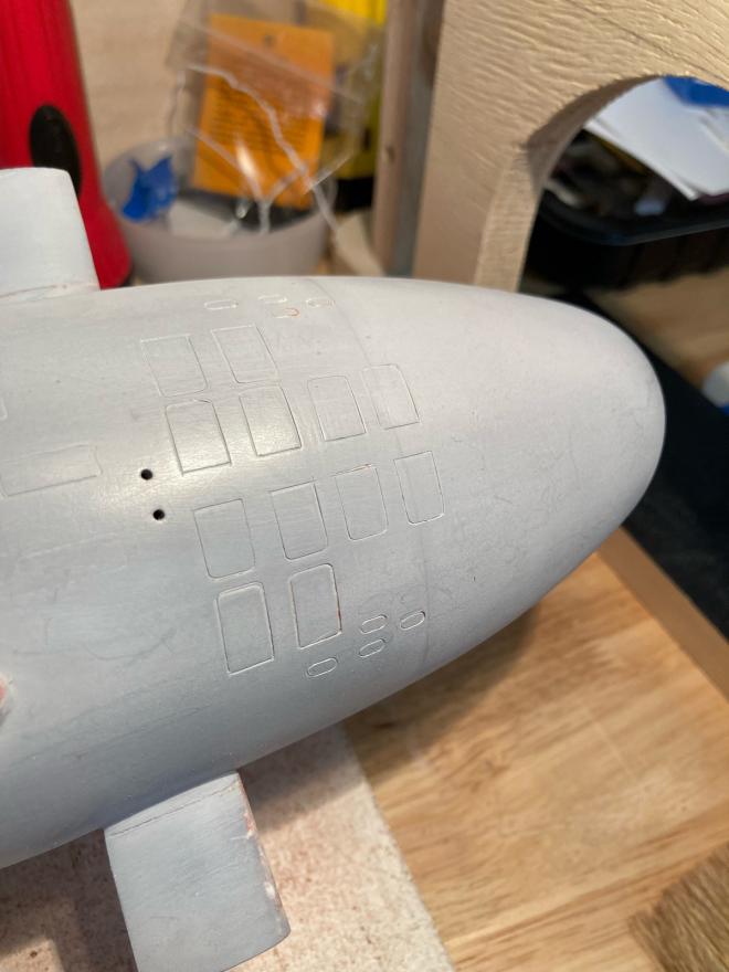

                      Work continues on Tucson, although slowly as I'm the sole care giver for my wife who had another bad fall but is now doing well with her recovery.
                      Tucson is beginning to take shape nicely, even though looking a bit rough. And yes, the workbench looks a bit rough too.
ID:	171698Click image for larger version
ID:	171699Click image for larger version
Name:	IMG_9163 2 copy.jpg
                      Once I clean up the scribing I'll start some of the finer work such as masts, capstan, cleats, strainers, ballast vents, etc.

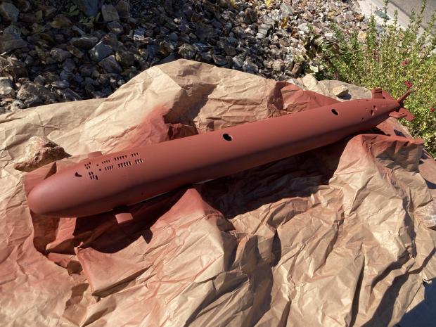

                      A question for the audience. My drawing shows only one auxiliary seawater intake and discharge but I suspect there are two each. Can anyone out there confirm which is correct?
                      Thanks in advance for any help on this.
                      Will Rogers

                        #101
                        Your boat is a beauty....
                          Will Rogers
                          SSSBN659
                          Yupe. Mirror the MSW and ASW suction and discharges -- one set on each side near the stern.
                          • SSBN659
                            • 418
                            #103

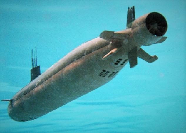

                            What would be nice would be a look at the Docking Plan showing the locations of the intake and discharge openings.
                            Will Rogers
                            SSBN659
                            • SSBN659
                              • 418

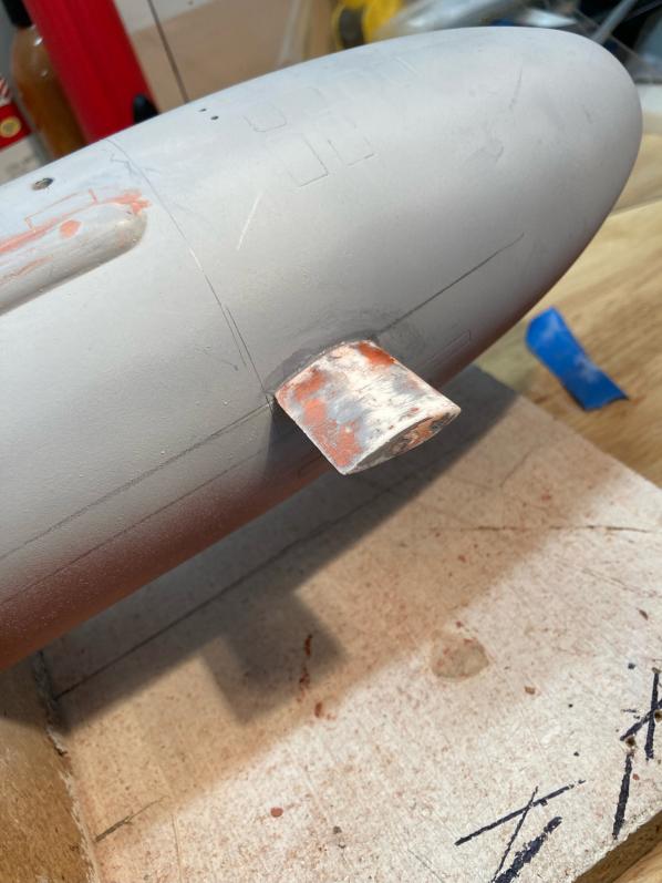

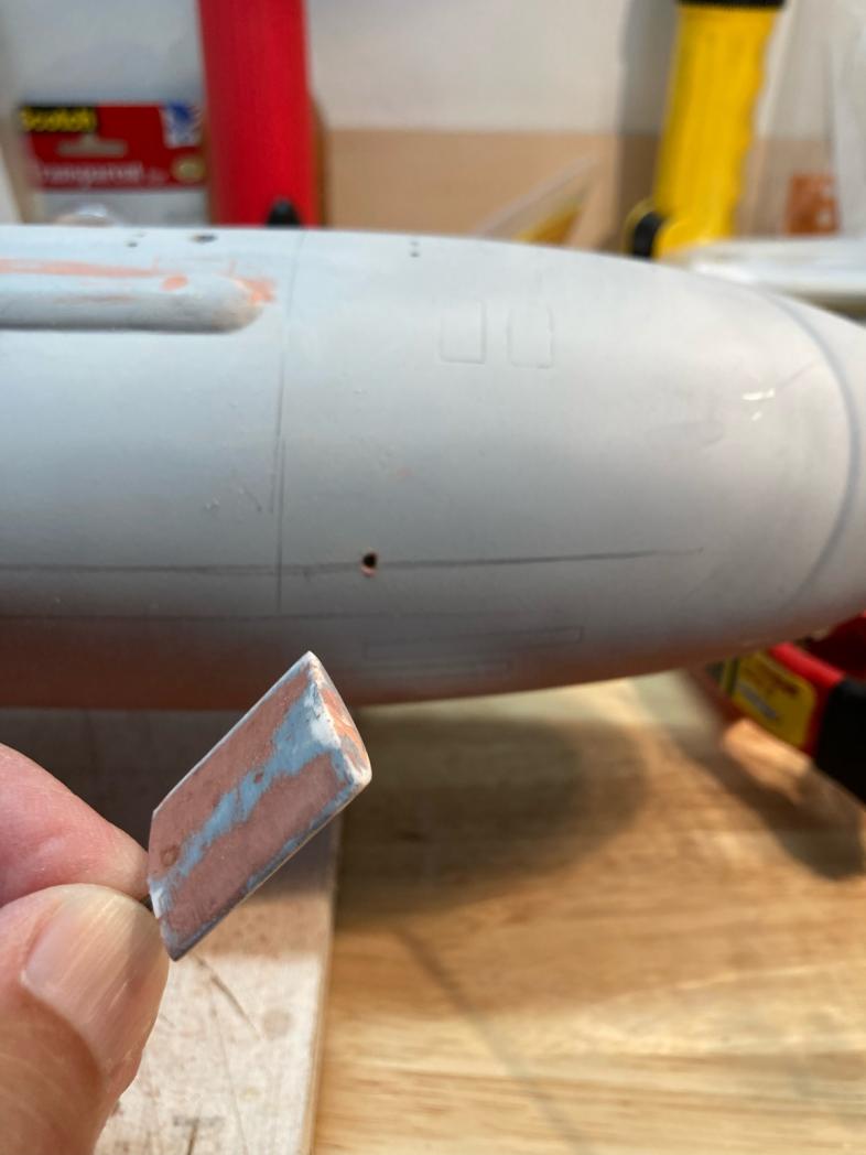

                              #104
                              Without a look at a Docking Plan I made a guess based on cooler seawater intakes being forward of and higher than the warmer seawater discharges. Work on the underside (in red primer) is almost complete except for a few spots needing touchup. Then I will install grates on the intakes and discharges and do a final coat of red on the underside.
                              Will Rogers
                              SSBN659
                              • wlambing
                                • Nov 2020
                                • 402
                                #105
