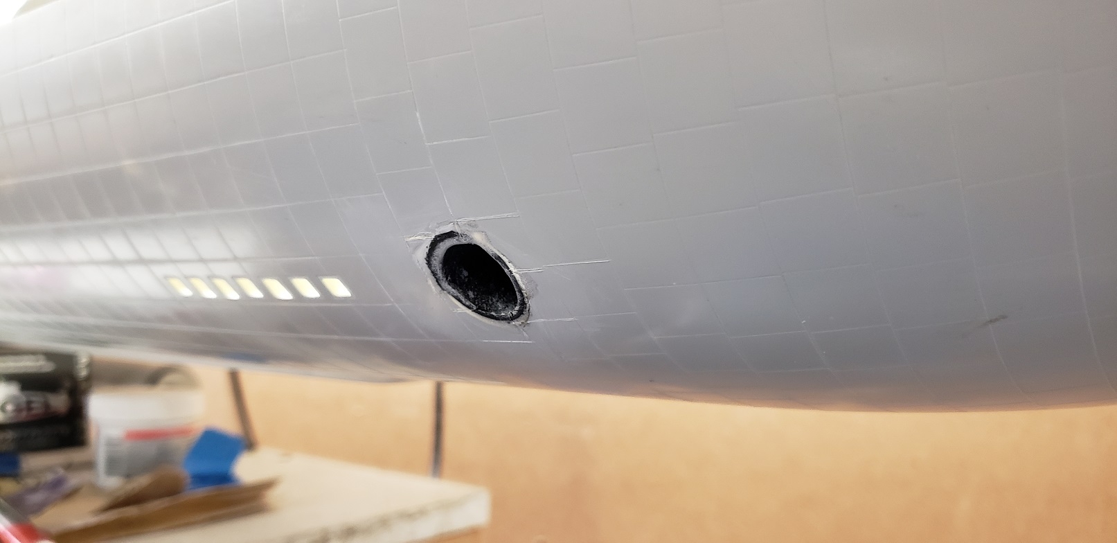

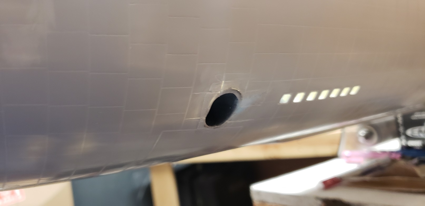

    #76

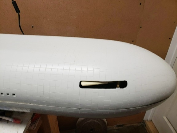

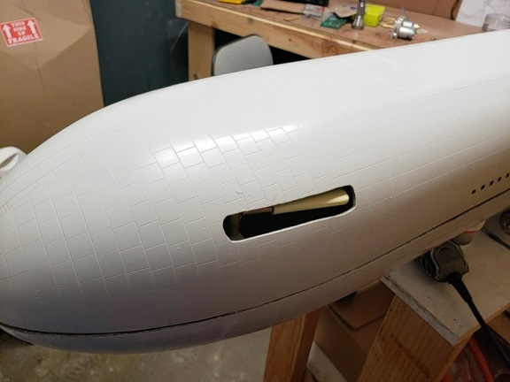

    installation of my bow thruster system. I'm planning to put detail on this sub other have not done at least not yet

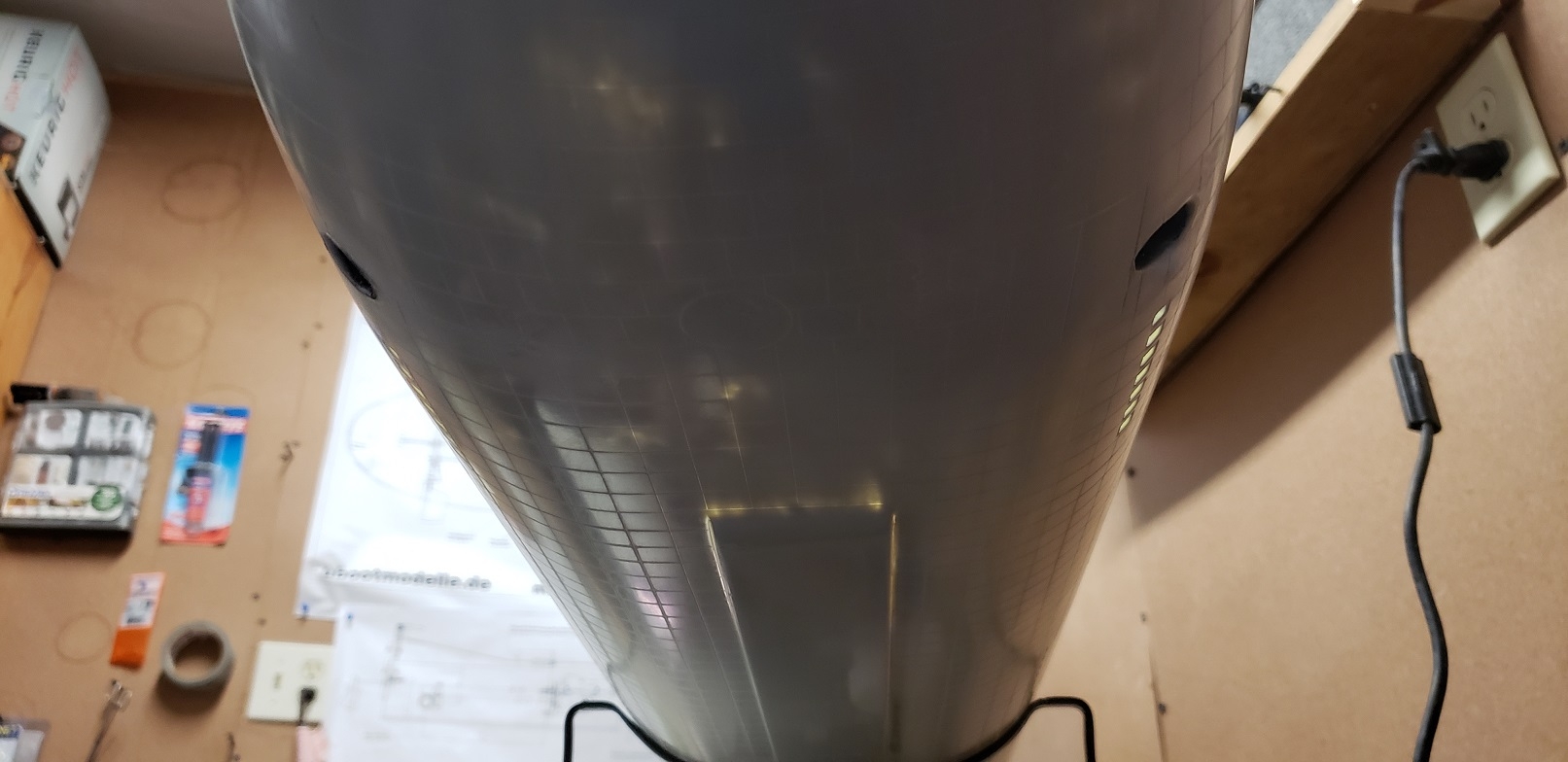

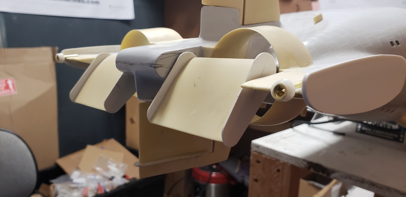

      #77

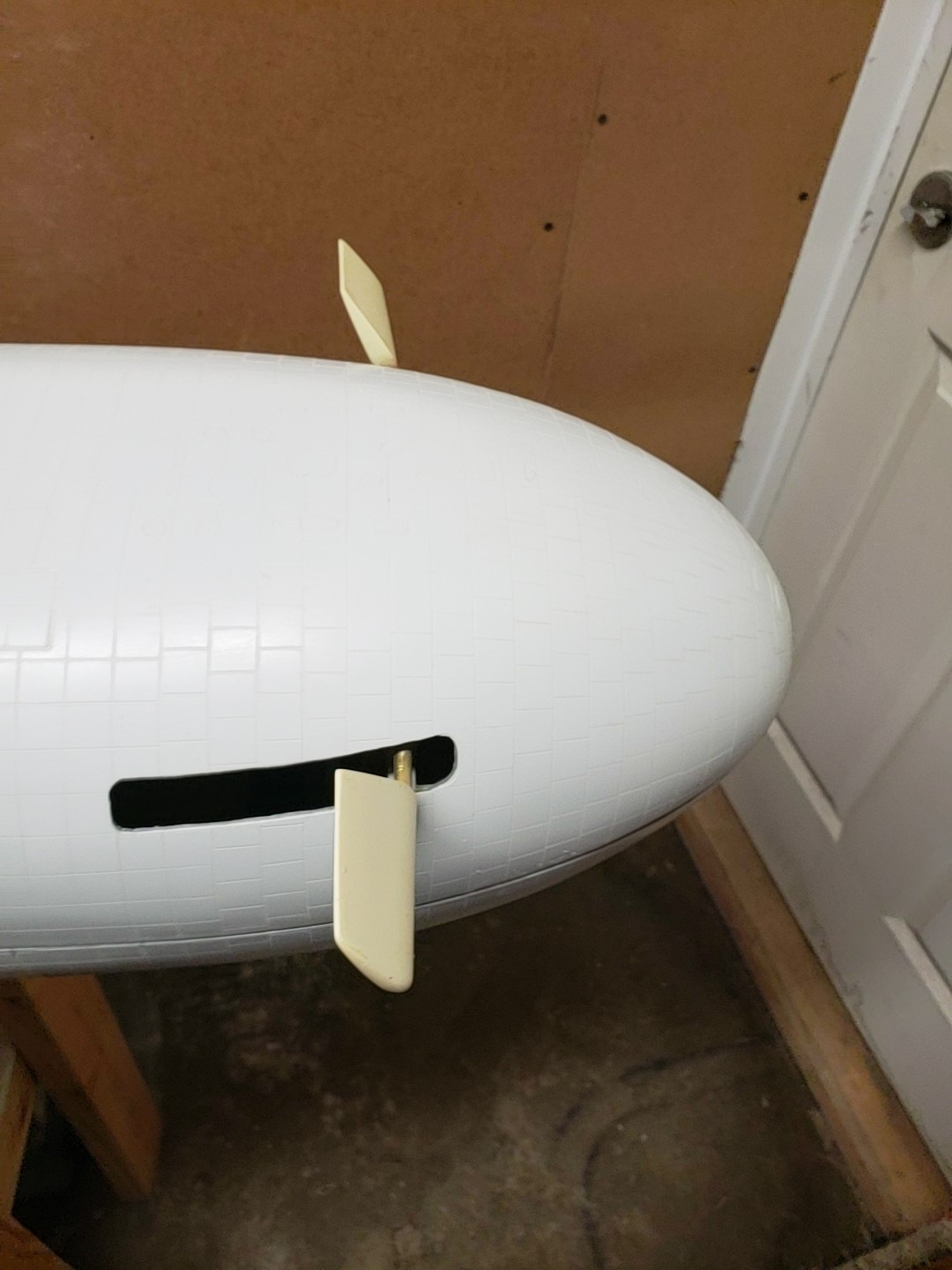

      thruster jets glued and sanded smooth while i had to do some rework on some of the scribe . will work on it more after primer is placed on. some day some time in the future I don't know! LOL.

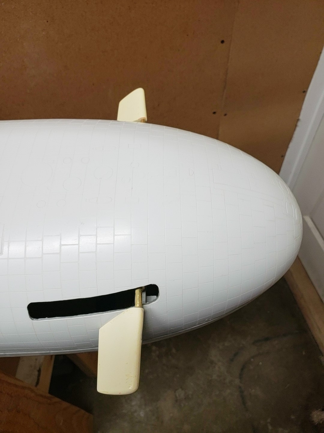

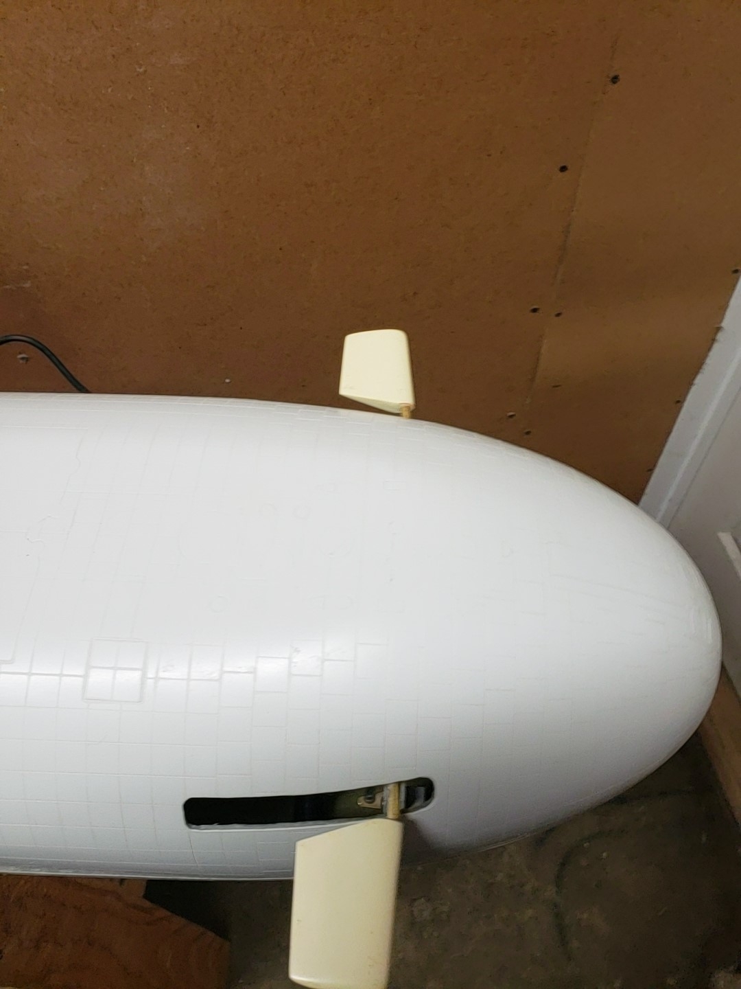

        #78
        dive plans work great all different angels
        Put your mind to it. If there's a will there's a way!

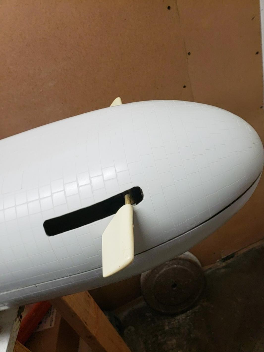

          #79
          one more angel

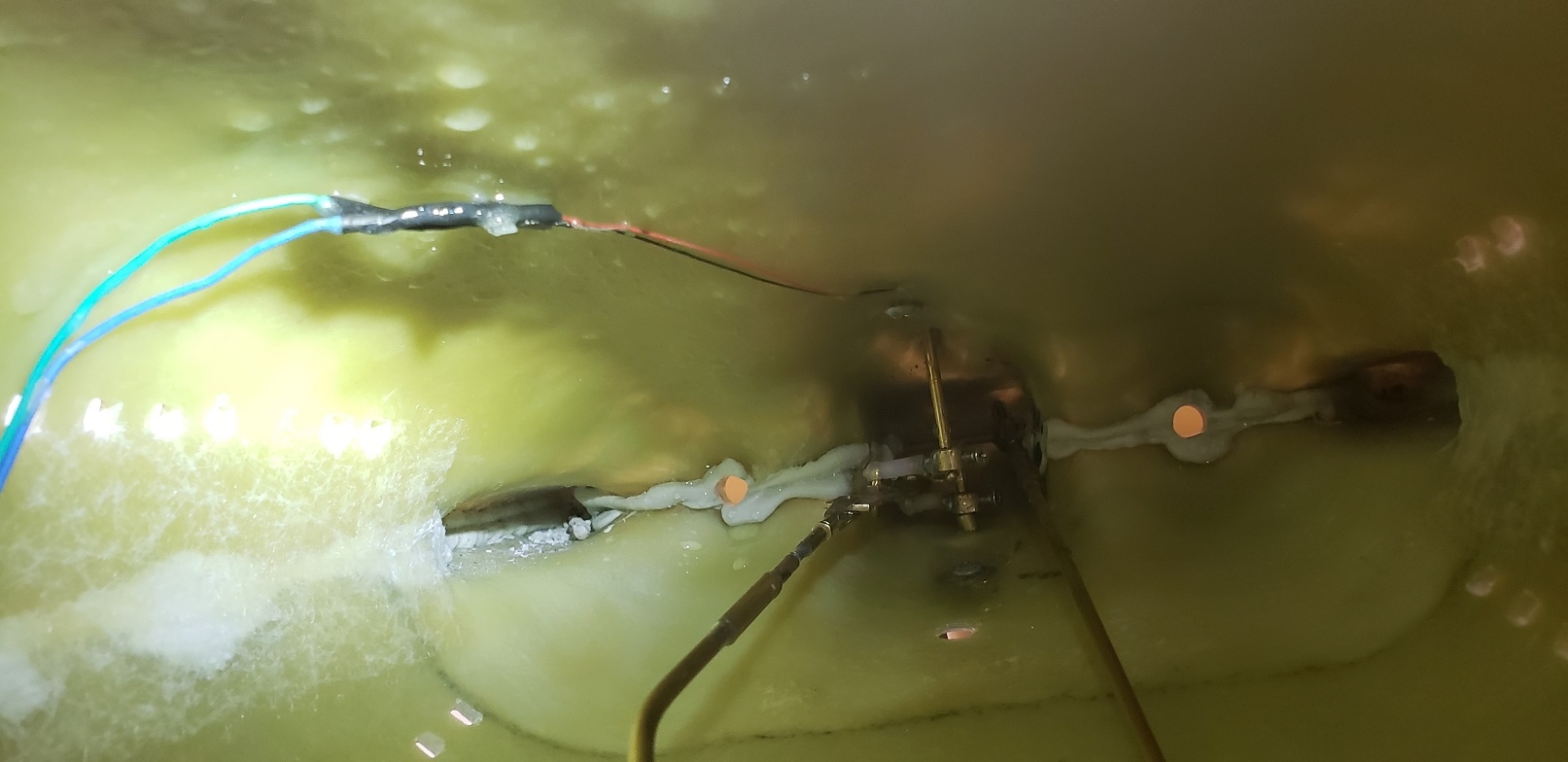

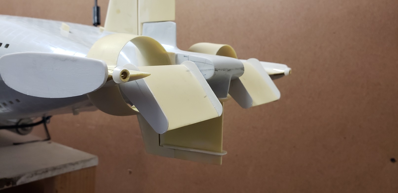

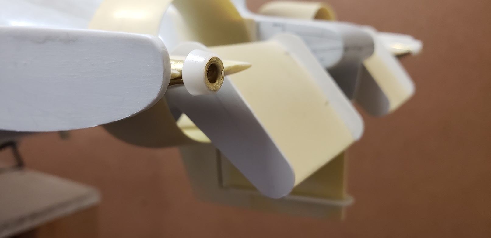

ID:	129660Click image for larger version  Name:	2q.jpg Views:	1 Size:	432.0 KB ID:	129659 tail fin light wire glued into the top out of the way and both brass push rods are in works smooth and perfect.

              #81
              fit perfect don't touch anything precession David im good

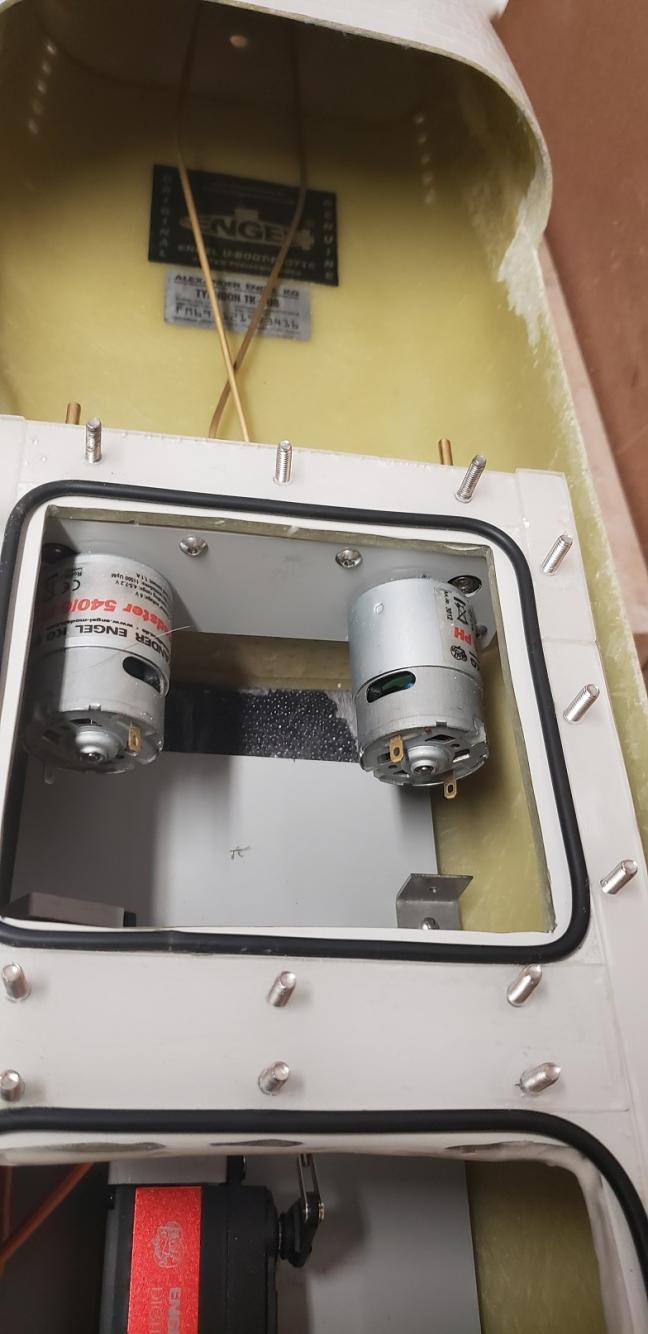

                #82

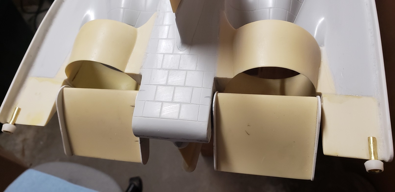

                motor have been installed next to place the drive shafts in next and control rods linked up to servos to work rudder tail fins all that fun stuff

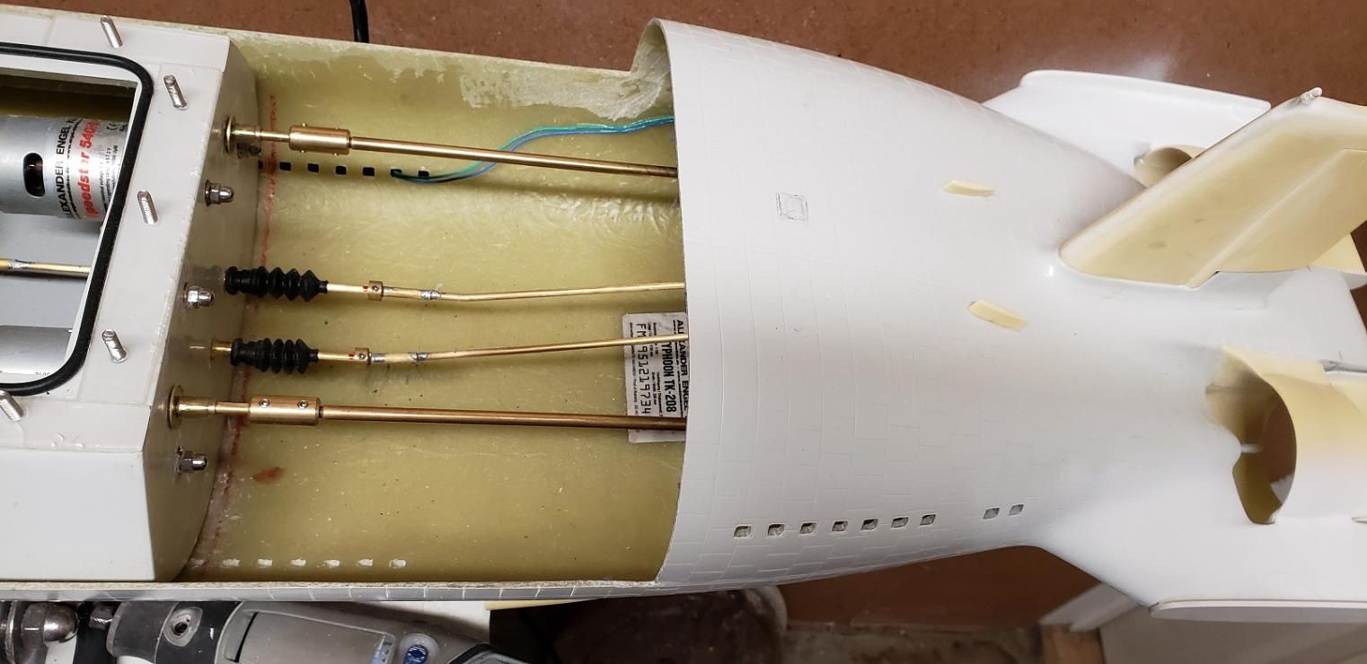

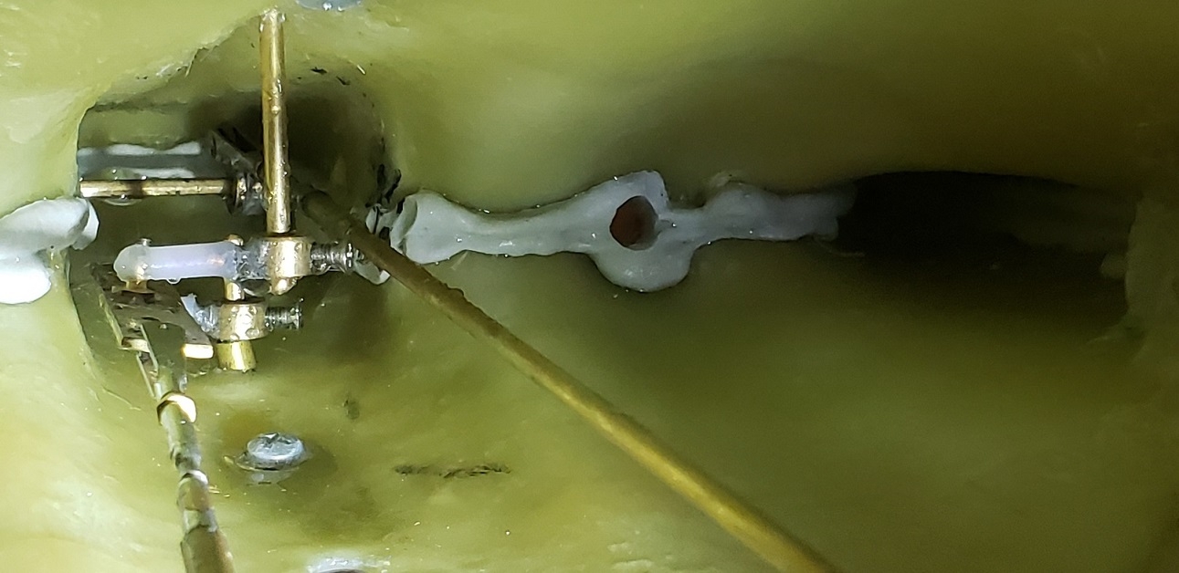

                  points awarded for hitting back and sticking with it.

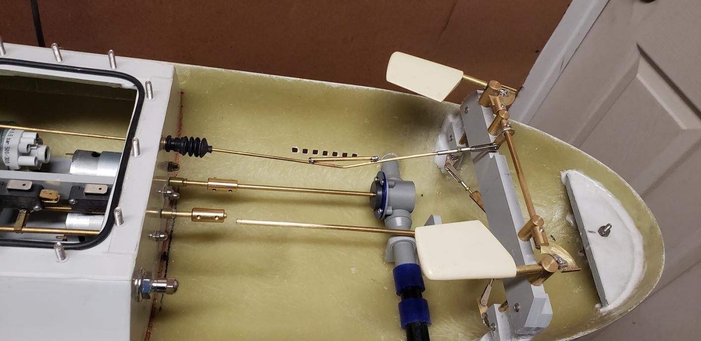

                  • Mankster
                    • 41
                    #84
                    I did it a little different for those push rods. I used regular servo horns. Also I found I need to reinforce the bend on the push rods to stop them flexing - very important for the rear dive plane servo for good depth keeping.
                    • deepseadiver
                      • 297
                      #85
                      Hi thanks for the tip I really like what you did right on. Good stuff to know picture explain what you did very well
                      if I see any flex I may do the same . So far it looks solid when I work the servo between push rod and rudder.
                      Jim :)

                          #87
                          drive shaft installed work smooth
