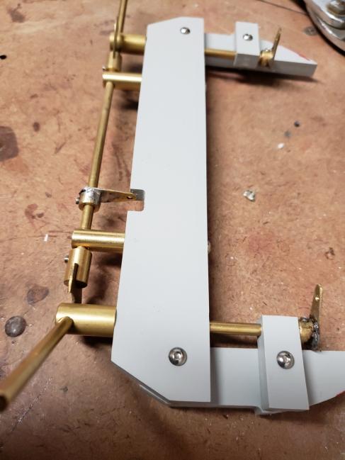

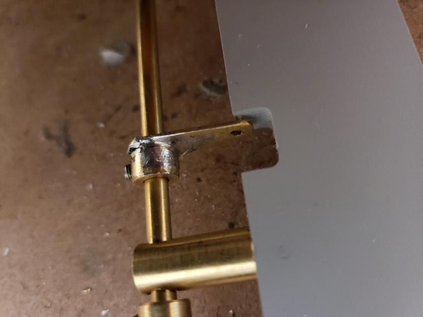

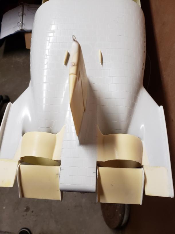

    last picture of everything attached and pic of the dive plan system being built

      pic of the dive plan lots of little soldering needed to be done

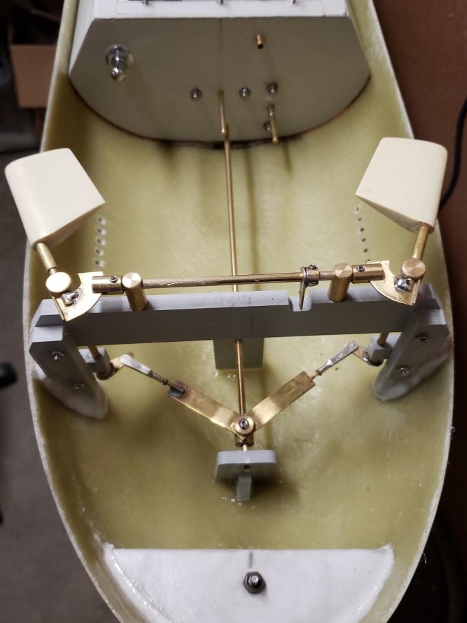

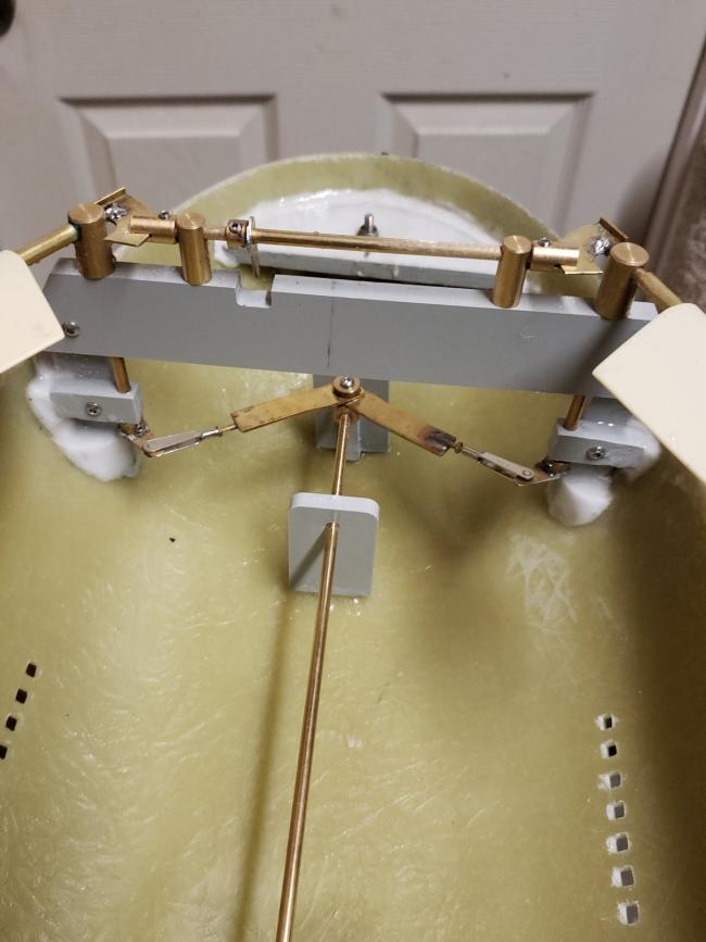

        everything glued in and tested works perfect

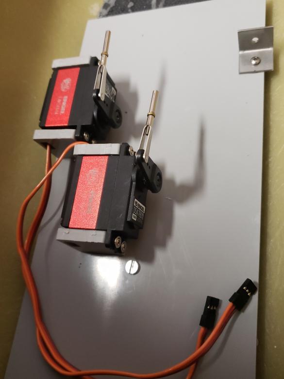

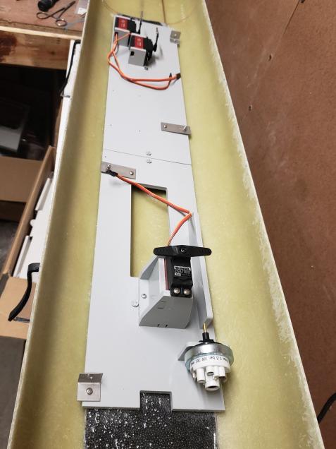

          staring to work on some of thee electronics plus next working on the motor installation and drive shafts and gluing in the WTC

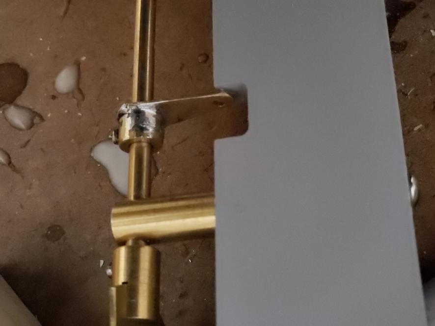

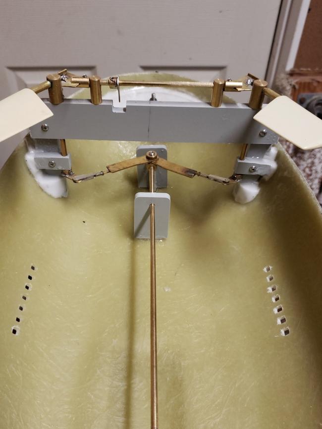

                Very nice. Just curious, are those clevis clips on the bow planes all brass or stainless? I ask because I played around with some on my boat, once upon a time, and they immediately began to rust.

                  good question they are stainless steel . Engel did not give me any brass clevis so I will try to coat these with a clear coating to help them from not rusting or switch them out
                  thanks for the good tip by the way !
                  Jim
