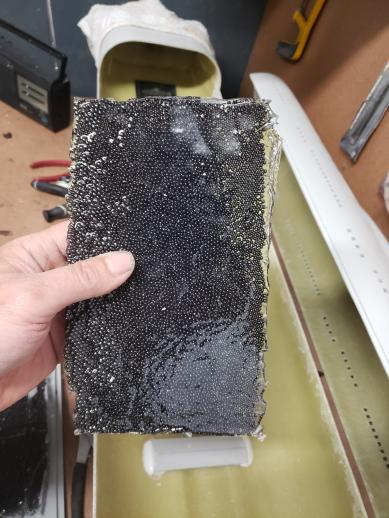

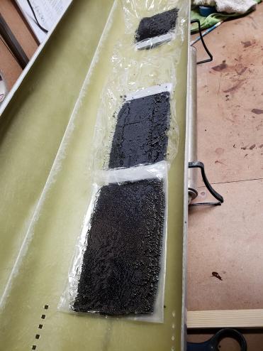

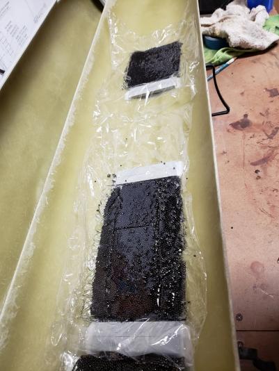

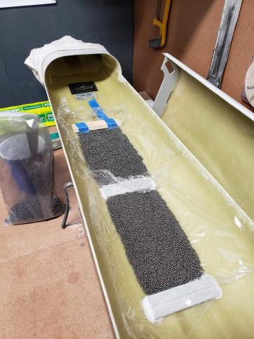

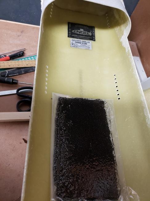

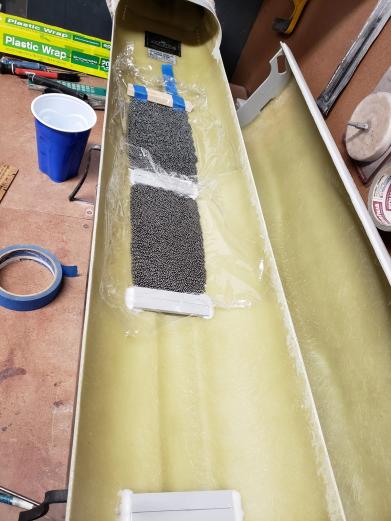

      here are some lead weight shot In the keel I used plastic wrap because I did not have any wax paper seem to work just fine and it came off the resin once it cured plastic wrap peeled right off. Now I can have all the weight required In the keel and easy to remove if I need to during trimming. Once I know the correct weight I will glue them in. What do you think ?
      Put your mind to it. If there's a will there's a way!

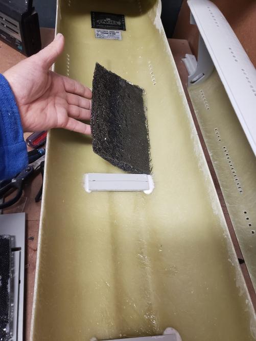

      • deepseadiver
        • 297

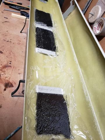

        more pictures

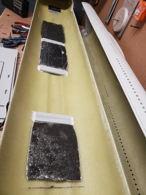

          once I get them out I will trim off the excess resin

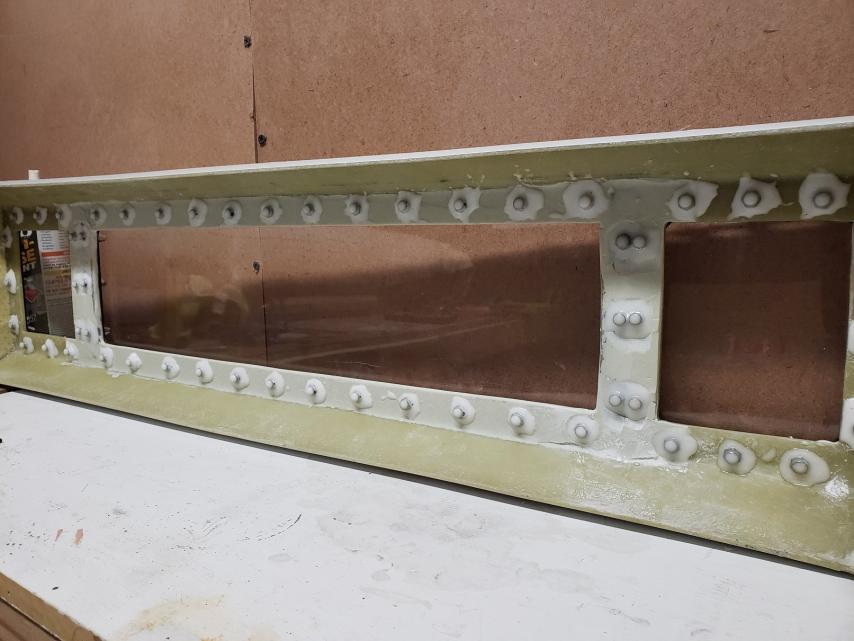

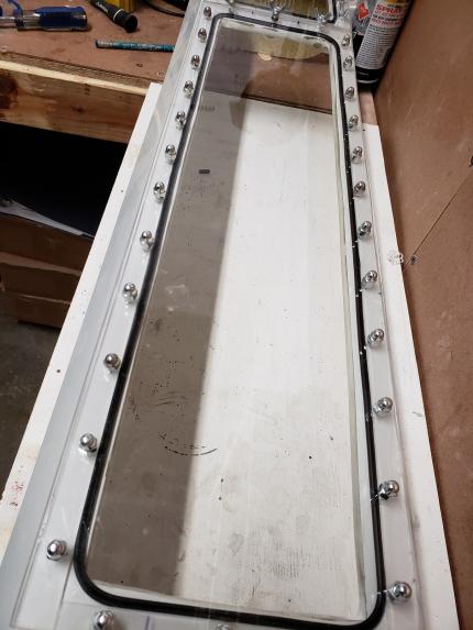

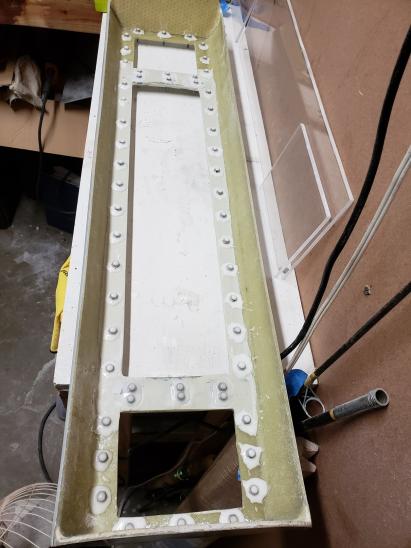

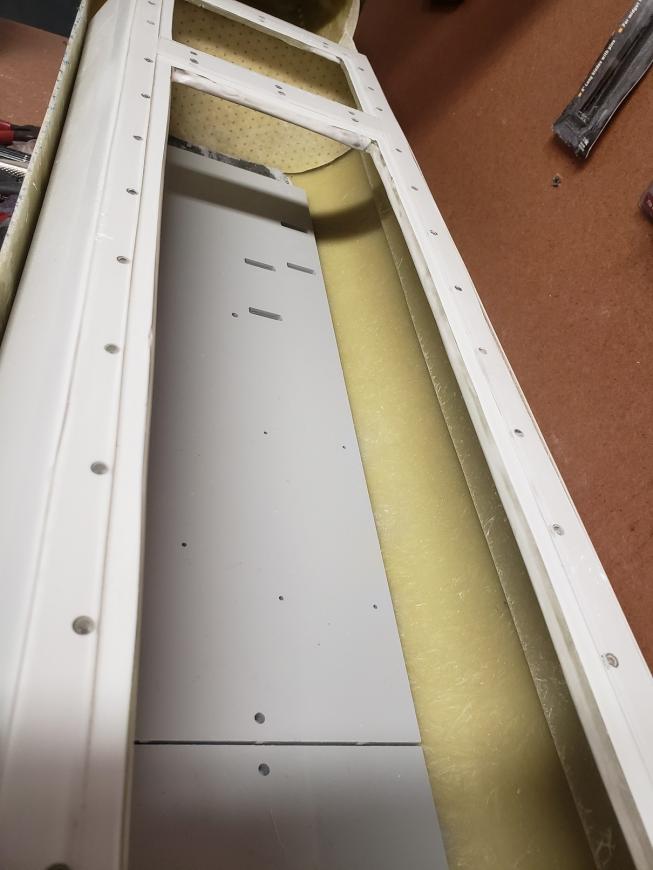

            Here's what I have done so far to the electronic box I have the holes drilled a custom lip I placed over them which the groove for the rubber gasket goes into them. Next I'm going to install SS bolts, epoxy them in place all 44 of them .
            Comments welcomed !

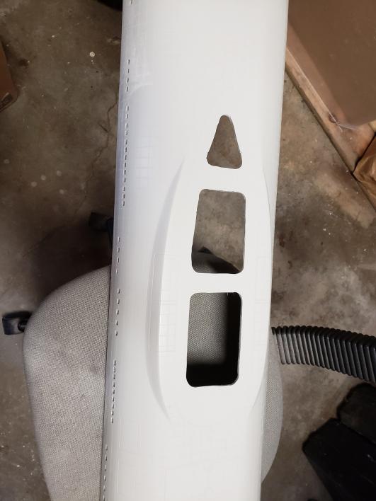

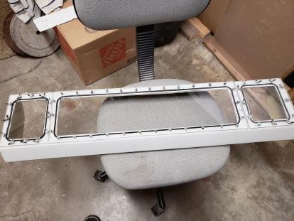

                trimmed out the top piece of the submarine conning towers opening

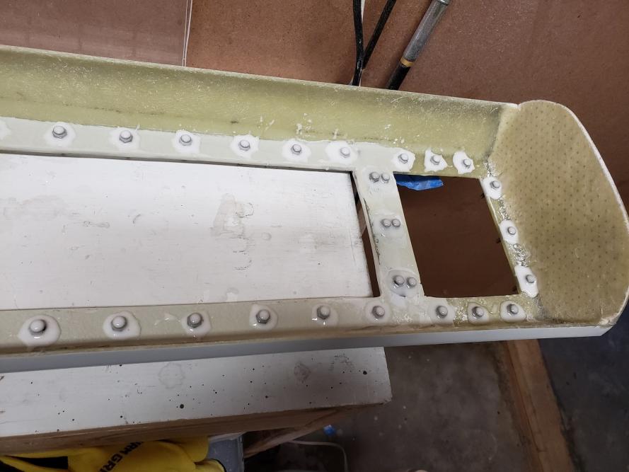

                  the bolts that all got glued in what a job getting them all glued in .
                  • deepseadiver
                    • 297

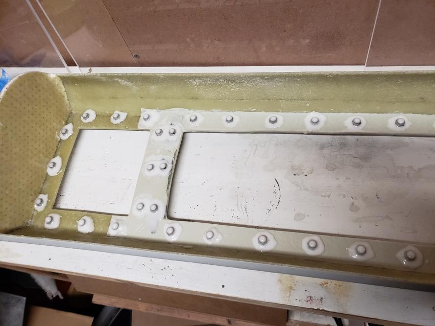

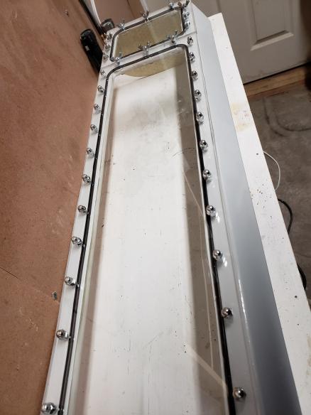

                    bolts are secure and the 4mm rubber cord gasket is installed
                    • deepseadiver
                      • 297

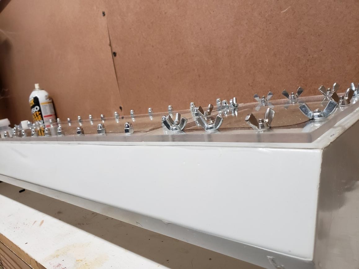

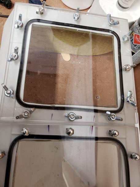

                      Oh boy that was a big job making that custom WTC with see through windows, for the electronics it was well worth it indeed (Thanks Bob for advising me to do it.)

                        Great work so far, Jim! Are you going to swap out the acorn nuts for the main section for wing nuts, or just use the supplied ones?
                          Hi bob,
                          good question I was going to ask you that same question you read my mind. After looking at your typhoon video, I see the switch is in the middle so should I place the acorn on the ends and use the wing nuts for the middle section? plus Engel uses a magnetic switch to turn things on and off should I use it?
                            You definitely need a switch of some kind. The magnetic ones work okay, but I've fallen in love with my remote switches. 15A capacity, which should be fine for the Engel boat. No need to swipe a specific spot. Just click the fob on and click the fob off.
                            I'd replace all the acorns with wing nuts, personally. No need for tools, easy to get on and off, and easy to feel the correct amount of pressure when you're tightening them up.
