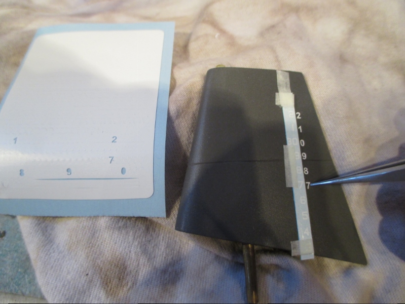

                I think all I have to do is print up the picture of the correct size by using power point make sure the colors, are correct and print it on that special decal label water transfer paper then spray seal it . Then trim it out and water transfer to the submarine.
                I was told to use a laser printer, if I have one because the print was suppose to come out even better . Keep in mind I like the vinyl idea' but that's very expensive, for what im doing its a small label logo .
                So I think the quality, will be just fine with out spending tons of money, on one small decal is it really worth it ?
                I think this is a small decal it will look just as good as vinyl because its small, otherwise I would use a vinyl method.
                I will spray a flat sealer over the decal once its on the sub for water proofing!

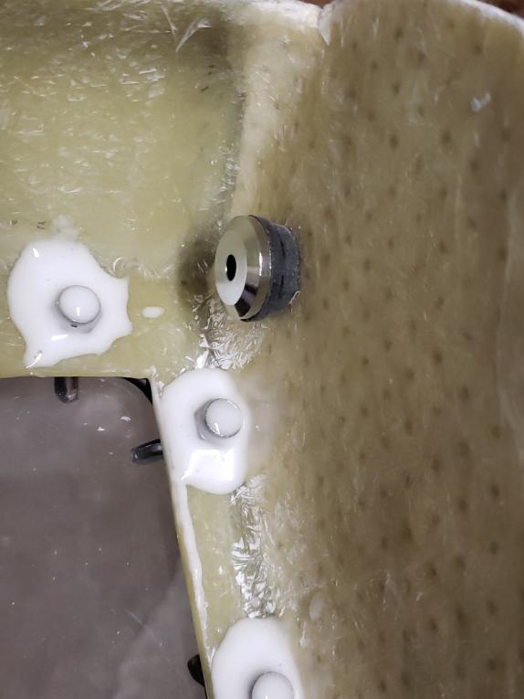

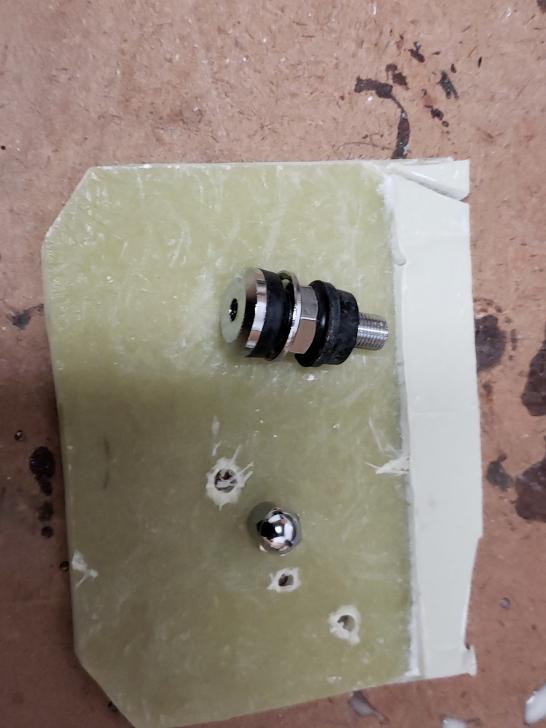

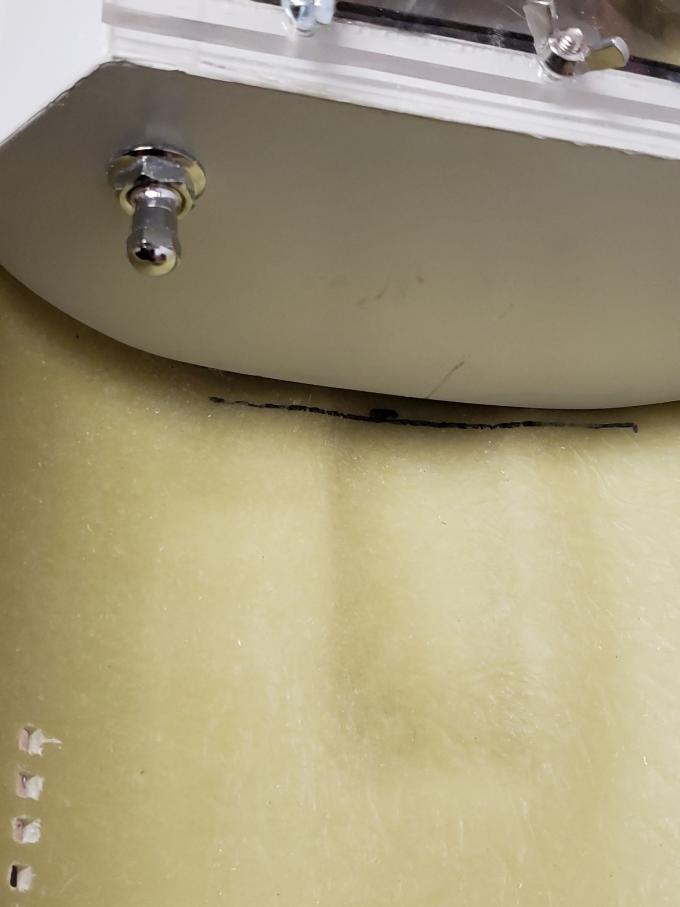

                  thanks to Bob Martin, I installed a air valve which is a better way to pressurize the WTC to check for leaks. Place some pressurized air inside then place in s pool check for bubbles .
                  Put your mind to it. If there's a will there's a way!
                  • deepseadiver
                    • 296
                    #39
                    Valve to be able to check the WTC electronics box for water tight seal integrity

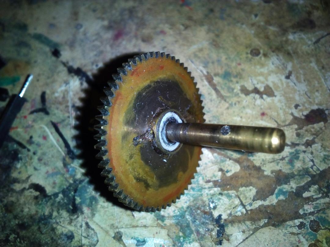

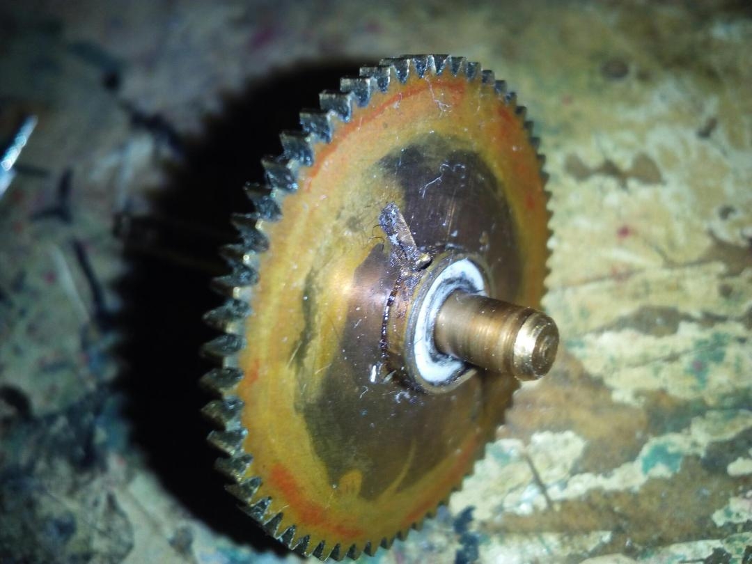

                        A gentlemen from England shared this with me after a period of time this happened to one of his typhoon propeller, shafts. I wanted to share this .
                        He explained to me, is when the propellers, hit some grass, or things in the water, over time you will get this main drive gear, to slip and pull out from it's mount and slip and spin around the drive shaft. . So what he did was drill, a hole through the gear, and shaft, and placed a pin . I will look at my gear ,system also see what I can do to make sure this does not happen to me . Comments are welcome everyone. Anyone else have this problem please share.
                        Seems that the motor keeps trying to turn because somethings binding the prop and something breaks!
