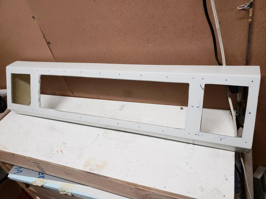

    just started on cutting out my flood ports, and the openings for the dive planes. Here is what I have done so far still have more to cut out very time consuming but that's the part I like about the build.

      I drilled out holes first then all by hand I filed them square like they should be.

            Jim, as a first suggestion, I'd highly recommend cutting the access plate for the top of the waterproof box to make for much larger openings. Engel way over-engineered those lids and it will be a chore (they're reinforced with steel), but it's worth it to get easier access to the interior. Replace the aluminum lids with clear acrylic and you'll get visibility to the interior of the boat, even when sealed.
            Also, invest in a power nut-driver. All of those nuts to get in and out of the compartment are a royal pain.

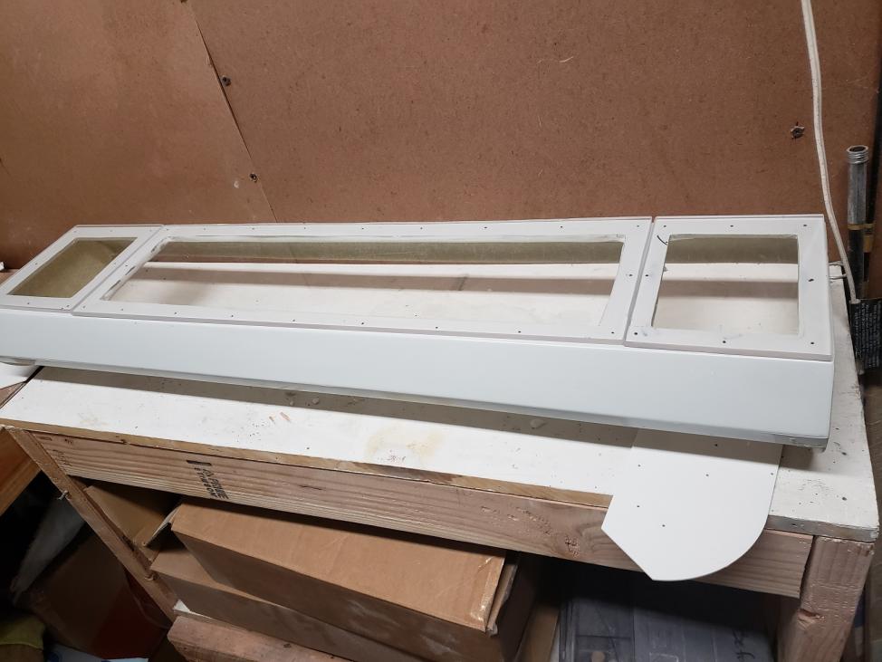

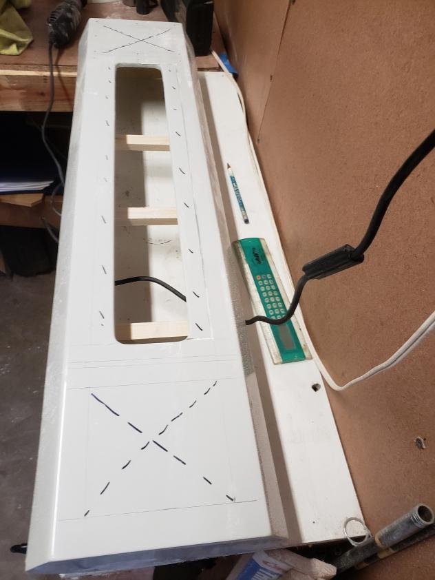

                first steps of measuring my cut outs .
                Put your mind to it. If there's a will there's a way!
                • deepseadiver
                  • 297

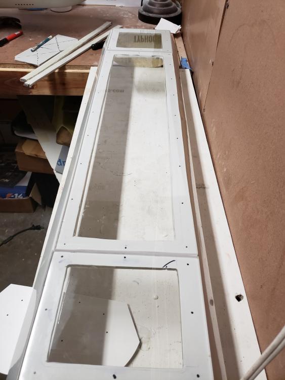

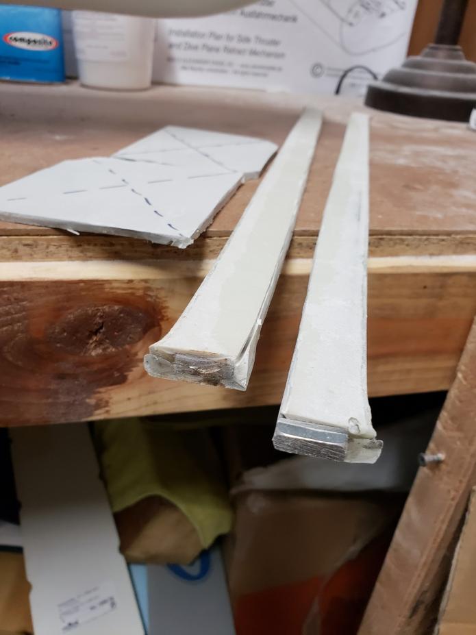

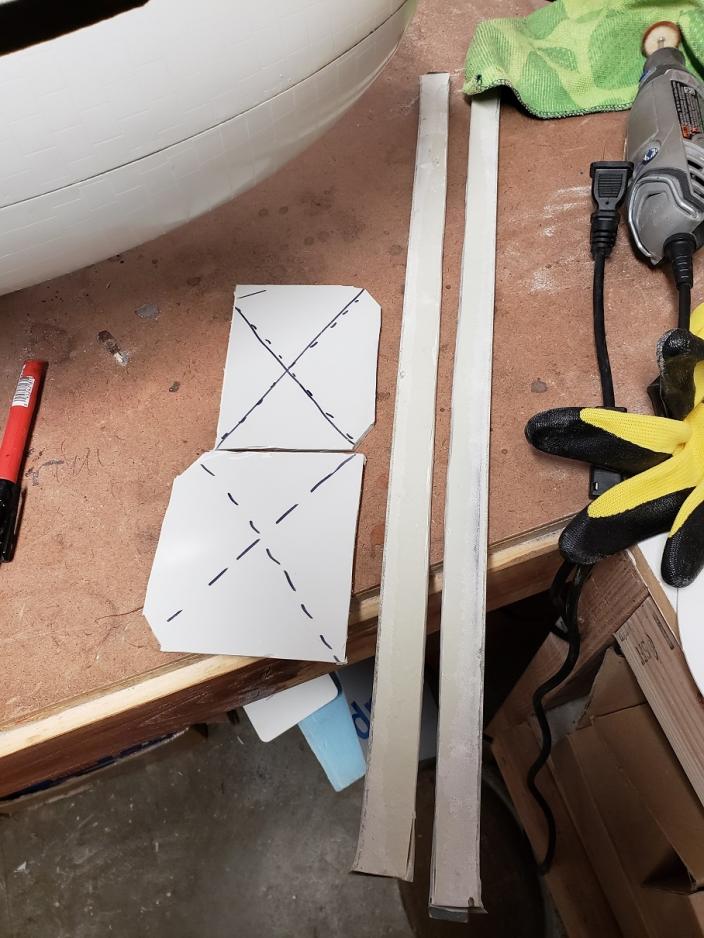

                  did my cut outs and I noticed to cut through the steel reinforcement I used my dermel with a metal cutting saw wheel, it cut through the steel like butter but lots of sparks flying everywhere. That was Fun !
                  Question for you bob and all that see this. Those two steel strips I took out have some weight to them since Engel design the boat to have that weight. Besides the lead shot that must be added as well. I think I may add that to the keel as a removal weight so if I need it I can add it right back to the keel center of boat. its about 1 1/2 pounds I would say . What do you think?

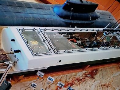

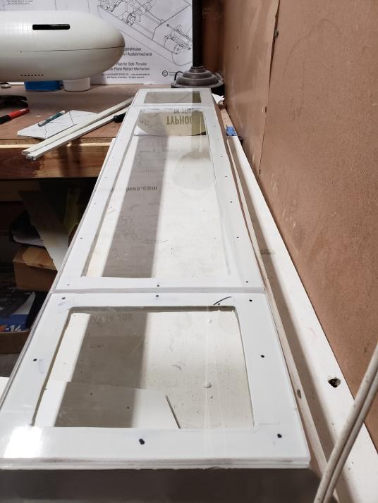

                    more pictures of the cut out top with clear acrylic viewing windows turned out perfect . I will be adding many more bolts then the little black dots you see. I am going out to buy 3/4 bolts with wing nuts that are stainless steel very soon. I need to get some more rubber sealing cord then what I got in the Engel kit I need much more. The picture that's bob's boat I really like the bolt pattern I will be copying it. 44 bolt pattern

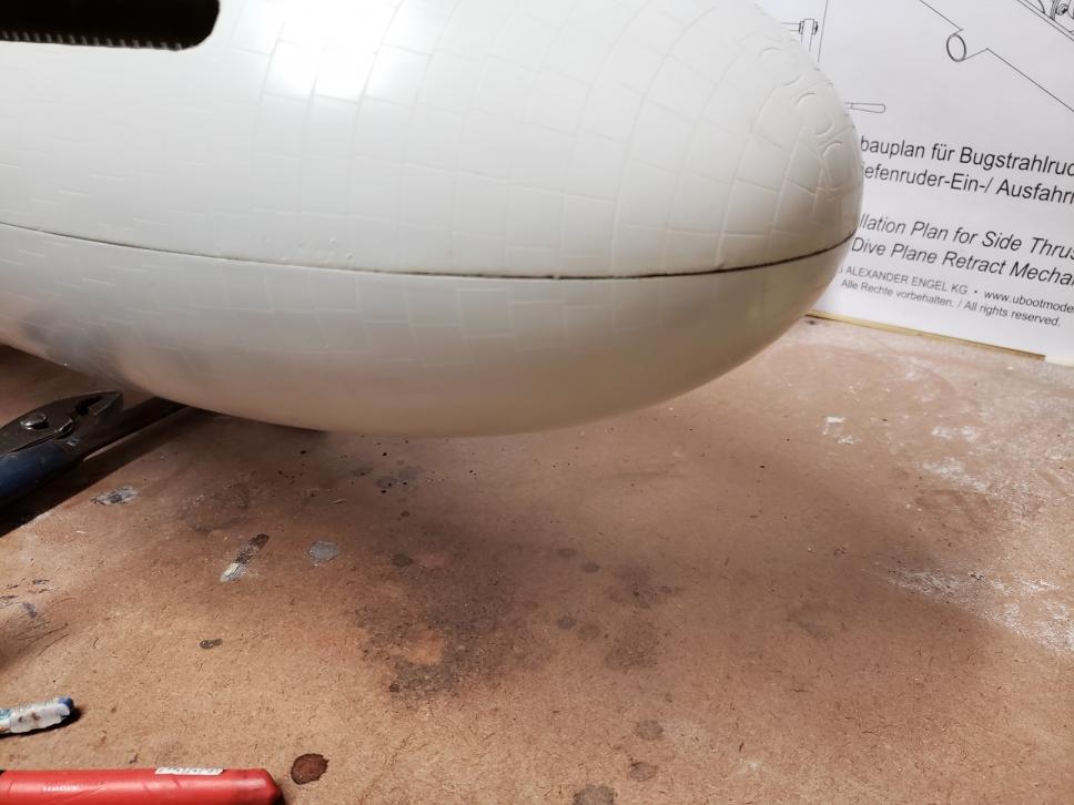

                        more pictures of build I don't really like the crack in the middle of the bows front half's maybe when its black that will be less noticeable or is there a way to make that smaller were should I sand. I have the hold down bolt all ready installed goes in from the bottom. maybe I will need to use some filler? ideas comments any one.
                        • rcgrsemunki
                          • Jan 2011
                          • 1
                          [QUOTE=deepseadiver;n128489]more pictures of build I don't really like the crack in the middle of the bows front half's maybe when its black that will be less noticeable or is there a way to make that smaller were should I sand. I have the hold down bolt all ready installed goes in from the bottom. maybe I will need to use some filler? ideas comments any one.[/QUOTE
                          I used automotive body filler to fill mine. Was a bit of a pain keeping it where I wanted it but it seemed to work out well.
                          • deepseadiver
                            • 297
                            Good old bondo stuff works great or I was thinking of using baking soda, and crazy, glue put those together you get a quick cement like material almost instantly then sand to shape . But I always consider using auto body as well . Thanks for the comment
                            jim
                              All the Engel Typhoon hulls have that gap at the bow, think it's a fault in the tooling.
                              Most builders fill it in, then extend the anechoic tile lines. Some have used an epoxy putty rather than polyester car filler. Epoxy putty is much tougher and resistant to chipping.
