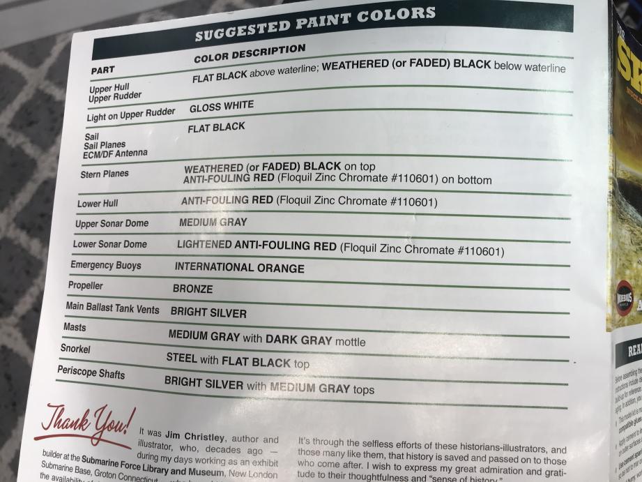

                            First coat of cloth/epoxy is on and drying. I’m looking way ahead. What paint, manufacturer, should I use? I have a new airbrush I can use. I’d assume most of the paint should be flat? Not sure the zinc chromate is available?

                              Ken,
                              Take a look at Revell’s suggestions: https://downloads.revell.de/Manuals-Modelkits/05119.pdf
                              David can speak to the accuracy of any of it.
