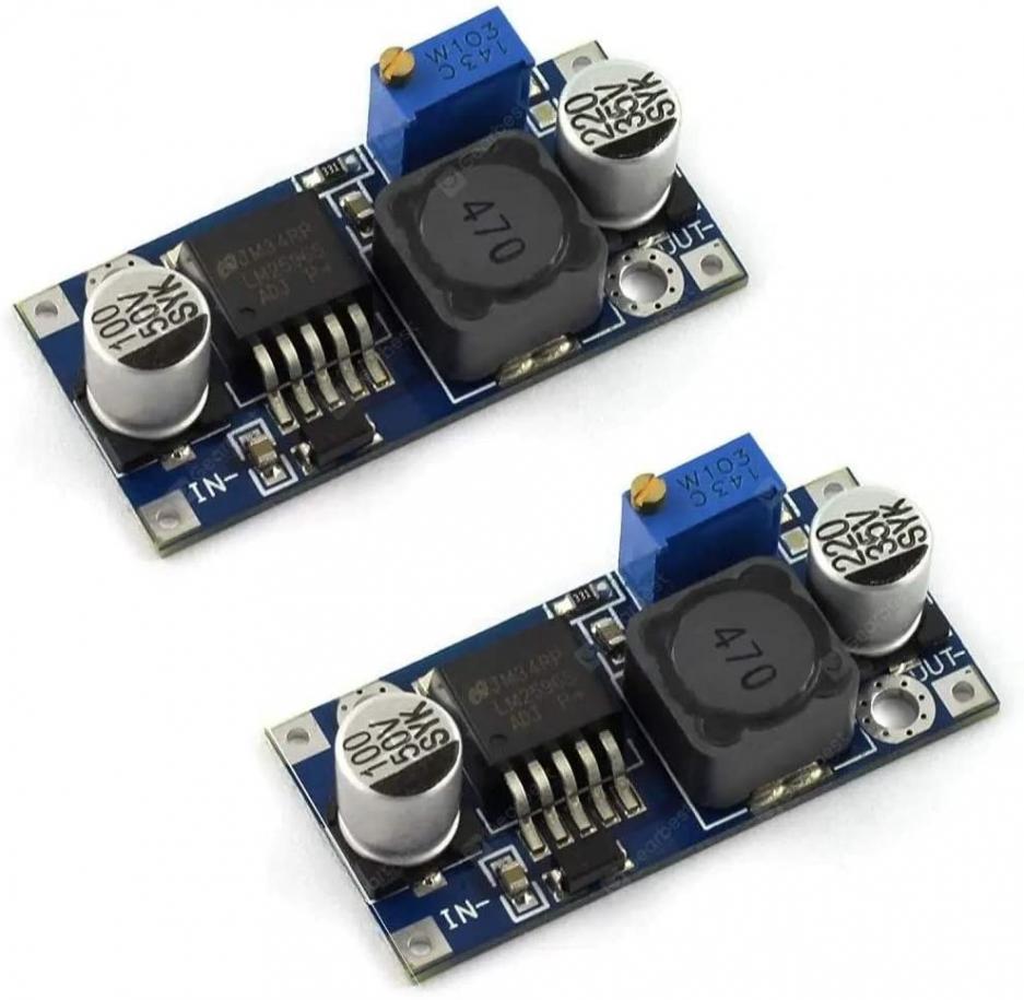

                Great video-tells all! If you are still on the hunt for a UBEC, I wonder if you could use a buck converter-I use them for accessories-they'll take up to 40 volts and hold it at your setting at least 1.3 volts below the input voltage regardless of changes in input voltage-they are quite cheap...and small. I've bought them for as low as 10 units for $7...dial in the voltage and it just stays and it doesn't waste power as heat. These are 3amps at $4 each-but if you shop around you can do better . https://www.amazon.com/LM2596-Conver...a-754523673785

                          Yea thought about those, they have some micro or mini ones. Just wondering how many different things I'd have to buy before I find the one that works, and how many of them will end up in my 'spare parts box'

                            Probably just one thing -a new ESC but if you want to try a buck converter, PM me your address-I'll mail you one

                                May try one of these.
                                Amazon.com: Buck Converter 12v to 5v, DROK Voltage Regulator Board DC 6.5-36V 24v Step Down to DC 1.2V-32V 12 v Volt Transformer Reducer 4.5A 75W CC CV Power Supply Module: Home Audio & Theater
