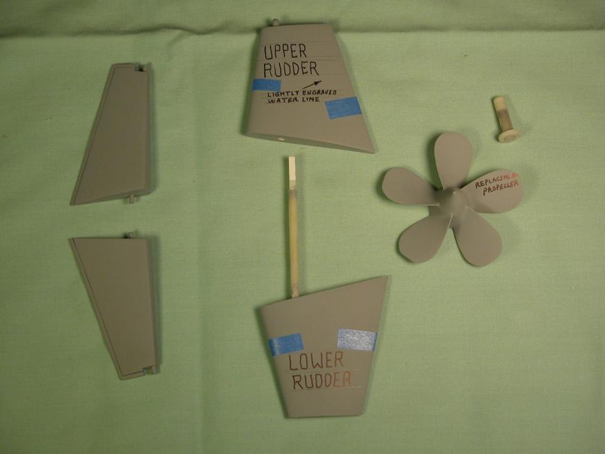

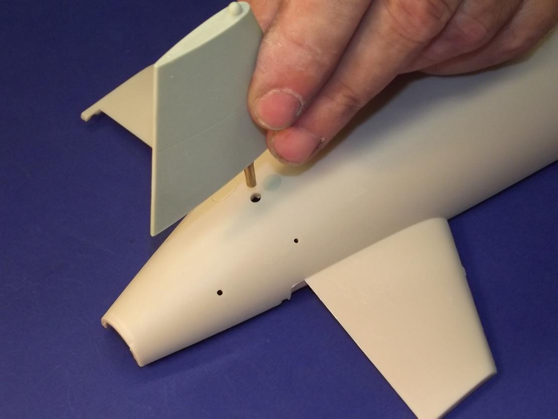

    I'm late to this party, but thought I'd chime in as I don't think it's too late. That control shaft should be able to be popped out with a pair of pliers and 3.5 seconds of work. I don't think the shaft is notched, so just a bit of rotary pressure and it will snap free of the resin. Pull it free, run up a tube for your lighting, and you're done.
    If it's being ornery, heat up the shaft tip with a torch and it will come free more easily.
    Bob
    No, that won't work in this case (I assume he's using my 1/72 SKIPJACK fittings kit).
    Prior to casting the resin end of the rudder operating shafts they were peened from cylindrical to flat to prevent independent rotation or removal of the operating shaft from the rudder.
    Removal will entail some rather ugly surgery and back-fill with a two-part filler.
