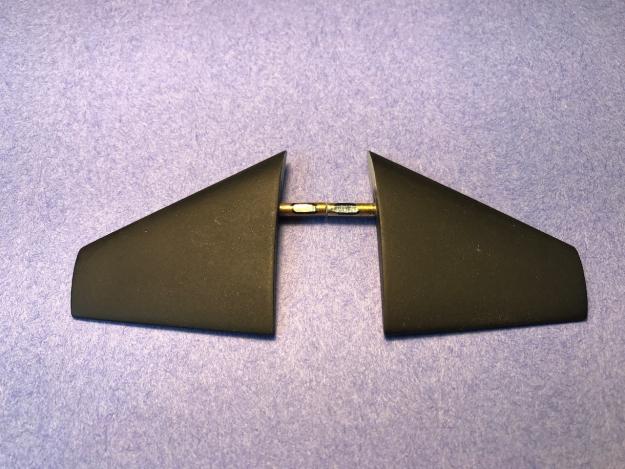

                Prior to going to Groton I lost one of my fairwater planes. David did not have any spares and Bob is not at that point of making resin parts. I took the original Moebius parts from the kit and prepped them. Made a shaft and put notches in it for epoxy, filled the voided space on both halves and clamped together. Next day sanded. You'll see them painted up in a later post. They feel solid, no hollow sound at all when tapping on them.
                On of the original resin planes, part of the fittings kit.

                  Also prior to Groton, the fairwaters had enough friction that the magnet from the servo would not hold on or move the planes, kept becoming separated. I made a small 1/16-3/32 long bearing from brass. Where the fairwaters shaft entered the sail on the inside, I use the correct size drill and hand reamed out that hole to fit this bearing. I did not go all the way thru, so the outside of the sail you do not see this bearing.
                  Click image for larger version  Name:	IMG_4365.jpeg Views:	0 Size:	64.1 KB ID:	162319
                  I then cut a spacer and carefully filed it down so it can be used to hold pressure against the bearings while they are being glued.
                  Click image for larger version  Name:	IMG_4367.jpeg Views:	0 Size:	57.2 KB ID:	162318
                  With the bearings in place, the spacer in place, the sail halves together, an alignment rod lined everything up. A few drops of CA was applied thru the bottom of the sail with a pointy thing onto the bearings on the inside of the sail to hold them in place. The sail was taken apart then a fillet of CA was added around the bearings.
                  Click image for larger version  Name:	IMG_4368.jpeg Views:	0 Size:	65.6 KB ID:	162321
                  The fillet of CA was then filed down to make the CA smoother. The fairwater gear as is fits exactly between the sail halves. I had to ream out the gear opening down to the set screw to accommodate the bearing. I also had to ream out a camfer so there was no binding with the CA fillet.
                  Click image for larger version  Name:	IMG_4370.jpeg Views:	0 Size:	58.8 KB ID:	162322
                  The new fairwater planes needed the forward part filed down so it did not interfere with the sail when at full dive or full surface.
                  Click image for larger version  Name:	IMG_4371.jpeg Views:	0 Size:	59.8 KB ID:	162323
                  Not shown, I also ground some flats where the set screws touch the shafts.

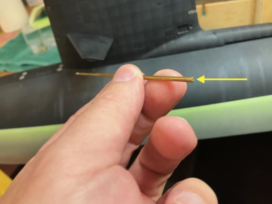

                      To activate the navigation lights I made my own periscope. The bottom is a tube and at the bottom of the tuber is 1/2x1/16 magnet, epoxied in place.
                      Click image for larger version  Name:	IMG_4390.jpeg Views:	0 Size:	51.5 KB ID:	162335
                      When I insert the scope it activates a reed switch which then turns on the nav lights. Essentially and on-off switch.
                      Under the rectangular foam is another reed switch. The foam is attached to a float with a magnet. When the boat is surfaced, the nav lights are on. When submerged, the float rises, deactivating the nav lights.
                      Also when the boat submerges, the same reed switch activates a safety location LED on the deck to help locate the model should it not rise to the surface.
                      Click image for larger version  Name:	IMG_4380.jpeg Views:	0 Size:	64.6 KB ID:	162338
                      Hand made micro periscope from brass.
                      Click image for larger version  Name:	IMG_4391.jpeg Views:	0 Size:	53.7 KB ID:	162334
