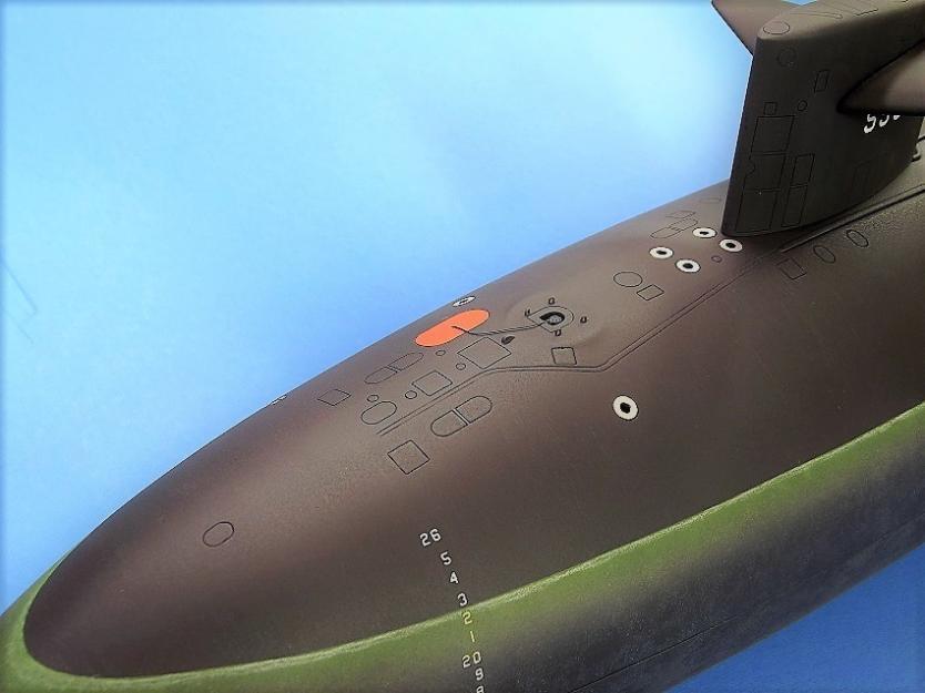

                        I sprayed the upper hull with Rustoleum charcoal gray primer. After two coats the primer had an unexpected fuzziness to it. What to do about that? So I used a scrubby pad and scrubbed the fuzziness away. Started looking pretty good. That's what you see in this picture. To me the result looks pretty good, that splotchy weathered look, I like it.
                        Then I used a 5000 grit foam sanding pad to 'polish' the scratches away from the scrubby pad. Looks like a decent weathered surface to me.
                        Another picture after 5000 grit pads in different lighting.
                        After Subfest I'll still be attempting the hull streaking and further weathering. But will practice on something I make up before attempting it on the SJ.
                          • 3752
                          #252
                          I think it looks good too. I may have to pick up a charcoal gray myself.
                            • 13979
                            #253
                            That 'splotchiness' likely resulted from an earlier coat going orange-peel on you, the high-points of the last coat scrubbed away by that abrasive leaving the slight discoloration between coats. A good effect below waterline, but I've never seen it above waterline. Above waterline it's a reasonably smooth surface with the prominent weathering being in the form of streaking.
