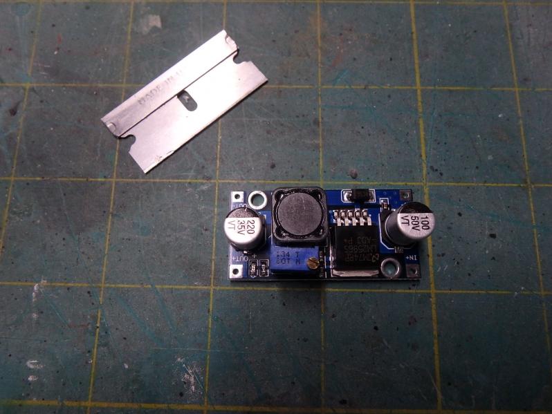

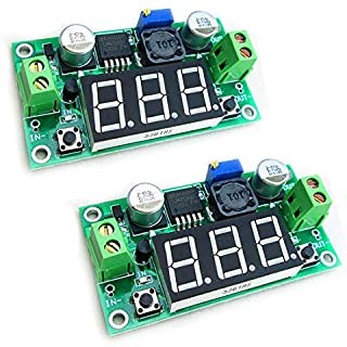

    RB-I think that's way too big (for home use) and bulky for a sub model and IMO too expensive the ones I am talking about are under a buck (pardon the pun) and if you want the voltage readout-they're under $5

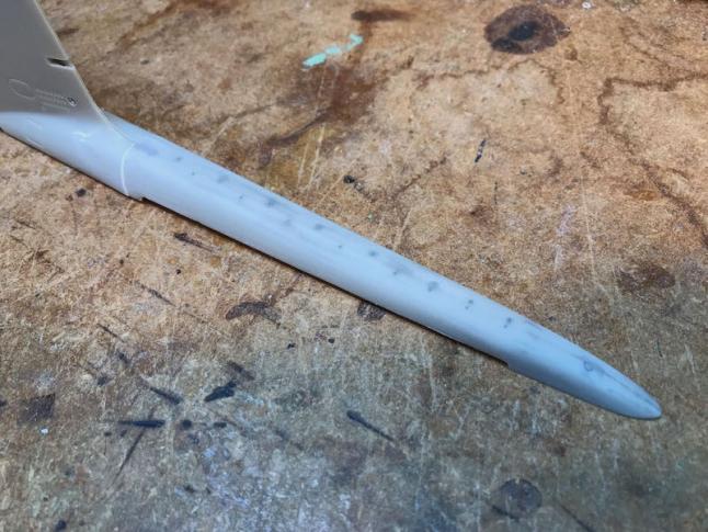

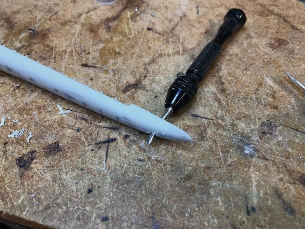

            Have some updates to post. Since I'm working on working deploy-able nav lights and other things in the sail I will need access for maintenance. So the sail parts will not be glued together. I made a cut in one half of the exhaust housing and glued it to the other half, filled in imperfections, added a block, and tapped it for a mounting bolt.
            Tapping an exhaust housing mounting hole. Did a thru hole so I can get threads deep into the block.
            The hole was then filled with baking soda and CA. Sanded smooth and again filled with Nitro-Stan to make sure there were no duvets.
            A section of the ribs were remove for a path for air to exit.
            And additional air exit hole was added before the hull joints (next to tapped hole) to allow trapped air to exit from the hull thru the exhaust housing then thru the sail. Note the tapped block for a hold down machine screw.
            Finished joint.
