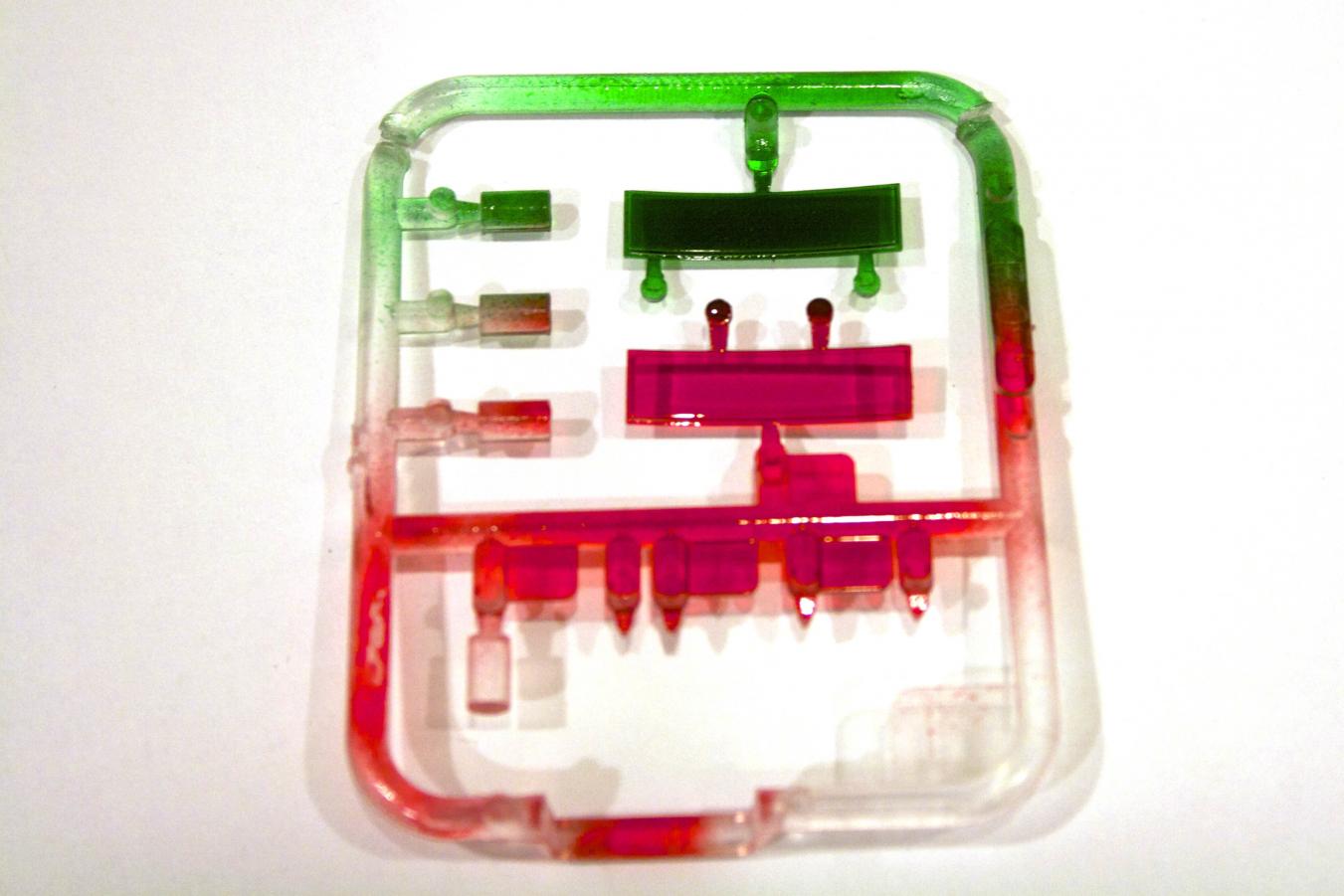

          Decided to go with colored glass versus colored bulb. So painted clear red and clear green on the light cover.

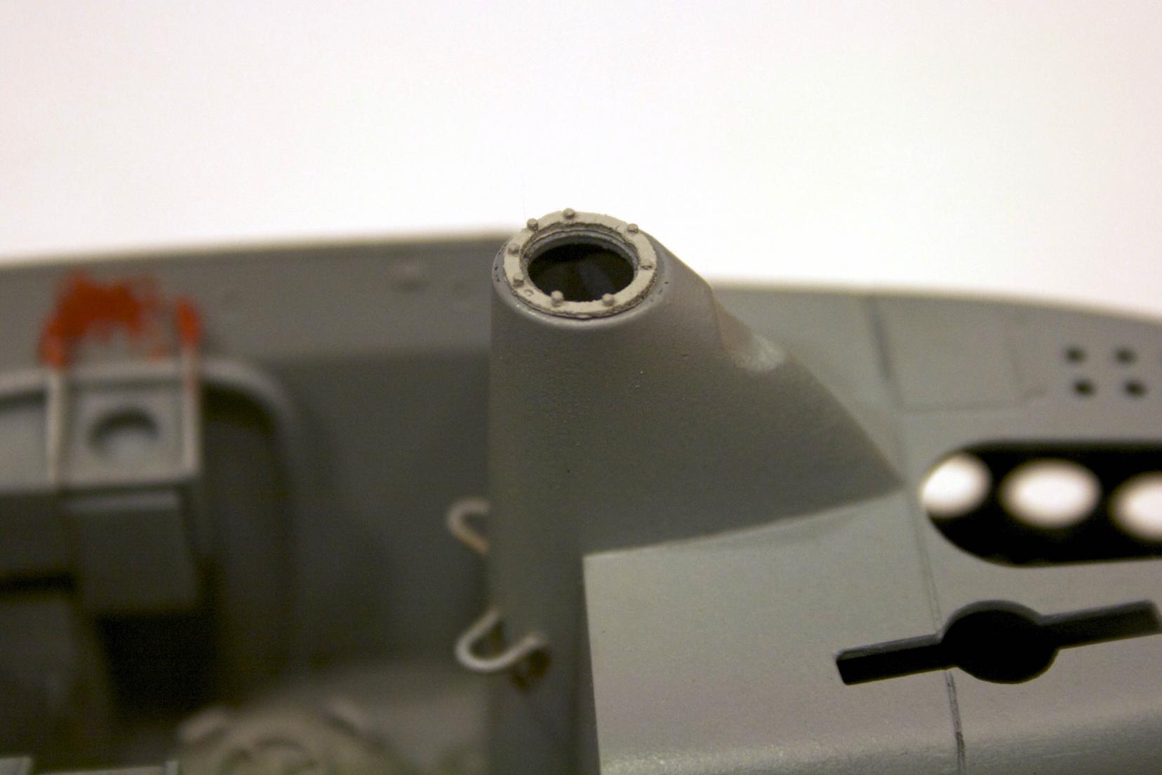

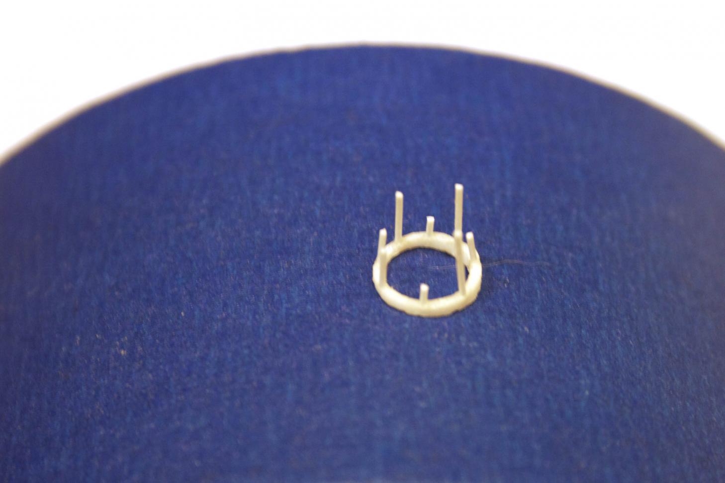

          Then I tried something silly. Could I drill a tiny hole on the edge of a plastic tube? then do it eight more times? and make them even?
          The short answer is yes, sorta, and no.
          I drilled .031" hole on the edge of the 5/16" plastic tube. id that eight time, but did not get them even. Stuck lengths of .030" rods in and glued them in.
Name:	Bronco Type 23_303.jpg
          Let it set completely. Then trimmed the rods and sanded the bolts as well as thinned the base.
Name:	Bronco Type 23_304.jpg
          It will work for me.

            Looks like a flange to me!!
            Good trick, Tom!!
            Gotta remember that one!
            CG

              If you used heat stretched styrene rods with hexagonal cross section you'll get bolt heads.

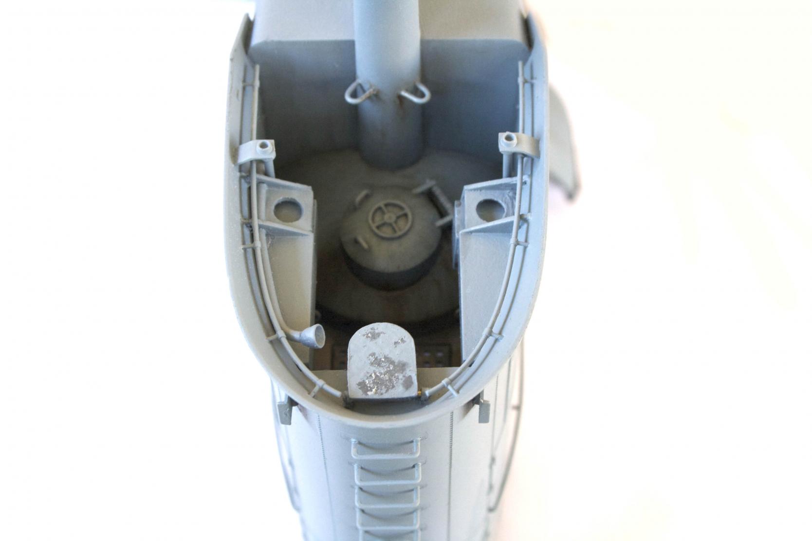

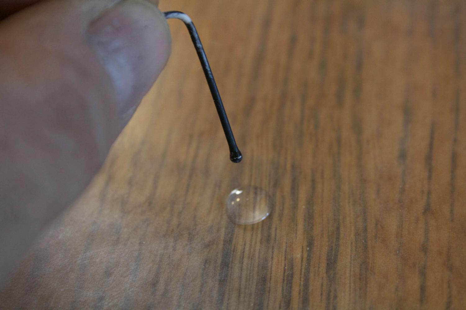

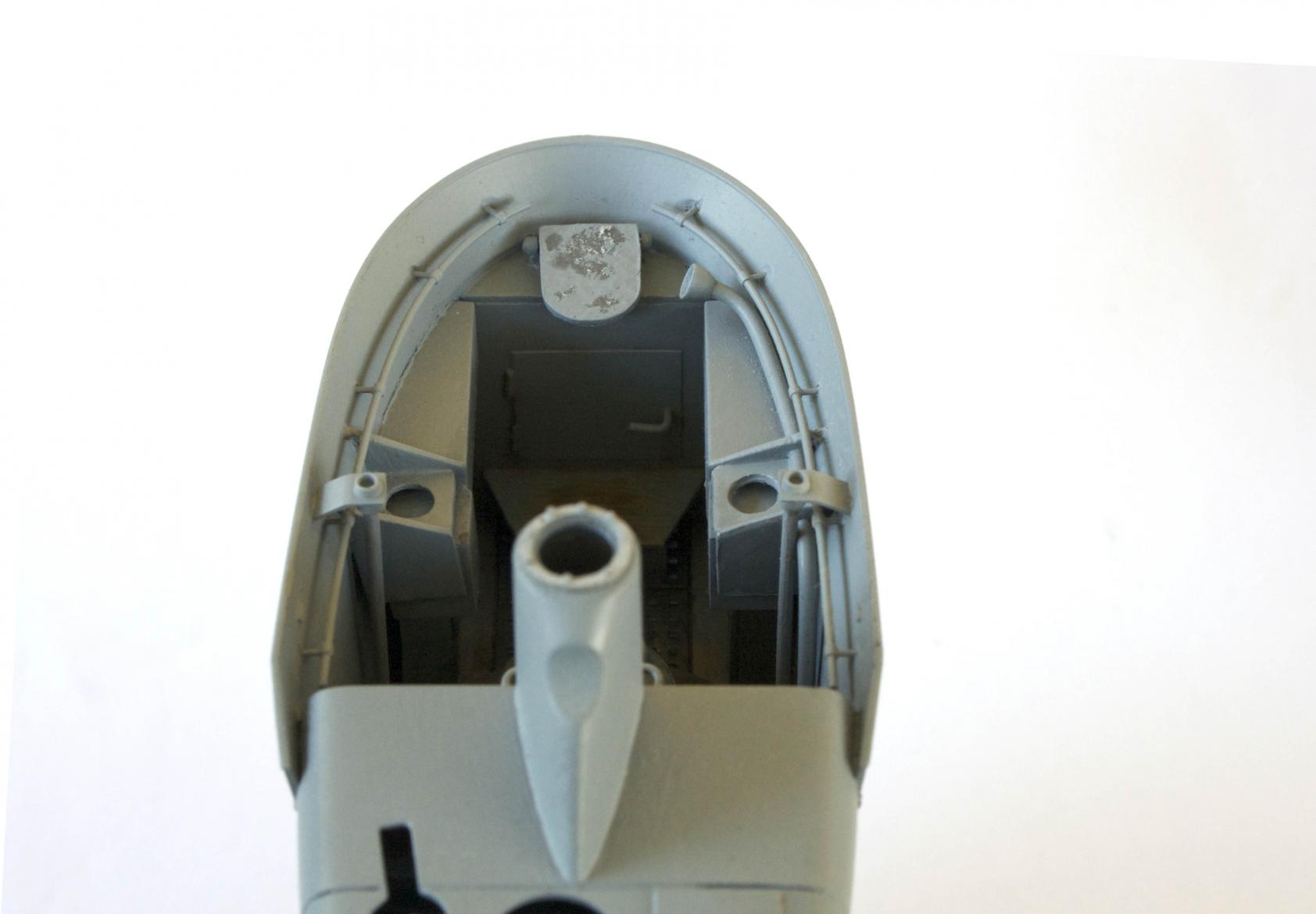

                        Began by melting the tip under a flame. I quickly saw that was not going to work. Then I used a thick CA to round out the tip, it seemed to catch the melted part and make a nice bulb. Then this morning I needed to dip it in the thin because of a bubble. O.K. slot machine handle set aside to dry.
                        Installed railing and antenna base. Broke external railing (twice). I just know that these details I am doing might last a patrol or two, but probably not much more. Antennas will disappear, poles will break, but for one patrol it will look good.
Name:	Bronco Type 23_306.jpg
Name:	Bronco Type 23_307.jpg
