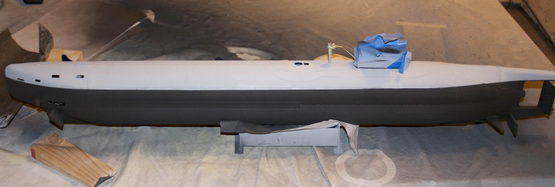

          Still working on it. In between life happenings.....I get bits of work done.
          Did a bunch of sanding and reconstructing weld lines (which are washed out by the flash). The light gray came out a lot lighter than I wanted, so I will redo that. The bottom base coat will work. It is not black, but a very deep, dark gray. The new upper deck color will clean up the lower dark gray paint.

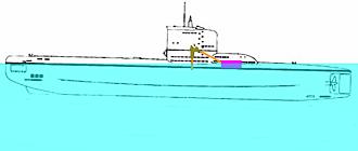

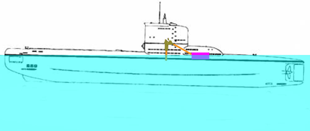

                Thank you David. That was to give enough room for the float to drop because of the angle I have the sub sitting in the water. Here is a crayon drawing.

                  • 13982
                  #173
                  Why are you going with the ass-heavy waterline?

                    #174
                    Nice "crayon" work there, Tom!!
                    Stayed inside the lines and everything!! Hah!!

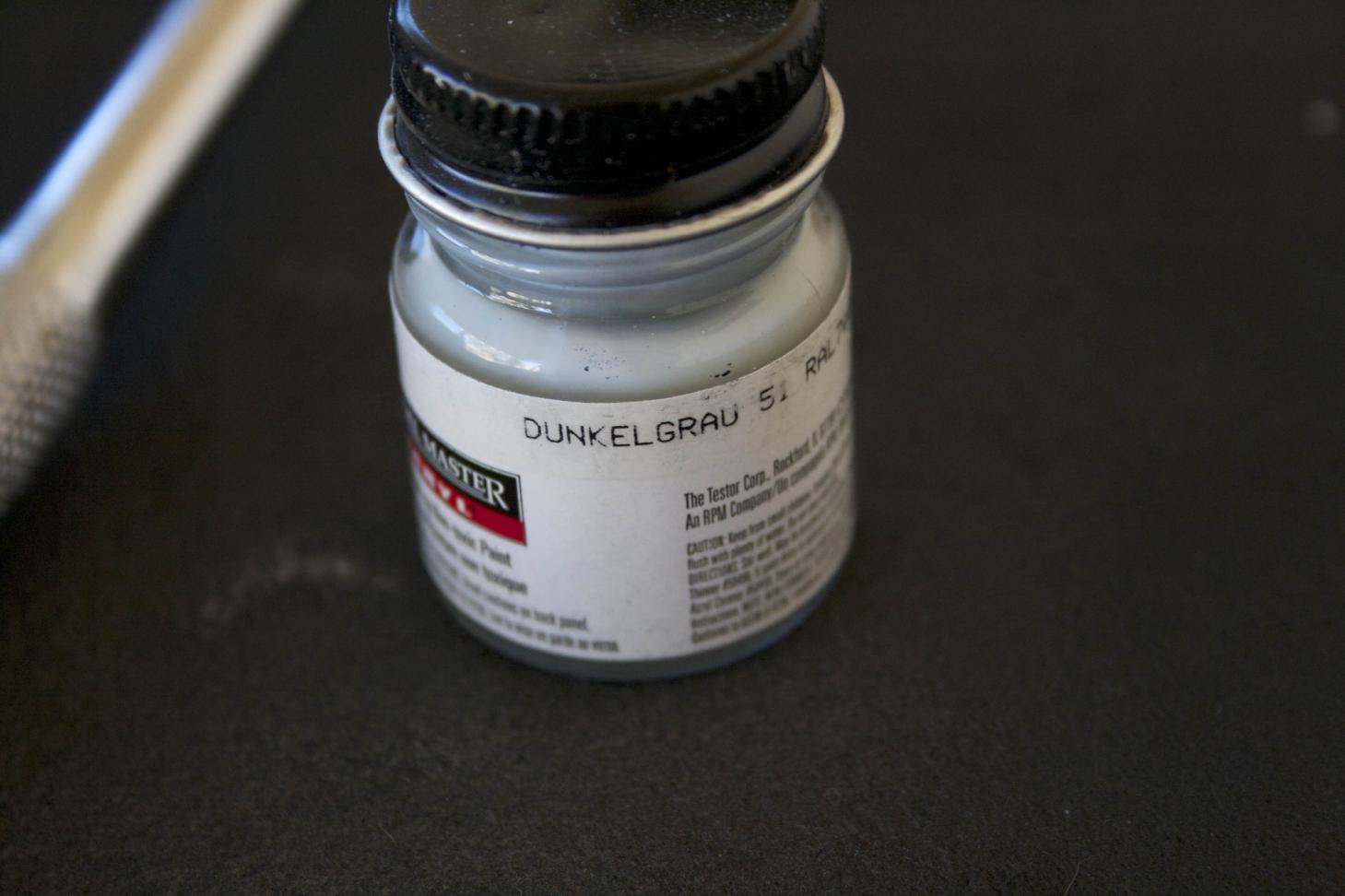

                            Here is the new gray (Dunkelgrau 51) on the deck compared to the plastic color. The original gray I used was way too light (almost looked white in certain lighting conditions).
Name:	Bronco Type 23_255.jpg

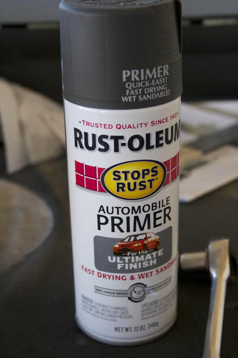

                            The hull base coat is this rattle can. It is a nice dark gray (or grey for our friends across the pond)
Name:	Bronco Type 23_257.jpg

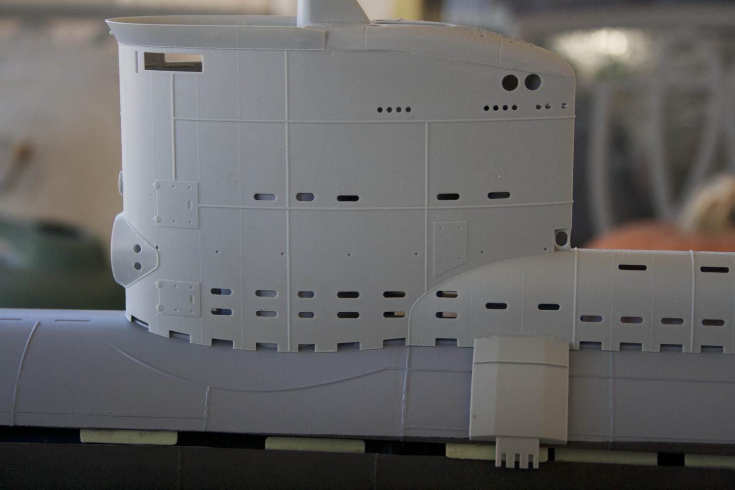

                            Other than that began painting periscope (should I make a mold of the scope just in case it gets knocked off some day?), I am not thrilled by the boxy look of the scope. Did it really look like that?
                            Anyways putting stuff on and will document later.
                              • 1649
                              #179
                              Tom,
                              I still have to wait for next spring for painting, don't have a sprayboot, i have primergrey in stock for the upperpart, and darkgrey for under the waterline.
                              As for your scope, it looks the same as the attack scope of the type VII or IX, scrap the one of Bronco and make one of your own.
                                • 3757
                                #180
                                Manfred,
                                Sorry we are at 77F or 25C so very nice for painting. Thank you for the information on the scope, will build a new one.
