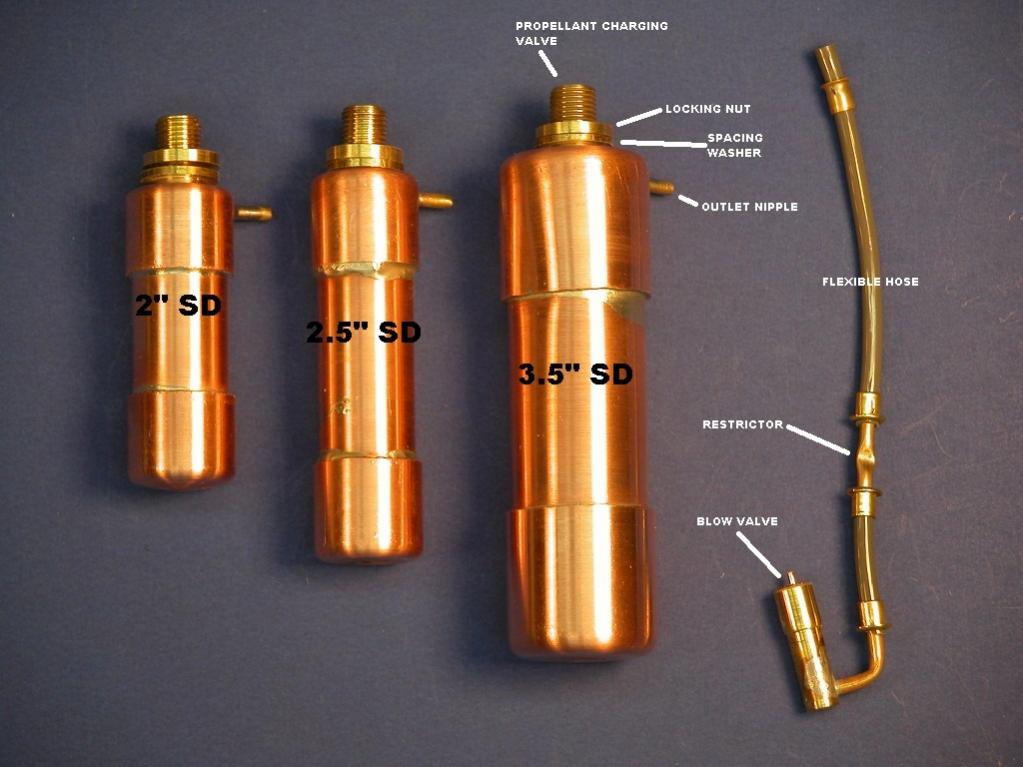

                                The boat went 'deep', past the point where the very small amount of built-in reserve buoyancy of the submerged boat is canceled by box-compression -- deeper and the boat is negatively buoyant; the LPB refused to run when commanded; the boat grounds and could not be dynamically driven to the surface.
                                Likely, during the recovery attempt at the transmitter -- working blind, the boat was driven outside the recovery diver's search pattern.
                                Game over.
ID:	91764 An emergency 'bail-out bottle', now in development as an optional retro-fit for SAS type SD's. This item recommended for deep-water operation. This emergency gas blow feature, activated only by fail-safe, would have saved this boat. Existing SD's have provisions to accept this retrofit with little effort.
                                Hind-sight is 20/20.
