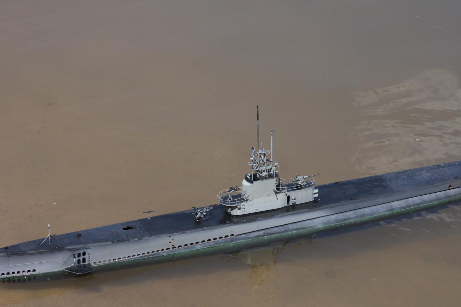

                              I ran it on Friday and at the very end of my run the pump stopped working. No smoke or smell of a burned motor. I could see the green light working, but still no pump. If I sucked on the tube, it would free up and begin running. I tried to flush the motor out and tested it. It seemed to work fine. On Saturday, I took the sub out and was able to run her. Surfacing and diving, surfacing and diving, boy that sub looked good, then I dove her a little deeper than I wanted tried to fire the pump to empty the tank, but she kept going down and the pump did not bring her up. I did an all stop. Tried a whole bunch of maneuvers to bring it up, but nothing. I thought the dive would have found it, but he did not. He tried also on Sunday.
                              I should not have run with a possible bad pump. I should have followed good safe practices.
                              The Gato ran well. It did a funky dive (like a surface boat attendee turned on his radio), but the gas system brought it up. My heart did not do so well. Visions of another diver came to mind. Since then I did not want to run the Skipjack or Gato. Lost my confidence.
