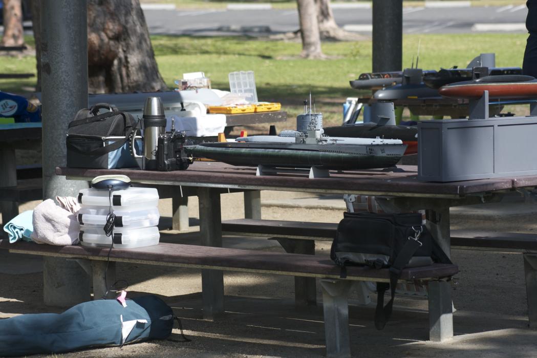

      So the Type XXIII did not run but 10 feet (maybe 15') from the shore and died. Stopped in the water. No response from the radio. A tug brought it in closer to shore (which by the time it was brought in I had several theories what had happened) and then I had signal again. The prop was strong so it was not the battery. Moved it along the shore and about the same distance it stopped again. This time I moved the TX until the sub began responding and brought her in. By the shoreline and me standing over it, I wanted to test other things like diving and surfacing. With all the do-dads and that heavy periscope, the aft would drop quickly. Manually getting the bubbles out made the sub still slightly aft heavy, but the water was over the tower.
      No pictures of the Type XXIII were taken of the time in the water because my son took the camera to take photos of other things around the water.
      All in all, the Sub-Driver performed well, even though I did not. Each sub was dry (even the Skipjack and the scary dive). So that was good news to me.

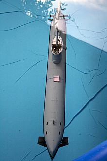

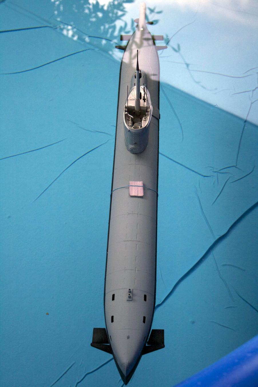

      Only a few pictures of the sub, here are two (no broken bits during the transport or time there!)
ID:	91154Click image for larger version
      More to follow as I run some post mission checks.

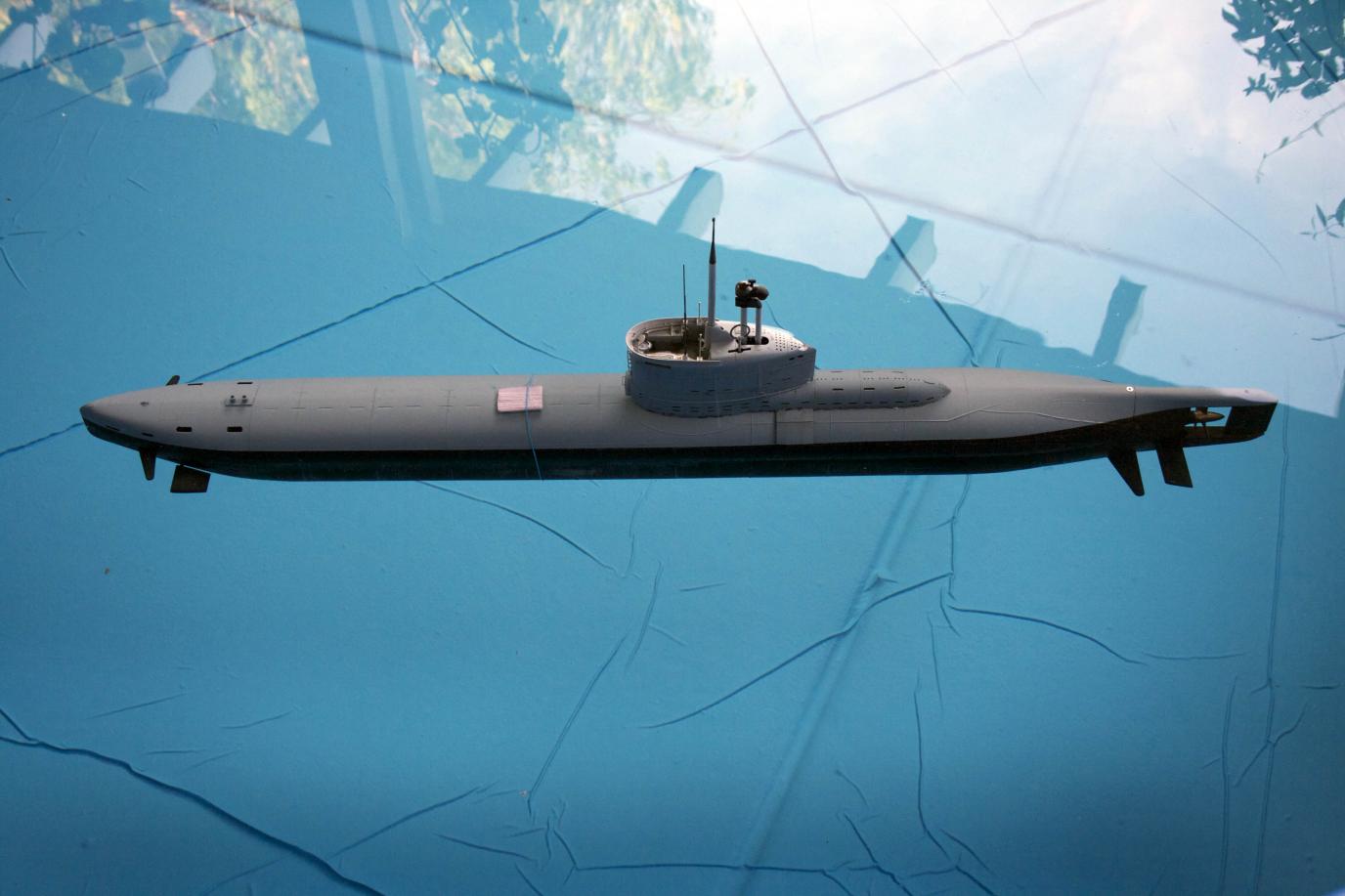

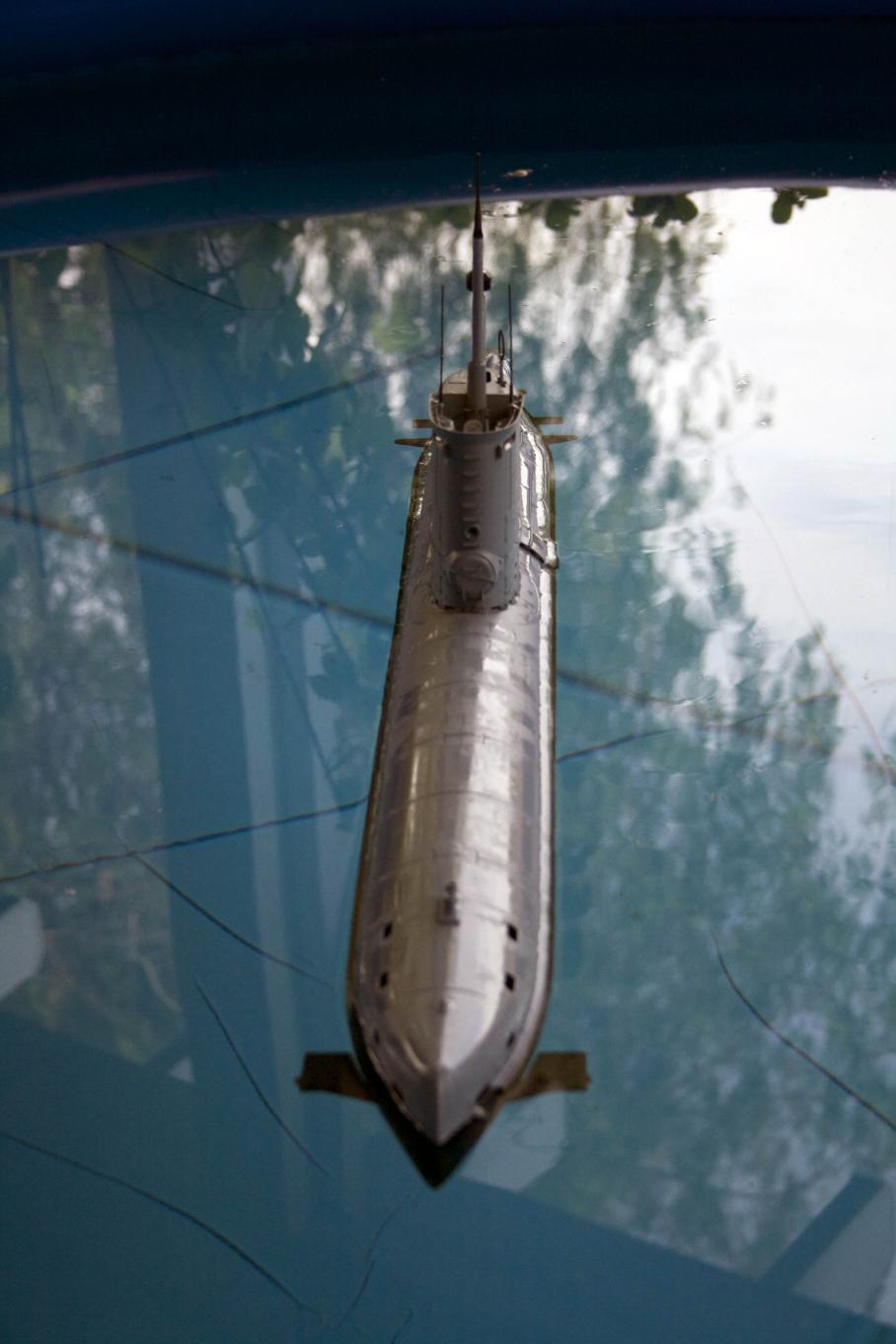

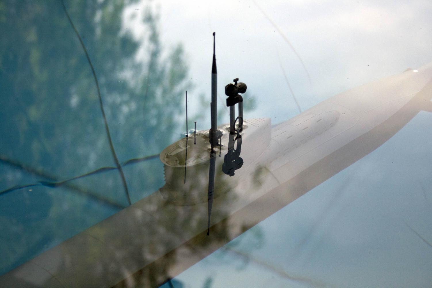

                    #294
                    I went ahead and replaced the receiver with another Wfly one, one the antenna is not cut and using the external antenna.
                    The sub is a little heavy in the aft and would not empty that last bubble in the bow.
Name:	Bronco Type 23_318.jpg

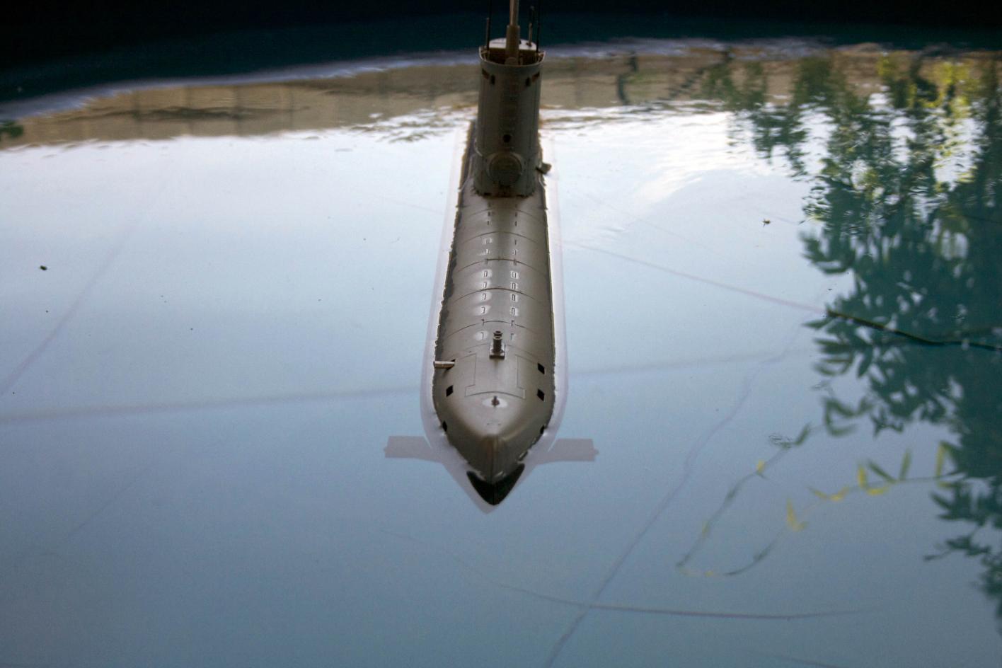

                    Here is is submerged after I got the bubble out. It was still a little bow light. Just a smidgin.
Name:	Bronco Type 23_319.jpg

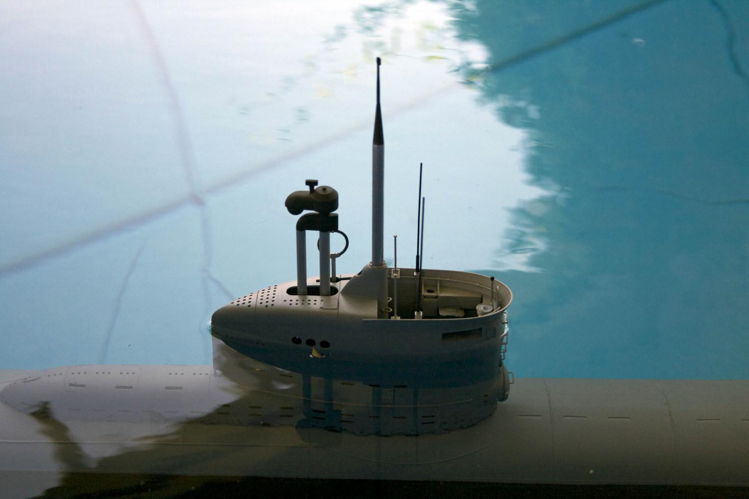

                    I like the height of the tower out of the water.
Name:	Bronco Type 23_320.jpg
                    There was a list to port side. Placing the weight on the starboard side, the hll was level. The tower was still tilted. I need to redo the mounting block.
Name:	Bronco Type 23_321.jpg
                    A little tug and the block came away cleanly. Butting it back on was not as easy and I opened a hole to apply CA to affix the mount.
Name:	Bronco Type 23_322.jpg
                    Once everything dried, I set it in to test it. The tower is upright and the hull is level.
Name:	Bronco Type 23_323.jpg

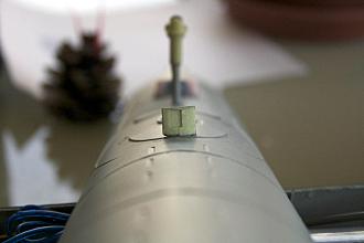

                    However, the weight now made the sub settle a bit deeper than before. Why? Who knows.But here is how it sits.
Name:	Bronco Type 23_324.jpg
ID:	91193Click image for larger version
Name:	Bronco Type 23_325.jpg
                    Sitting this low it is one bubble from sinking of going negative buoyancy. So a slice of foam is added to bring up the tower a bit.
Name:	Bronco Type 23_326.jpg
Name:	Bronco Type 23_327.jpg
                    There is a little room. Not sure if it is enough, but for now I will test it and see.
Name:	Bronco Type 23_328.jpg

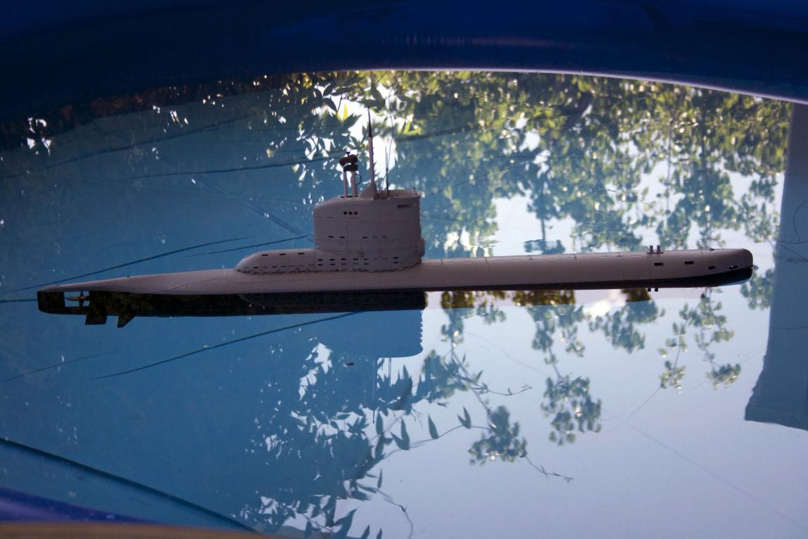

                    On the surface, it sits were I like it.
Name:	Bronco Type 23_329.jpg
                    Once the foam is set. Another test and then the pond.

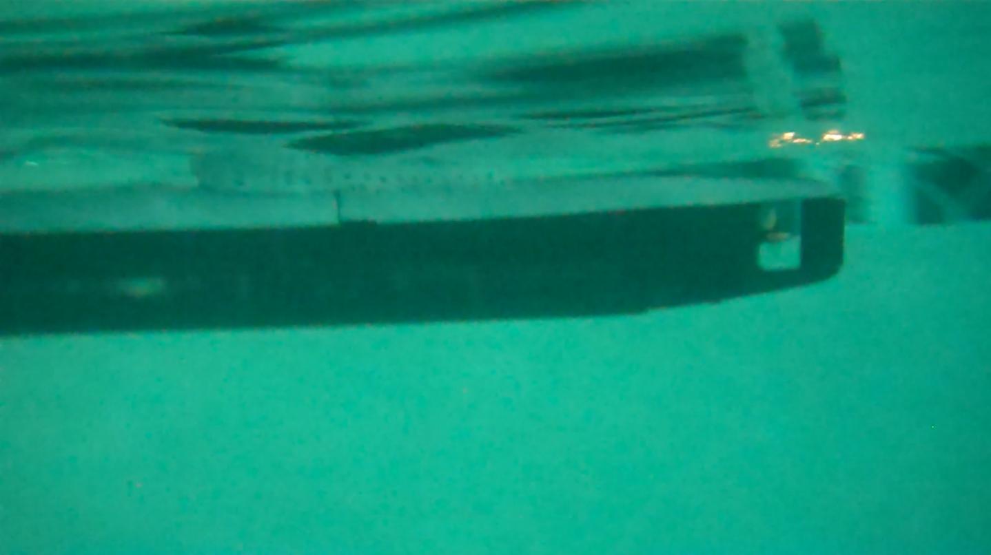

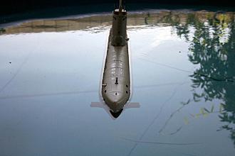

                                #300

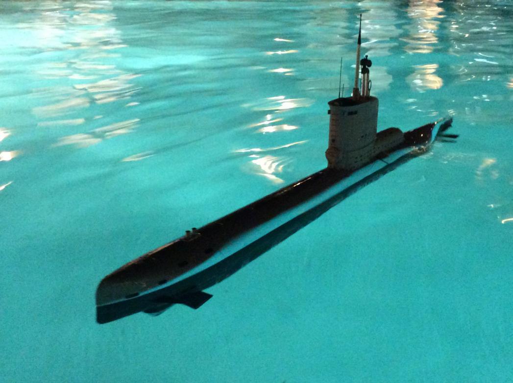

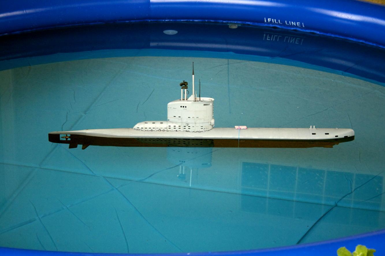

                                Took it to the pool last night.
Name:	Bronco Type 23_330.jpg

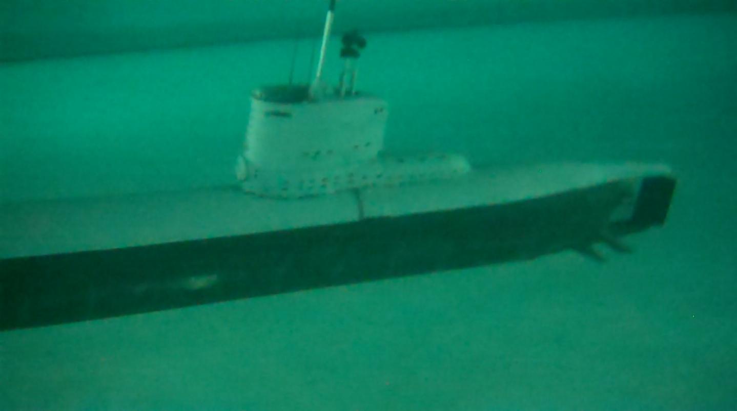

                                It went well for the most part - i love how these conditional statements pop up - until the rudder issue that Mark mentioned pulled up. More later.

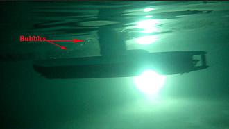

                                Mentioned to Manfred about how the sub sits on the surface with the aft lower.
Name:	Bronco Type 23_332.jpg

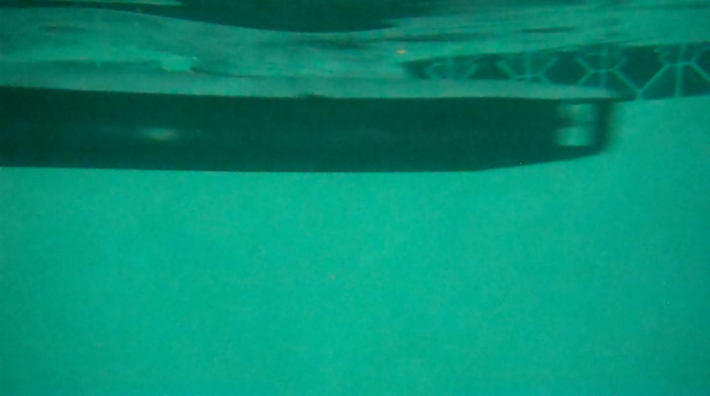

                                Sorry about the quality, the video was particularly shaky. Who knew shots of espresso would effect him so (joking). So, once it accelerates a bit, not much, the aft will rise.
Name:	Bronco Type 23_333.jpg

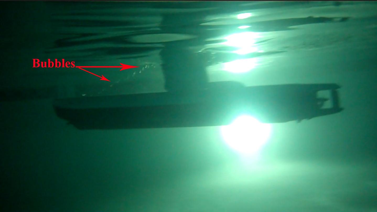

                                Then the bubbles start being released.
Name:	Bronco Type 23_334.jpg
                                Then it runs nice.
Name:	Bronco Type 23_335.jpg
                                Now the rudder got looser as the night went on until it could not make the turn within the pool. Time to stop.
