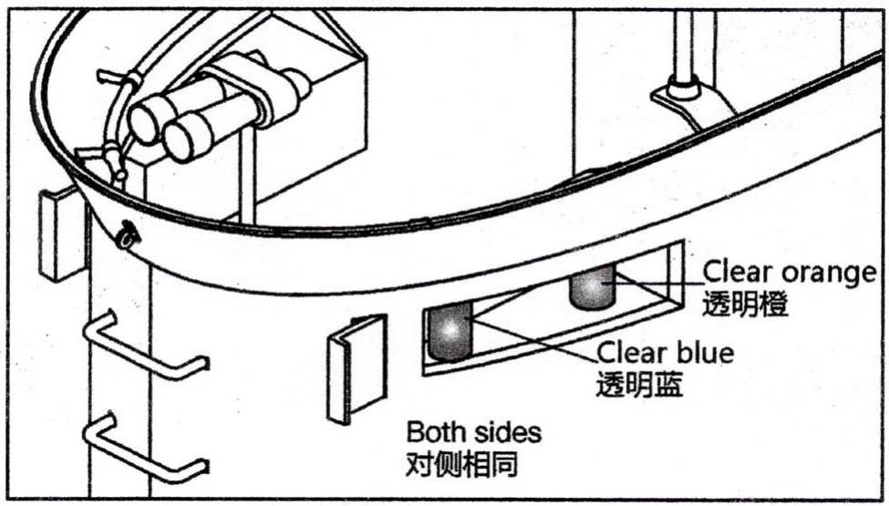

          Traditional navigation lights have red on the port side and green on the starboard side, what is the blue light? Does the XXIII not use traditional Navigation lights?
          Also, this sub looks black, were they painted black?

                Just a bump. Any information on navigation lights. Did the Type XXIII use standard navigation lights? If not what was this they were using?
                Here is what the instructions say:

                          Hopefully I will get a chance to finish the weld lines this weekend. So no thoughts on lights..... I will go with red/green then.
                            [ATTACH=CONFIG]25821[/ATTACH]
                            Just a note. I could not upload pictures using the standard way, I had to use basic uploader. Not sure if others are having the same issue or not.
                            Navigation lights on XXIII - Red on port side, Green on starboard side, White on rear. Just like other Uboats.. Front boats had the bulbs removed, so no functional lights on a front boat..
                            Have no idea what Bronco was doing with their Orange and Blue stuff in the instructions.. Maybe that was on the XXIII boat, renamed "Sea Dragon", that was given to China, by the British, after the war..
                            Your "Black" XXIII photo of U2329, that you posted earlier, is most likely just dark grey, not black. That photo was taken, at Loch Ryan, off the coast of Scotland. U2329 was among the Operation Deadlight casualties. Any time you see the boat numbers painted on the tower like that, it means the boat is no longer in German hands. It was tagged for orderly disposal by the Brits.
                              U2329 was one of the 6 boats to actually go on a war patrol..
                              How long was the last Type XXIII still in service? Isn't a flashing "Orange/Amber" light now used to indicate a submarine underway? The blue could be describing a "law enforcement" flashing light? Was this thing used to patrol littoral areas for the Chinese Coast Guard or something. I've been noticing these submariners can really be sneaky. While checking various pictures of submarines, I sometimes noticed a dual radar system. One is usually the military system and then the other is appears to be a generic commercial nav radar found on yachts and the like. Makes one think...hmmm?
                                #150
                                Thank you Warpatroller, great information.
                                Sublime, there were two that were in service in the 1960's. U 2367 was raised in the mid 50's and renumbered S 171 called U-Hecht and the other was U 2365 also raised in the mid 50's and was renumbered S 170 and called U-Hai. The Hai sunk in 1967, killing all but one crew member and the Hecht was decommissioned a year later. These two subs were modified when made fit to sail. They were extended about 14' to accommodate new engines and equipment. Later they modified the sail to one that is sloping on the aft end. The other Type XXIIIs that survived the war, I am not sure the latest they ran until. The Sea Dragon that Warpatroller mentioned, I need to research.
