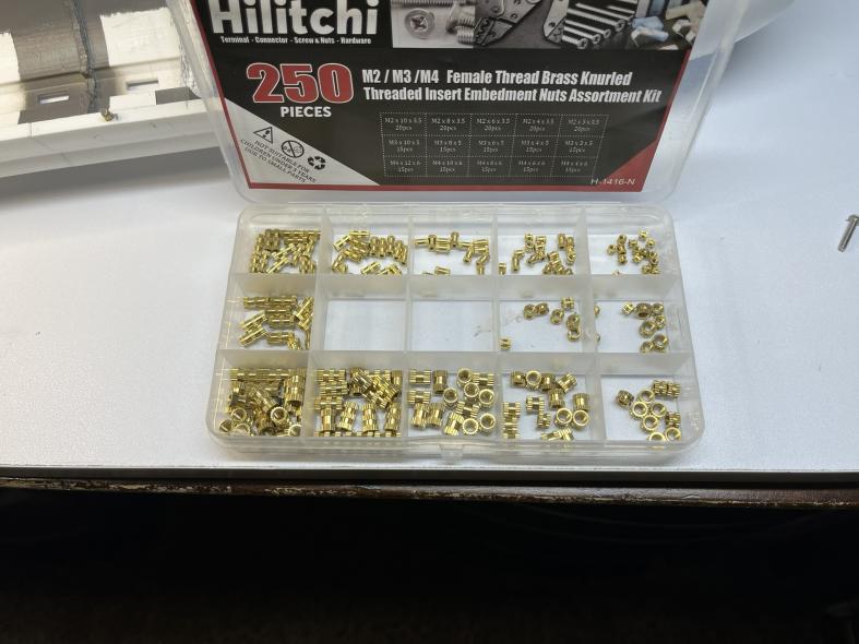

        Rob, can you direct me to where you purchased the inserts and screws?
        Bruce
        Hi Bruce,
Name:	GERMAN 212 A 75.jpg
Name:	GERMAN 212 A 76.jpg
        These are the brass inserts that I use. I got them off Amazon. Using these in PLA is quite simple. I bore a hole just a little smaller than the brass insert, and then I use a standard 30 watt soldering iron with the heated point, push the insert into the hole, but DO NOT let the iron sit to long, just enough to get the insert into the hole. I then apply THIN CA very carefully around the edge not to get any CA into the threads.
        Hopes this helps Bruce!
        "Firemen can stand the heat."

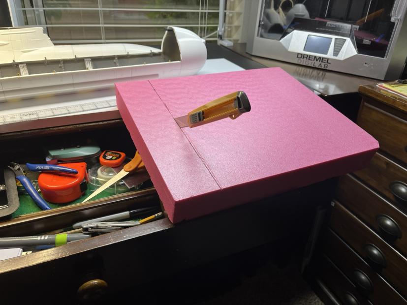

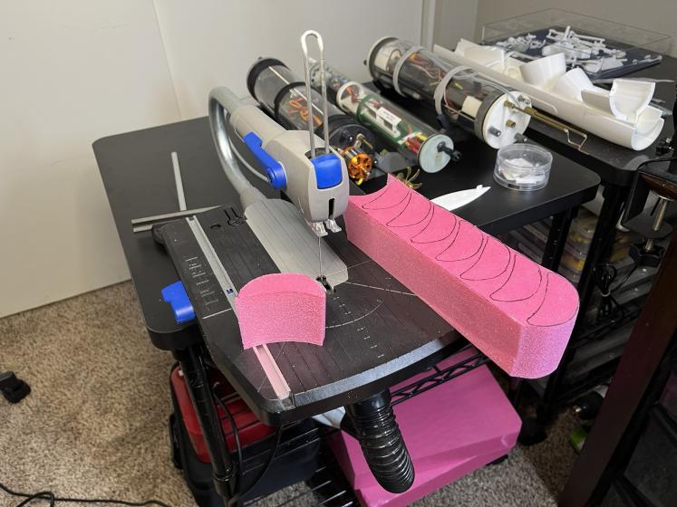

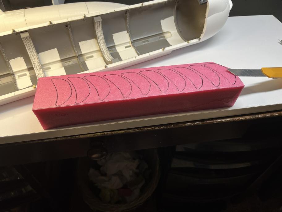

            Today looked like it was going to be a challenging day for sure!
            Click image for larger version  Name:	German 212 A 77.jpg Views:	0 Size:	61.9 KB ID:	179264 Click image for larger version  Name:	GERMAN 212 A 82.jpg Views:	0 Size:	52.8 KB ID:	179265
            I was going to start cutting the floatation foam for the upper hull of the 212. I am using one of those sectional thin bladed box knives. When I started the first cut, I knew I was going to be in trouble. I just turned 80 years old yesterday, my eyesight is not the best anymore, and I take Eliquis 2 times a day. For those of you that may not know what Eliquis is, well it is a blood thinner. Not a good combination here for sure.. :-((

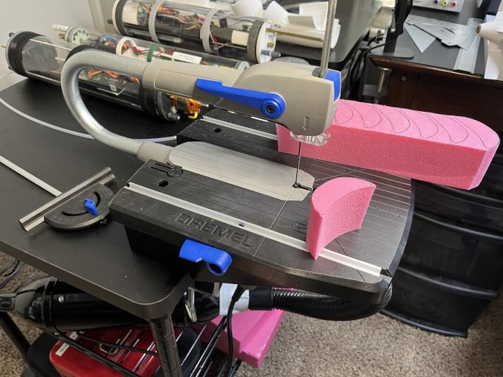

            I had just started the cutting process, when in walked my wonderful wife, and her statement was! This looks like a trip to the ER for sure.
            Click image for larger version  Name:	GERMAN 212 A 79.jpg Views:	0 Size:	64.1 KB ID:	179266 Click image for larger version  Name:	GERMAN 212 A 80.jpg Views:	0 Size:	66.7 KB ID:	179267
            She then presented me with a wonderful Dremel Scroll Saw!:-))
            This saw attaches to a desk top, and with a small hand vac that I had, it made a perfect saw for cutting out the foam pieces that I needed.
            Click image for larger version  Name:	GERMAN 212 A 81.jpg Views:	0 Size:	56.1 KB ID:	179268
            I did get a little carried away with cutting the foam pieces. Never know when I might need more of them. My wife really surprised me, and saved the day! She may have also saved a severed artery, and a trip to the ER.... :-))

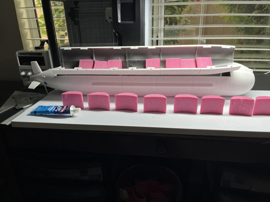

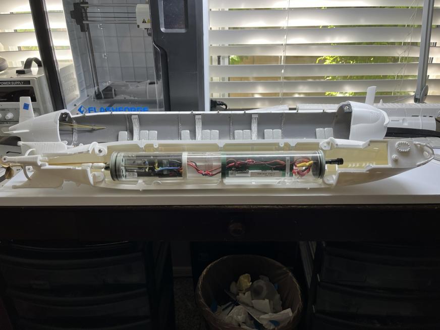

                      I finished the installation of the foam inside the upper hull. I also gave it a coat of spray paint to sort of clean up the look.
Name:	GERMAN 212 A 84.jpg
                      I Have the weights set out and ready for installation. I will be using Loctite clear silicone waterproof sealant, did some sample glue ups, and it works great. Same as what I used on the foam
                      installation.

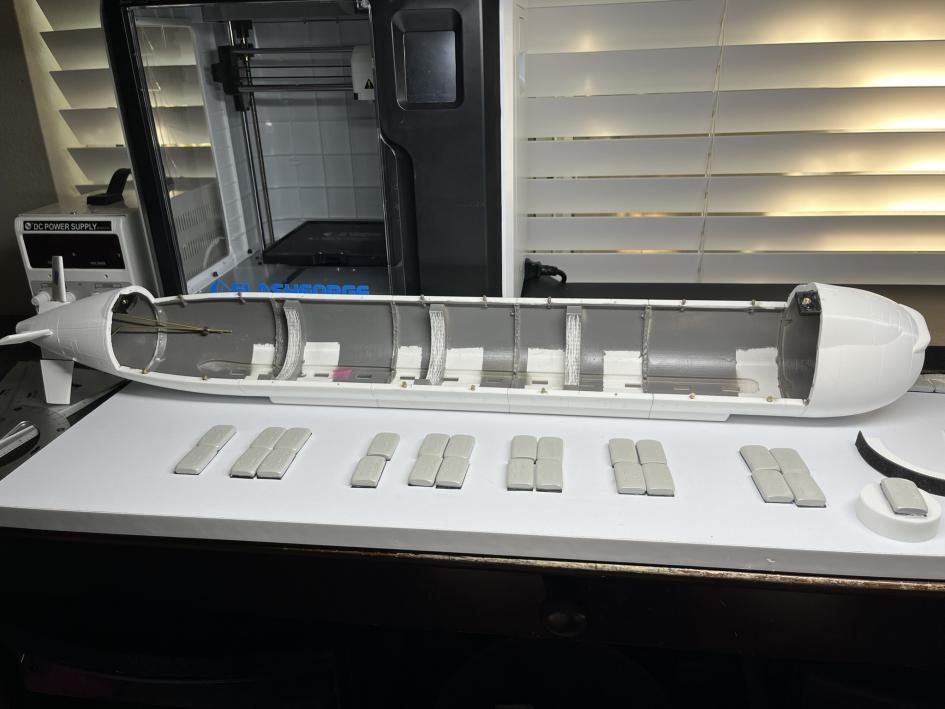

                        #86

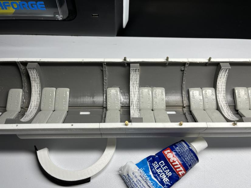

                        I have managed to work in some sub building time today!
                        Click image for larger version  Name:	GERMAN 212 A 85.jpg Views:	10 Size:	66.6 KB ID:	179407
                        I have finished securing (gluing) using silicone adhesive the ballast weights to the bottom hull section of the 212.
                        Click image for larger version  Name:	GERMAN 212 A 86.jpg Views:	10 Size:	63.7 KB ID:	179408
                        I am also starting to work on the Stickleback again.

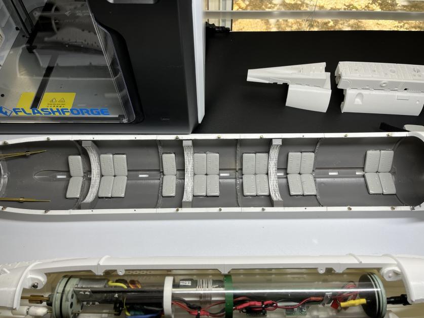

                          #87
                          More work on the bottom hull section of the 212.
Name:	German 212 A 87.jpg

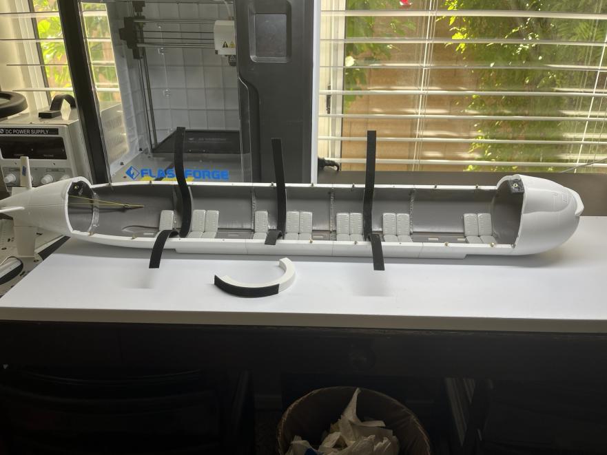

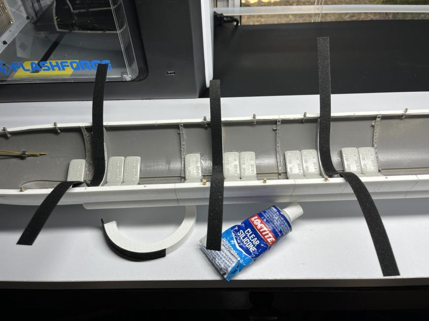

                          I have prepared the cylinder saddles for the Velcro hold down ties.
Name:	GERMAN 212 A 88.jpg
                          I will be using clear silicon adhesive for securing the Velcro to the saddles
                            #88
                            Today I prepared our swimming pool for the summer and (cool morning sub runs)
ID:	179439 Click image for larger version
ID:	179440 Click image for larger version
Name:	Nautilus Three.jpg

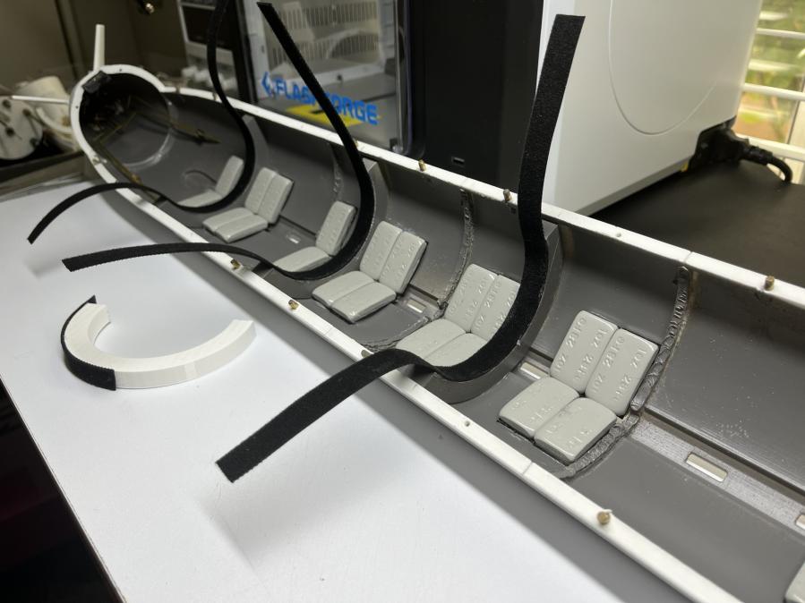

                            I also made sometime to install the velcro straps for holding in place the 300 series Easy Driver.
Name:	GERMAN 212 A 89.jpg
Name:	GERMAN 212 A 90.jpg
                            I now have both the upper and lower hull sections ready for the Easy Driver. Next I will tie in the rudder/dive plane linkage and the propeller shaft, and after this is complete we will start in on the trimming the boat out.
                              #89
                              Looking awesome, Rob!
                              I could see in the photos how the spray paint melted the foam flotation blocks a bit. If you're going to paint foam, it should normally be done with acrylics. Light dustings of normal rattle can paint can work, but you need to keep the first couple of coats really light, let them dry, and then add more as the first layers form a barrier.
                              Other things foam doesn't like include CA glue, solvents of any kind, and almost any heat source...
                                #90
                                Thanks Bob,
                                Should have known better!:-(( Pink could have been a better choice. I attached the foam, weights, and the velcro with silicon adhesive which really worked well.
