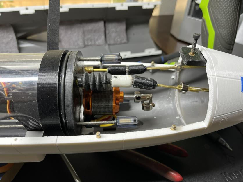

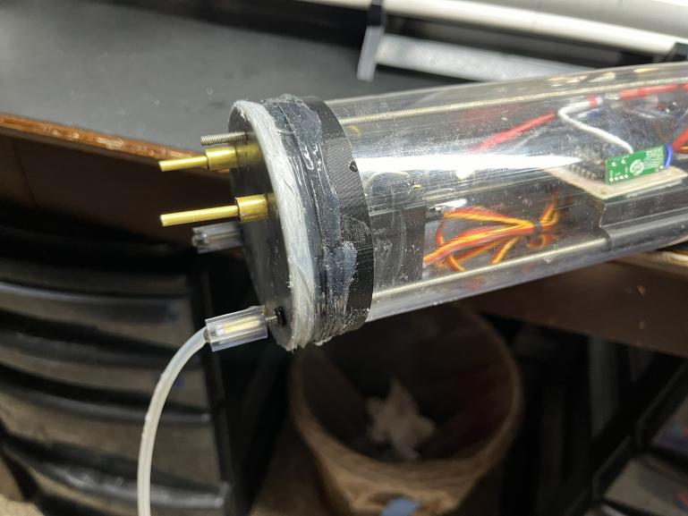

          I have made several attempts to get this new cylinder leak free.
Name:	GERMAN 212 A 100.jpg
ID:	179890 Click image for larger version
Name:	GERMAN 212 A 108.jpg
          I did manage to seal up the issues on the forward end cap. I took the push rod on the rear end cap out cleaned it up, installed a new cup seal to see if this might correct that problem. Did not have success with that.
          As a final and last resort, I took the push rod out again and installed a bellow over the existing bushing and push rod and sealed it all up with silicone adhesive.

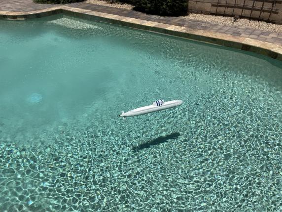

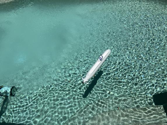

            After having all the issues I have had with the 300 series Easy Driver with leaks, and getting the X-Tail setup working to some degree of success, the 212 A is in the water and operational!
            Video link
            The turning radius is limited do to the size of the pool, and I understand that. But the boat looks good in the water and it does run! I call that a successful boat build and run for me! Now some final finish work on the sail, sand and primer, and a final paint scheme applied and I can call this boat DONE!! :-))
            Click image for larger version  Name:	GERMAN 212 A 111.jpg Views:	0 Size:	63.9 KB ID:	179910
            Click image for larger version  Name:	GERMAN212 A 110.jpg Views:	0 Size:	62.2 KB ID:	179911
            Thanks for all the participation and input that I have had with this build! Moving on!
