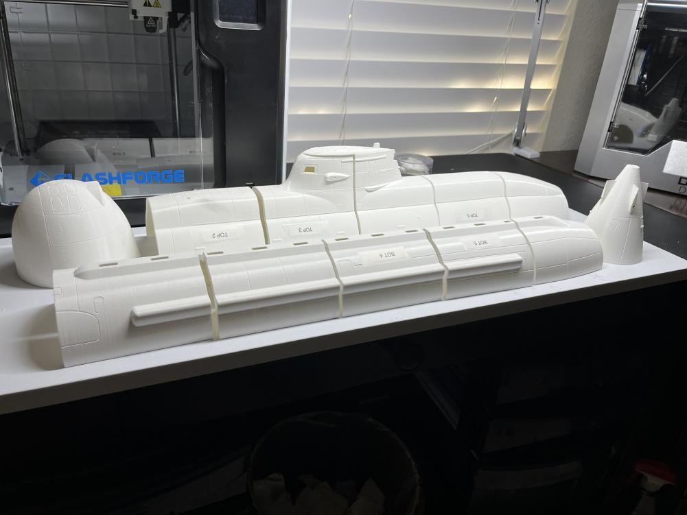

    With all the 3D printed parts completed, I am going to start the glue up procedures. After considerable study of the different stern section linkages, I have pretty much made up my mind as to how I am going to do!

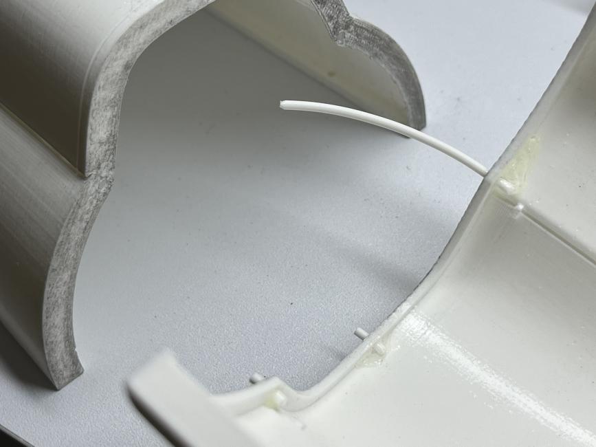

          One of the ways I use to help alien the parts, is to use PLA filament.
Name:	GERMAN 212 A 32.jpg
          The files on the 212 come with the alignment holes already provided. The standard size PLA works great for the alignment pins.
          "Firemen can stand the heat."

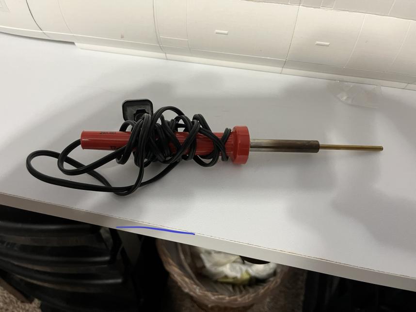

            #35
            Great thinking, Rob. You could also use a soldering iron to fuse the nubs to the hull itself, almost like a permanent rivet.
              #36
              Bob,
              You read my mind! (that's scary)
Name:	GERMAN 212 A 34.jpg
              I am in the process of taking one of my old soldering irons, and fabricate a brass rod with a slightly flat chisel tip. This will accomplish exactly what you are suggesting.

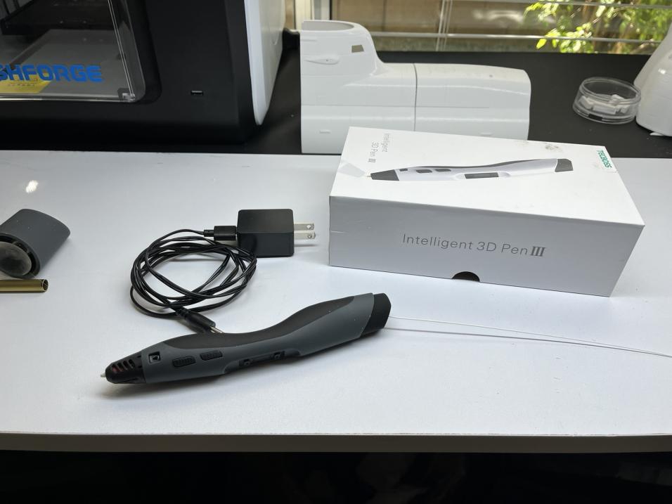

                Here is another tool that will help fill in gaps and make more positive joints in PLA.
Name:	GERMAN 212 A 35.jpg
                It is a PLA Melting pen. It's great for filling gaps..

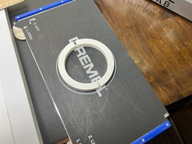

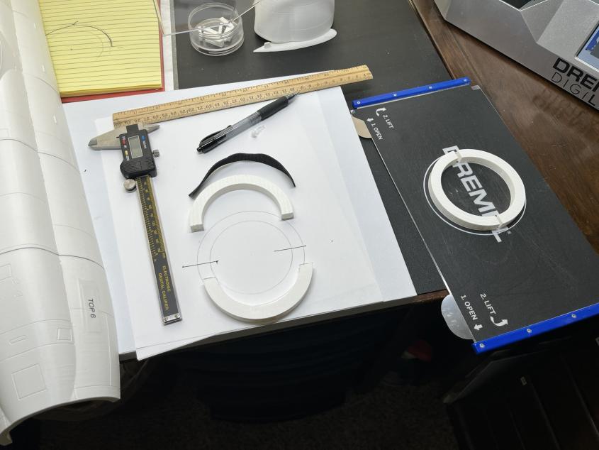

                  Today I spent my time designing the hull cylinder holders for the 300 series EasyDriver.
                  Click image for larger version  Name:	GERMAN 212 A 40.jpg Views:	0 Size:	43.9 KB ID:	178822

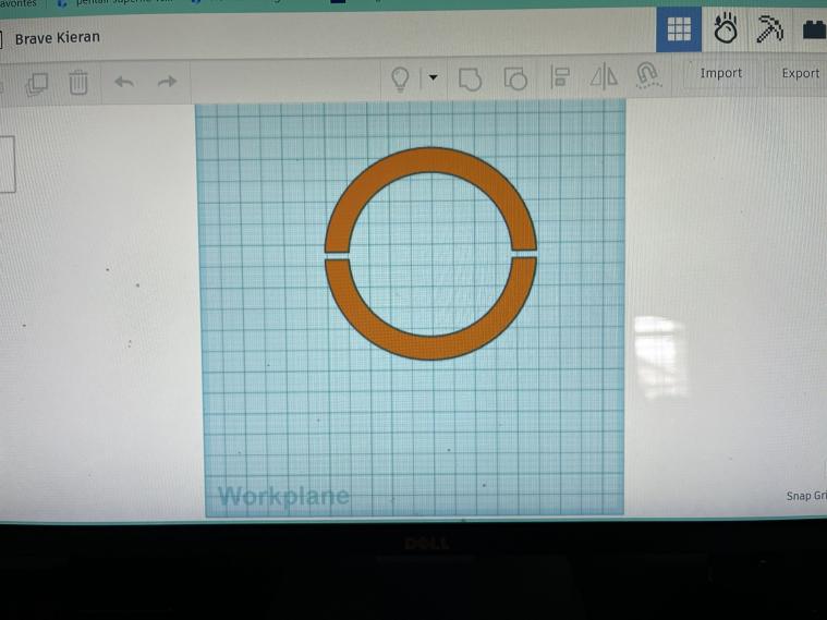

                  After I did some paper drawing for the sizing, I went to Tinker Cad and set up the design for STL printing.
                  Click image for larger version  Name:	GERMAN 212 A 36.jpg Views:	0 Size:	56.2 KB ID:	178823
                  Click image for larger version  Name:	GERMAN 212 A 37.jpg Views:	0 Size:	49.5 KB ID:	178824
                  I am most likely going to use 4 of the holders. So I set up my Dremel to print out 2 at a time.
                  Click image for larger version  Name:	GERMAN 212 A 38.jpg Views:	0 Size:	49.4 KB ID:	178825
                  The Velcro will not only give some padding, but will also be used as the cylinder hold downs.
                  Click image for larger version  Name:	GERMAN 212 A 39.jpg Views:	0 Size:	61.6 KB ID:	178826
                  The holders turned out very good and fit nicely around the cylinder.

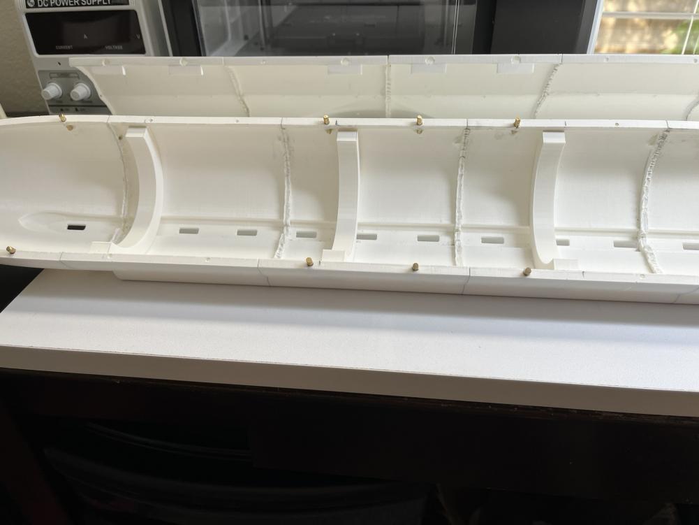

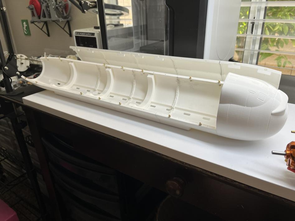

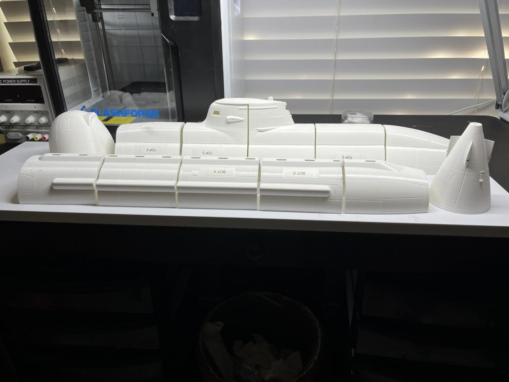

                          Today I managed to make a little more headway on the hull.
Name:	GERMAN 212 A 41.jpg
                          I glued up the bow section using the PLA pins and CA. I also used the soldering iron to melt the bow section to the hull. Which by the way was another good suggestion from Bob Martin. This idea has certainly strengthened all the sections on the hull.

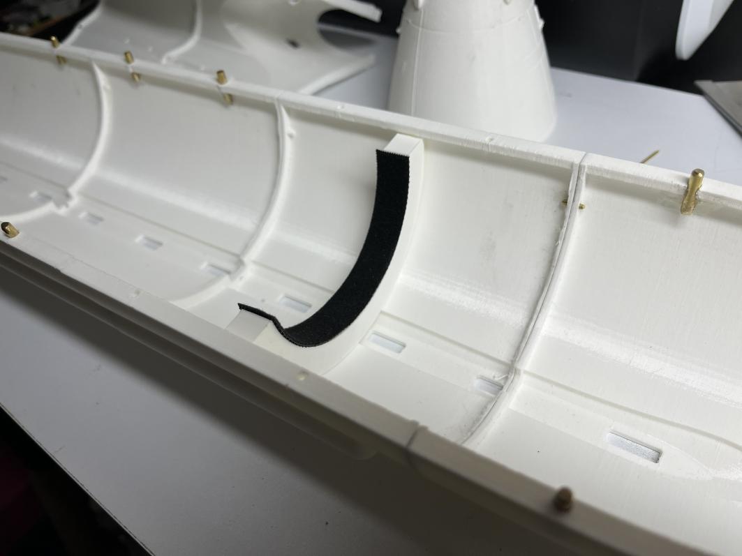

                          I also 3D printed the cylinder saddles and glued them in as well.
Name:	GERMAN 212 A 43.jpg
                          I also sized and cut the Velcro straps that will be glued inside the saddles to secure the cylinder to the saddle itself.
                          Next will come the installation of the control linkage system to the inside of the stern, and then glue the stern section to the hull.

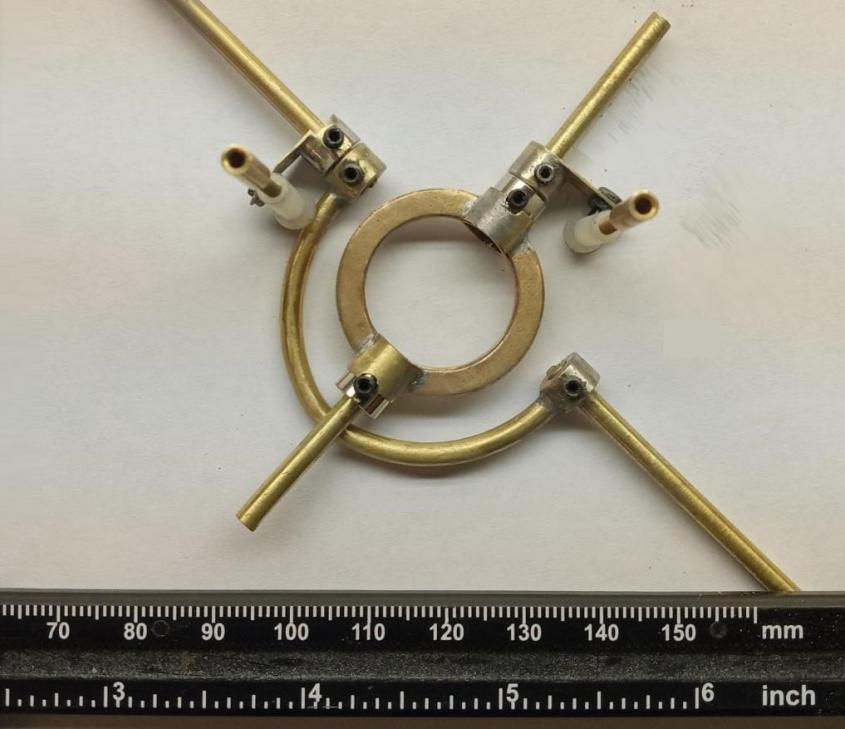

                            As you , comparing your 212 build with my Dolphin 2 build.
                            Interesting design, that works well for the hull halves.
                            In my Dolphin 2, Bob Martin took a different tact for making my WTC supports. Because my WTC will be inside a free flooding PVC pipe, the supports for the WTC are in the ends as rings. I'm sure both ways will be effective. The future batteries will be in heat shrink tubing waterproofed between the WTC and the hull bottom.
                            The clearance isn't enough for the batteries with the PVC pipe alone, but a midships longitudinal large slot will be cut and the line of batteries laid into the PVC pipe slot out the bottom. The long bottom fairing extending down will then provide plenty of room and make the hull even more free flooding while and still scale.
                            The bottom fairing will be removeable too providing easy battery access. as well as lowering the boats center of gravity metacenter making her a more 'stiff roller'. Thats the idea will see. That stage in building approaching quickly.
                              #44
                              Steven,
                              Our two boats (Dolphin & 212 A) are very similar, especially with the X tail stern.
Name:	DOLPHIN 2 A.jpg
                              I am very impressed with the brass linkage system that you built. Really excellent work Steven! If it is OK with you, I may try and duplicate what you have done here for my 212!? It is a really clean and effective.looking system.
                              I can see where your cylinder hold downs would be different because of your PVC hull section.

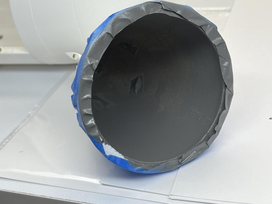

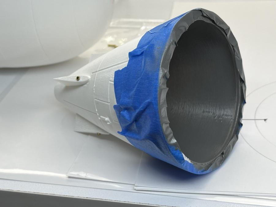

                                #45
                                Before I start on the stern linkages!
Name:	GERMAN 212 A 45.jpg
Name:	GERMAN 212 A 44.jpg
                                I sprayed the interior of the stern with a primer/paint coating. I did not want to spray paint after the linkages have been installed.
