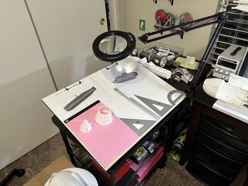

      David M's influence strikes again! " It's hard to know which road to take without a map" I can now see that a SCALE drawing of the interior stern section will allow me to design a yoke
      (to scale) that will make fabricating and installing it much easier.
      I realize a lot of you will laugh somewhat at me putting up my drafting table, and that is fine, but I now understand how prior design and planning can make the overall fabrication go much better in our submarine building... And to that end, we build on!

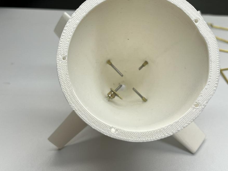

        Well after attempt and attempt, I am going back to my original design.
Name:	GERMAN 212 A 47.jpg
        My poor eyesight just won't let me work like I used to. And without elaborating I am going to work on the original method.

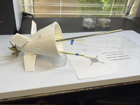

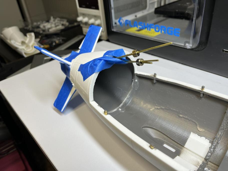

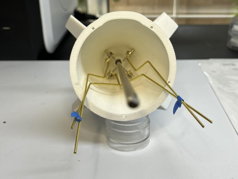

              Early this AM I was able to get the rudder/dive plane linkages all hooked up, and to my surprise they work properly!
Name:	GERMAN 212 A 56.jpg
Name:	GERMAN 212 A 57.jpg
              I also installed the brass sleeve for propeller shaft. The stern section is now ready to be attached to the bottom hull section.
              All in all, I think the linkage system that Bob has designed for his German 212 A kits is very much workable. Just follow the video and use the templates.

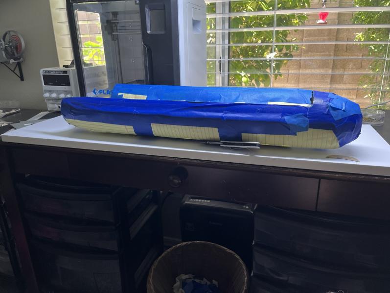

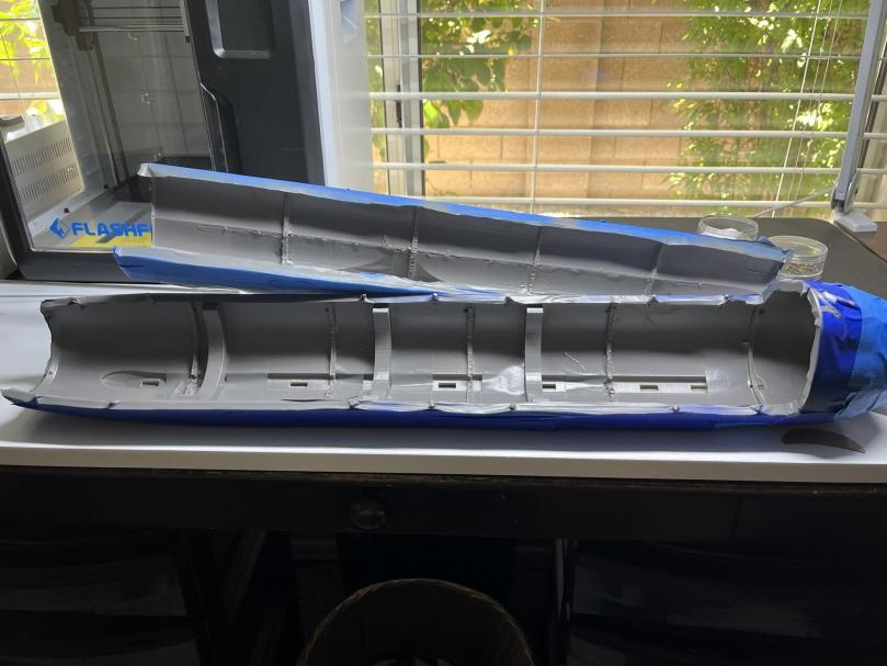

                Last night I masked off the hull exteriors in preparation for the interior sealing work.
Name:	GERMAN 212 A 58.jpg
                I applied one light coat of two part finishing resin. Let it dry 12 hours, and then one light coat of primer, and one coat of spray on grey rust-oleum paint.
Name:	GERMAN 212 A 59.jpg
Name:	GERMAN 212 A 60.jpg

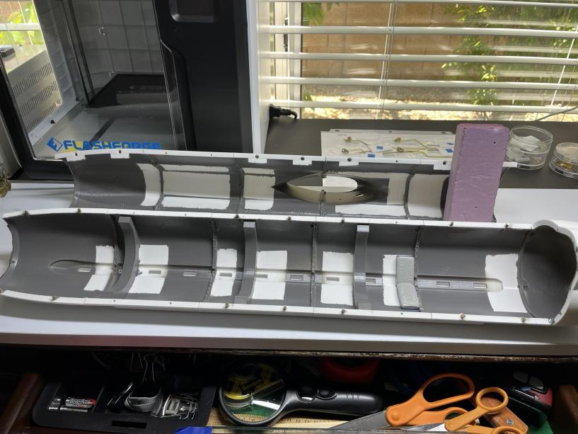

                Prior to applying the interior seal coats, I masked off the areas where the weights (in the bottom) and the foam (in the top) will be attached to the hull sections. Leaving these areas clear of the sealer will allow for better adhesion for the weights and the foam.

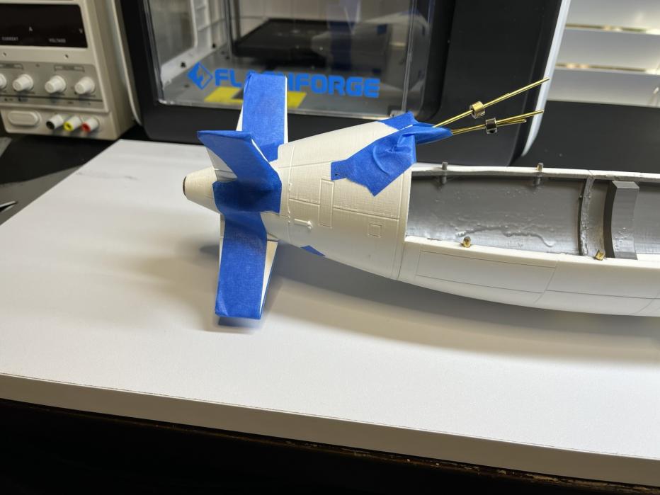

                  I have the stern section now attached and secured to the bottom hull section.
Name:	GERMAN 212 A 62.jpg

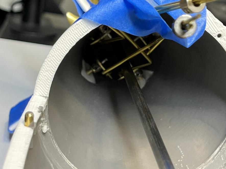

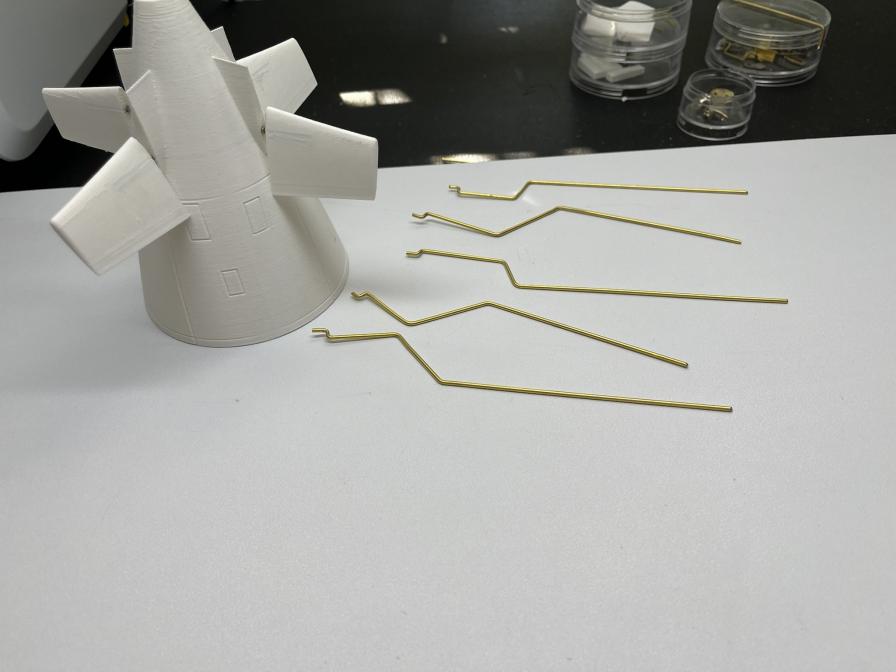

                  I also installed the "X" tail linkages, and they operate properly! :-))
Name:	GERMAN 212 A 63.jpg
                  Not a very clear photo showing the prop shaft installed along with the linkage and everything works in the clear. Note: Again I will give Bob Martin (Nautilus Drydocks) credit for the "X" tail linkage design. It really does work well, you just need to take your time follow his schematics and pay attention to his build video, (and maybe a little cussing) and it will work...
                  Next inline will be the installation of the flotation foam and the ballast weights.

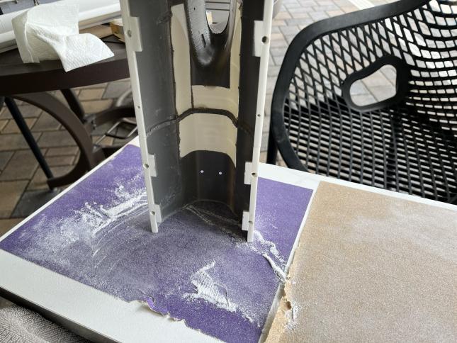

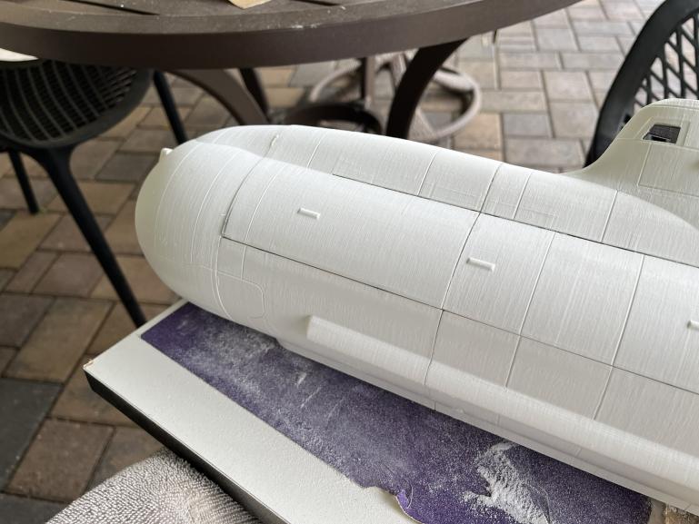

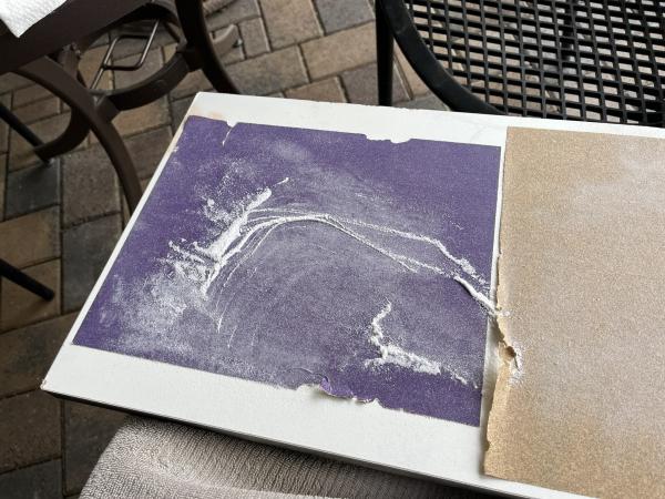

                      Today I had a little bit of fitting work to do. The top hull section would not fit the bottom hull section.
Name:	German 212 A 64.jpg

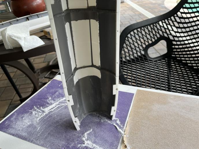

                      To the sanding board I went. I do not have any power sander for this job, so all hand work!
Name:	GERMAN 212 A 65.jpg
Name:	GERMAN 212 A 66.jpg
                      After about an hour of sanding, I finally relieved the approximately 1/8" to get the top section to fit.

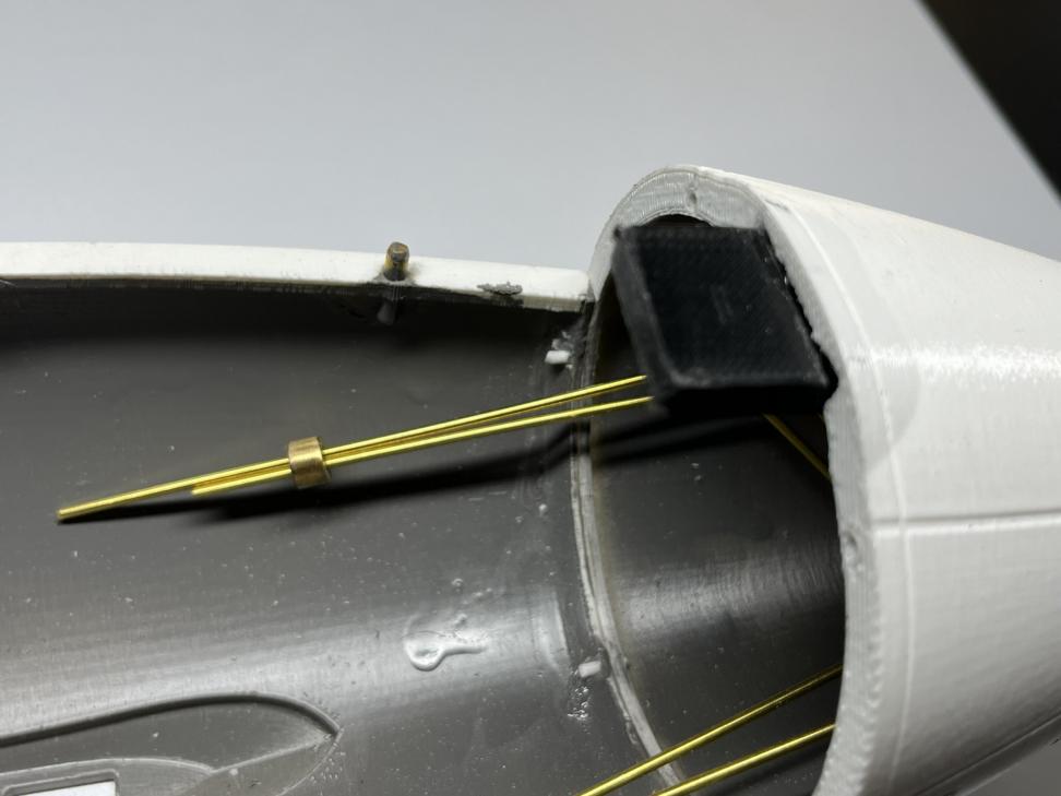

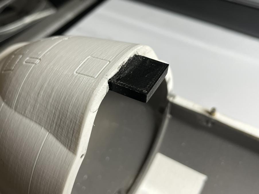

                        Today I fabricated and installed the stern and bow hold down brackets for the hull top section.
Name:	GERMAN 212 A 69.jpg
Name:	GERMAN 212 A 70.jpg

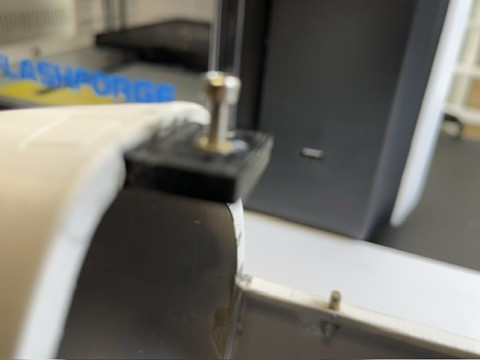

                        Next I will install brass inserts for the stainless steel hold down screws.
                        "Firemen can stand the heat."
                          #72

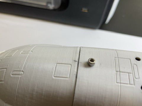

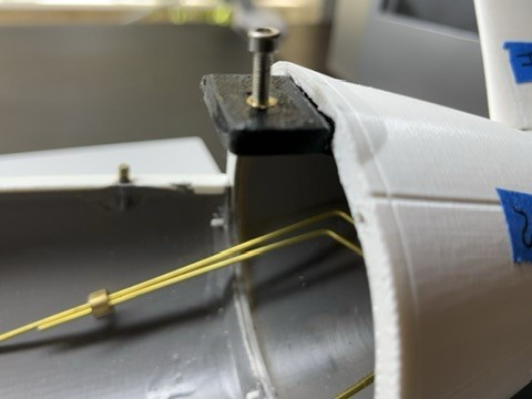

                          I know some of my photos might be somewhat boring, but it is all part of the build!
                          Click image for larger version  Name:	GERMAN 212 A 71.jpg Views:	0 Size:	31.5 KB ID:	179238 Click image for larger version  Name:	GERMAN 212 A 72.jpg Views:	0 Size:	26.4 KB ID:	179239 Click image for larger version  Name:	GERMAN 212 A 73.jpg Views:	0 Size:	25.6 KB ID:	179240
                          I installed the brass inserts for the stainless steel hold down screws for the stern and bow of the upper hull.

                            Rob, can you direct me to where you purchased the inserts and screws?
                            Bruce

                              Rob,
                              Please switch to flat head, countersunk screws, SO much prettier, and in keeping with the rest of the boat's appearance! ;)
