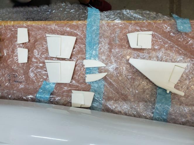

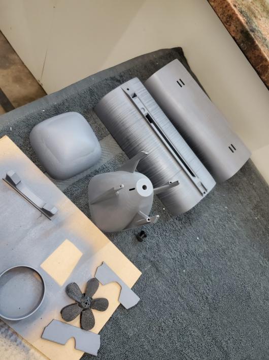

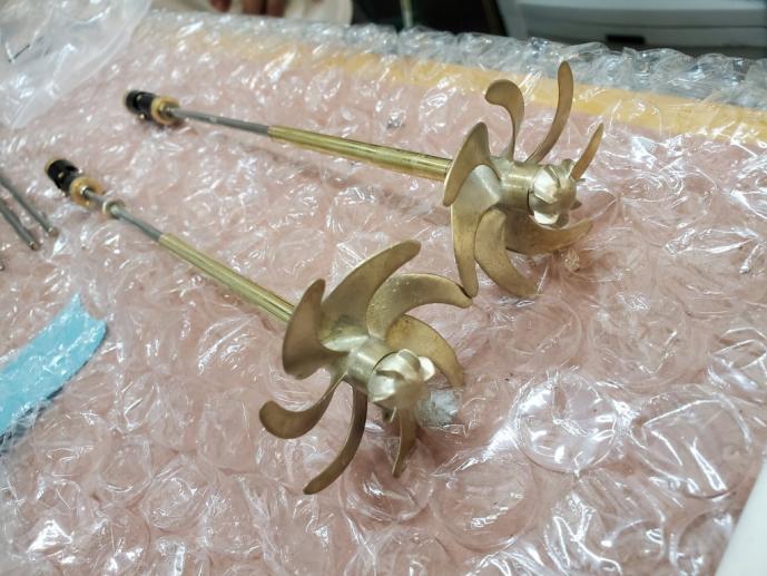

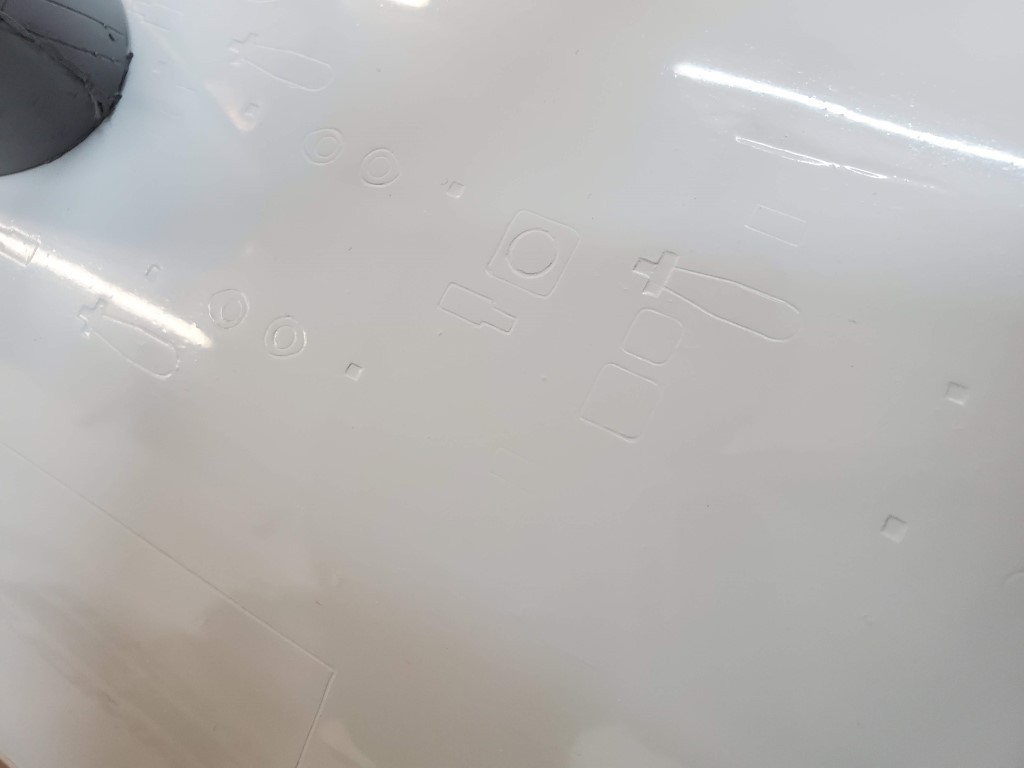

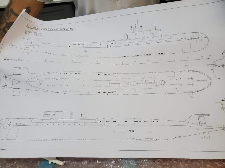

        Lots going on at the Drydocks over the last few days!
        In conjunction with OTW, we're happy to announce the release of our new 1/96 Russian Oscar II kit. The master patterns were created by Kevin McLeod and they are amazing. The model measures a massive 1613 mm ( 63.5 inches) with a beam of 190 mm ( 7.48 inches). Layout drawings are included. I now have the model queued up for a prototype build in order to create instructions. If you are an experienced builder and don't need a walkthrough, it is up and ready for purchase on my site here.

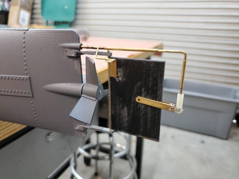

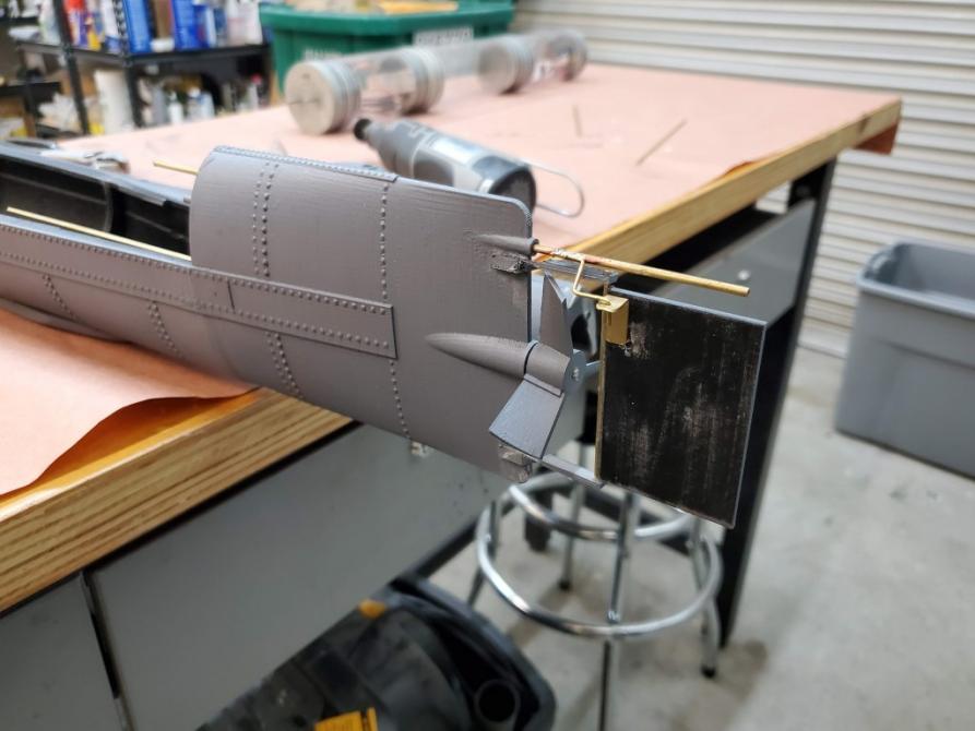

        The Hunley is coming along nicely! I may throw in the towel trying to get the authentic rudder linkage to work. I gave it the ol' college try, but that setup is actually really dynamic with a lot of moving parts. I elected to go with a conventional linkage, which is working perfectly.

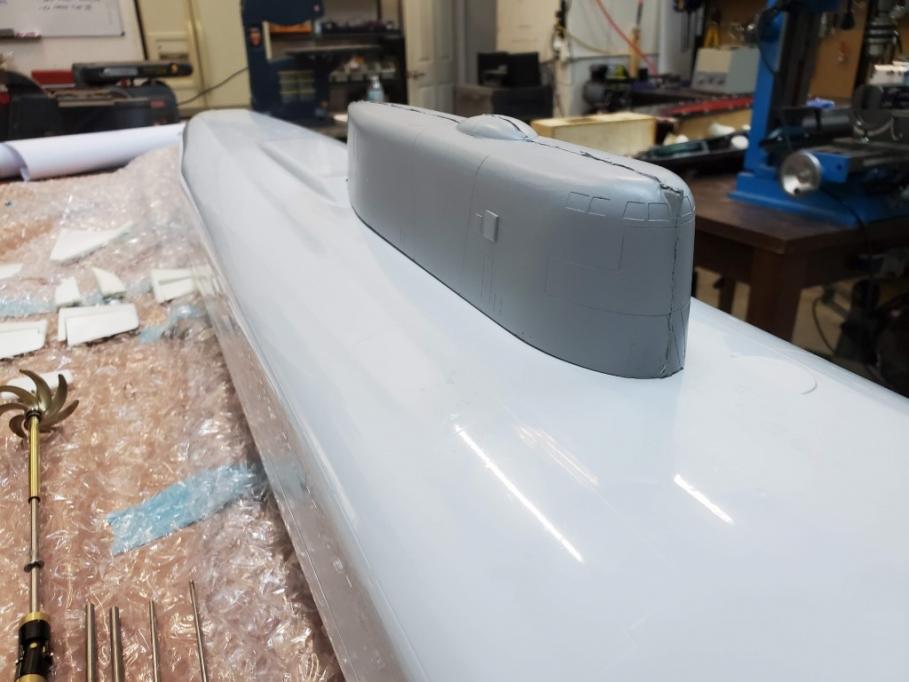

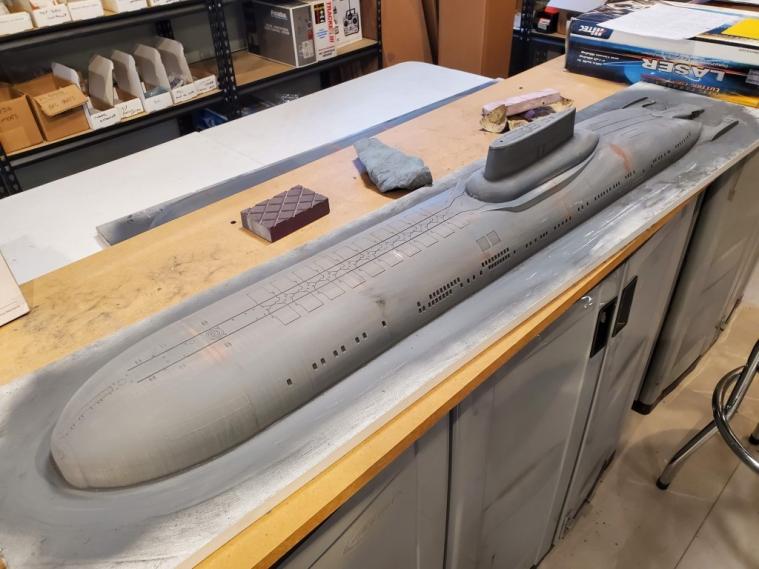

        Picking away at Typhoon. Lots of sanding for a perfectly smooth finish from the slightly grainy texture that the printing netted.

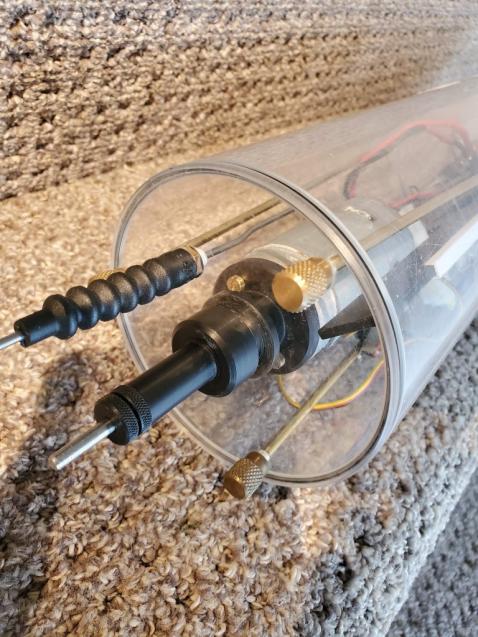

        The prototype cylinder is nearly complete! I encountered some issues getting a perfect valve built for opening and closing the snorkel air intake. I had a revelation last night that I feel is going to be ideal. I'll give it a shot today.
        Once done, this will get installed in the Hunley.

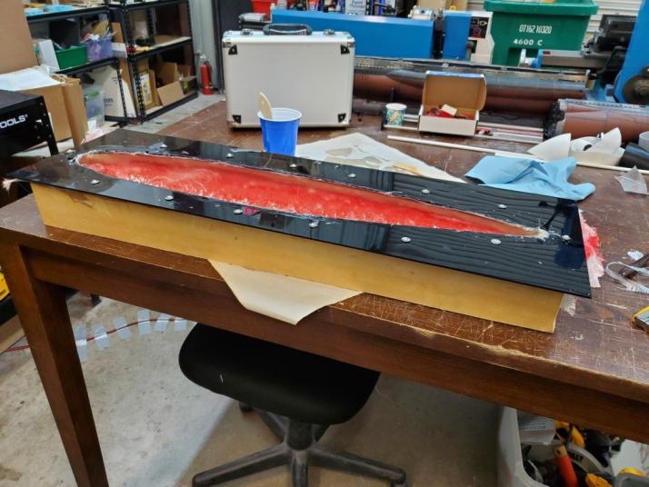

        The 1/6 Delphin first layup is in the molds and we will be de-molding this morning. The mold is symmetrical top and bottom, so one mold handles both.

        This is the cylinder that I'll be modifying for use in the Arkmodel Type VII buildup for Ed. Bigger than the "stock" 2.5" unit with a stubbier tank for better water control.

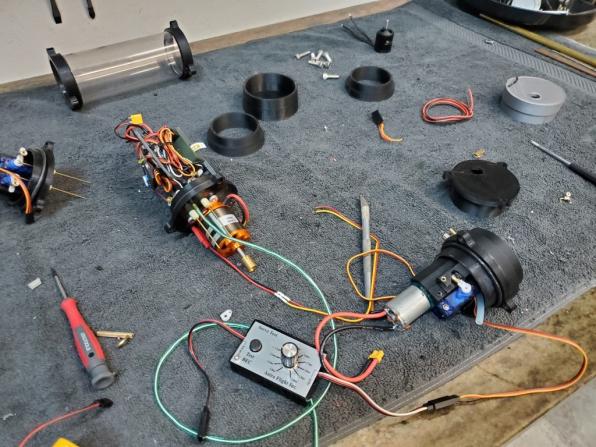

        This was a weird one... I had an OTW cylinder come to me for refit. The owner said that the motor was "broken" and wouldn't spin. It just "grinded". It turns out that the seal assembly was completely melted and fused to the stainless drive shaft. I have NO IDEA how he did that. I couldn't figure out a way to do that if I TRIED! At any rate, Jason and I disassembled it, cleaned it up, machined new clean faces to the parts and installed a bigger seal. Working perfectly now and I'm pressure testing it this morning.

            Took a few minutes and finally nailed down the Hunley rudder linkage. The actual actuation takes place via a traditional push/pull linkage, but the swivel linkage is there for aesthetics. Works well on the bench and I'm getting about 30 degrees of throw. Not sure that I like the 3D printed rudder supports, but they're holding up so far.

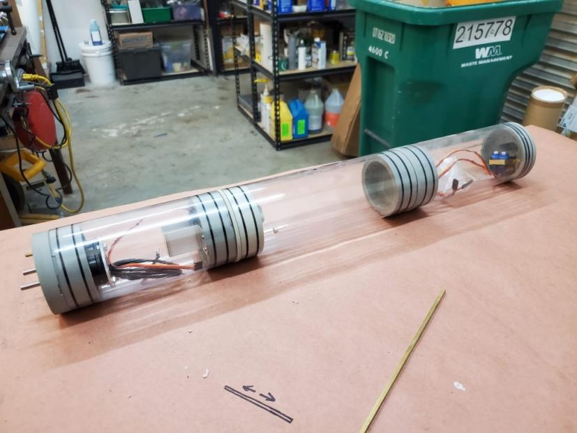

            The MKIII SubDriver is nearly ready for installation in Hunley. Two more 3D printed parts to install and we are on to testing for leaks and fitment into the hull! Lots more detail on this new version to come soon, including a dedicated video. DiveTribe members get an exclusive preview this Sunday at 2pm! Not a member? Why the hell not!?
