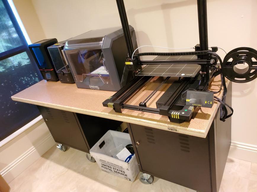

    I just got a new workbench for my 3D printing station. Got it put together and set up in the morning while the rest of the clan slept. Much better than my abomination of plastic shelves and collapsing tables I had previously!:
    Click image for larger version  Name:	20200328_121308.jpg Views:	0 Size:	72.5 KB ID:	137465

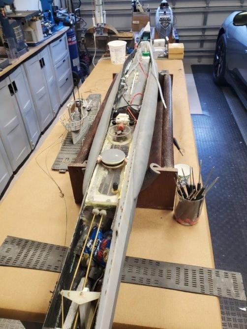

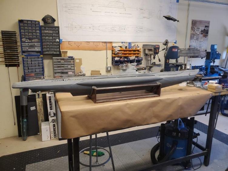

    Work continues on the big German Type VII for Marcel up in Quebec. Inspired by Ed's writeup on his Skipjack, and proven with my MSS experiment (click here for the write up on that one if you haven't already seen it) I am working on the rear control compartment. This one houses the twin drive motors, ESC, rudder and rear plane servos, Depth Controller, Battery and Link Monitor, Pitch Controller, ballast air pump, equalization valve, emergency blow switch and HP15 electronic switch for ballast.
    Yes, it looks like not much more than a container of multicolored spaghetti with metal meatballs, but trust me, it works (or it should... I really HOPE it does....)

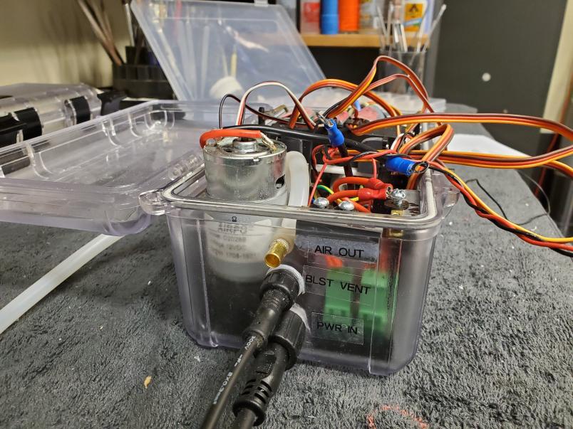

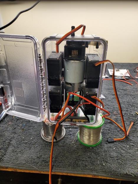

    The forward control module will house bow thruster controls, servos for bow planes, bow plane retracts, torpedo doors and torpedoes, along with the periscope pump.
    Click image for larger version  Name:	20200330_200242.jpg Views:	0 Size:	100.9 KB ID:	137467Click image for larger version  Name:	20200330_200240.jpg Views:	0 Size:	97.7 KB ID:	137468

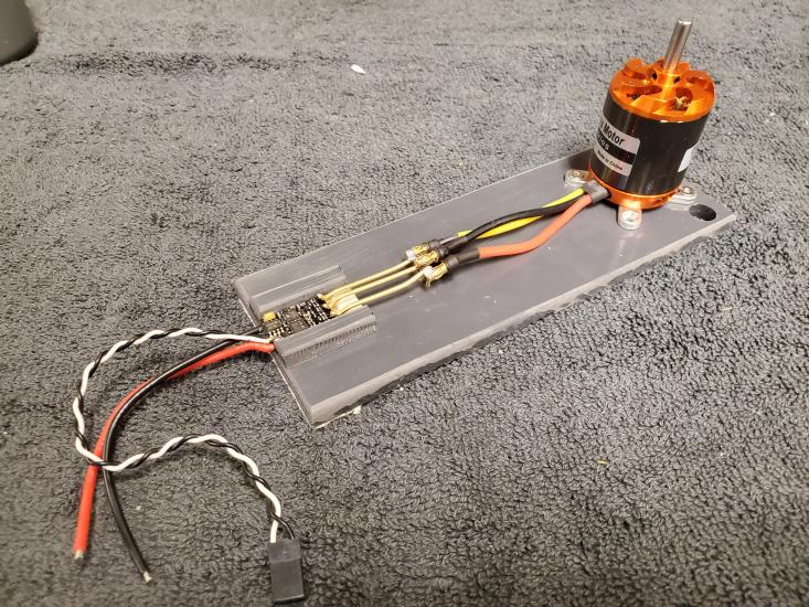

    This is the new programming and test rig that I built for the superb little BLHeli32 ESC's that Andy put me on to for the new MSD cylinders. The ESC's are literally the size of a postage stamp and offer TONS of programmable features. This rig allows me to program each ESC and test for functionality before bundling with the cylinders for shipping.
    Click image for larger version  Name:	20200330_113437.jpg Views:	0 Size:	113.9 KB ID:	137469
    Is that motor/esc rig mounted on a sheet of metal or plastic? If it's the latter then you might want to flip the esc over the other way, as I think the mosfets may be face down at the moment, and that won't help them keep cool.

      The rig is plastic. Bear in mind that there is no heat buildup during programming, and testing takes about 3 seconds, so no appreciable heat will be generated. All that said, I can also simply flip the ESC over if it's determined to be an issue.

        If it's just for programming and light loads then no problem, I thought you were going to be using it for testing props etc. If you use a arduino uno or nano to program the escs, you can program several at once , which saves a lot of faffing about.

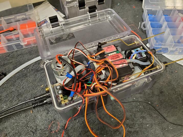

                More work on the XXI!: I completed most of the work on the rear drive module and moved on to the forward compartment. This one will house the geared water pump for hydraulically actuating the periscopes, an ESC to control that, an HP15 switch to control the bow thrusters, and four servos, one each for: retracting planes, bow planes, torp doors and torp launch. I may link the torp doors and retracting planes to operate from one servo, freeing up one for future expansion. That means that the torp doors will open when the planes extend, which is basically what you'd want anyway. We'll see how I feel when I start hooking up linkages.
                All four servos are running linear conversions.
                Click image for larger version  Name:	20200331_211424.jpg Views:	0 Size:	62.1 KB ID:	137502

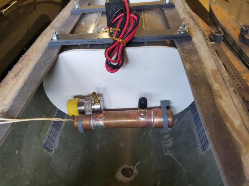

                I also had time to fabricate and install the emergency gas backup system. This will be plumbed into the pressure equalization channel, so it will be manually controllable and also automatically triggered by the onboard BLM.

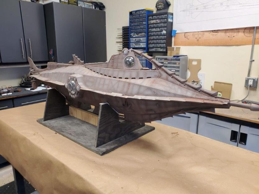

                I ended up trading Steve for his gorgeous 35th scale Nautilus and an old 32nd Parallel Type VII. They were shipped freight on a massive wooden pallet and they arrived yesterday from California. I enlisted the help of my son, Logan, to unpack and demolish the pallet. Nothing like prying at a massive wooden pallet with a claw hammer in 90 degree heat to help build character!
                Click image for larger version  Name:	20200331_133510.jpg Views:	0 Size:	57.5 KB ID:	137493
                The boats are really unique and I'm very happy with them. The Nautilus is built from the now out-of-production Custom Replicas 66" kit. This one had a really interesting story in that it started as a commissioned build for Steve years and years ago. I shipped him the kit and it arrived with twin dually truck tire tracks directly down the center of it. UPS paid for a new kit, but Steve worked model magic on the damaged hull and brought it back to glorious life once again, building it into his personal boat.
                This one has full LED lighting and all of the Gen 3 upgrades, including the photoetched brass deck and upgraded wheelhouse. It was originally built for an OTW cylinder, but I am loving the MSS modular box idea so much that I'm thinking I'll slate that for this boat if and when someone commissions me to build it for them.

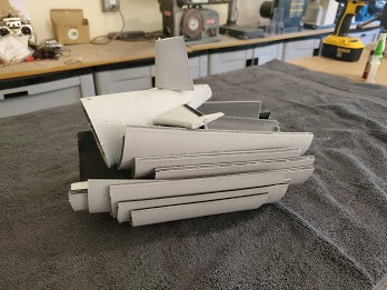

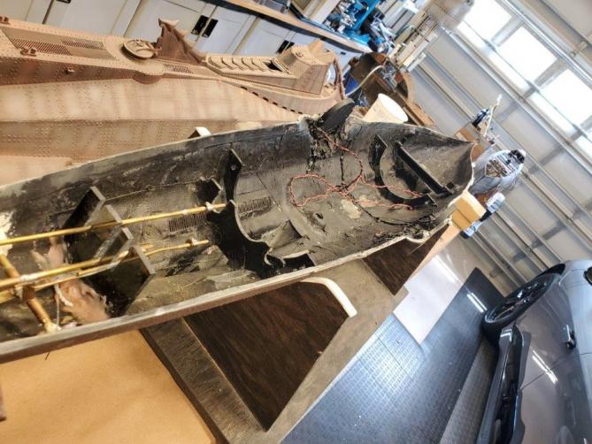

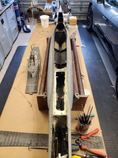

                        Today's tragedy (that David will no doubt secretly or not so secretly revel in). I was working on the new LA 3D printed prototype, doing some filling, sanding and priming. I wet-sand most of my work now, so I was working outside. I laid on some filler primer and then got a call from my former employer regarding a project that I'm working on for them. I had to drop my stuff and head inside for just shy of an hour.
                        When I got back, the entire hull was, for lack of a better term, melted. The upper hull, having been printed at a thickness of 2.5mm, was flattened, having spread about 2" from where it was supposed to be. The lower hull is thicker at 4mm thickness, but still warped along the entire length.
                        Could it be salvaged? Eh, maybe, but it would take a couple of hours of heating, bracing, cooling, heating and re-bracing, and it might never get back to proper shape. Taking my licks, I busted it back into it's component sections and threw it in the recycle bin. This will give me the chance to modify the files to make assembly easier, stronger, and incorporate the bulkheads for mounting the cylinder, too.
                        As a reminder, this file was created in conjunction with a gentleman up in Canada. He did the lion's share of the design, and I tweaked the files for better RC application. Hoping to nail this down and offer the files in the coming weeks.

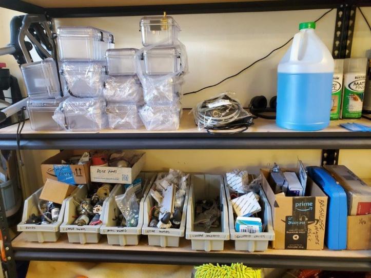

                              Yesterday didn't see a lot of building getting done, but there was a lot of other work going on. I sold the big Nautilus within minutes of listing it for sale on my site and sending my newsletter out. If you haven't subscribed to my newsletter, it's a monthly summary of what I did over the previous 30 days, upcoming products, announcements, etc. If you haven't signed up, I recommend it!
                              Most of my time was spent cleaning my home shop. Over the years, my parts bins got polluted and filled with all sorts of miscellaneous stuff n' things. It's amazing what I found when I was digging through all of the bins, drawers and shelves. There is definitely something cathartic about cleaning and organizing. Walking into the garage now is deeply satisfying! Sometimes you just need to take a break from the work and let the simple act of organizing something rest your brain.
