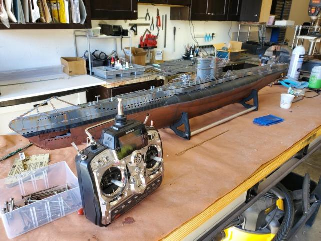

    Ed's Type VII is in the middle of trimming now. I ended up building an entirely new torpedo mounting assembly, as the original was getting ugly after the constant modifications for performance, reliability and fitment. I took the prototype, sketched a final version in CAD, and printed up the new mounting bulkhead. The good news is that this should drop right in for any Arkmodel Type VII model once I get into production (DON'T ask when that will be... it will come when it comes...******!)
    Here are some pics from preliminary trimming exercises in the new test tank. Hoping to have this done and ready for maiden voyage by the weekend!

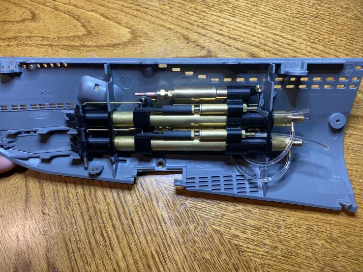

    More exciting news. I feel that I've perfected the setup for the 48th torpedo system. I extended the internal gas takeup tube and sleeved that for weight. The weapon is now nearly perfectly neutral when filled, and bobs on the surface nose-up when the run is done. Final configuration took three tries to get just right (V1, V2 and V3 pictured below).
    Most of the work lately has been on the launcher. I could have made an ultra-elaborate unit, but I am aiming for simplicity, reliability and ease of manufacturing. I shamelessly stole from David's baby launchers. These are basically spring-loaded and set off with a trigger that a servo will have no issue tapping open. Weapons swim out on their own power. Trials this week. Prototypes will be installed in Ed's Type VII
