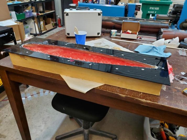

    The 1/6 Delphin first layup is in the molds and we will be de-molding this morning. The mold is symmetrical top and bottom, so one mold handles both.

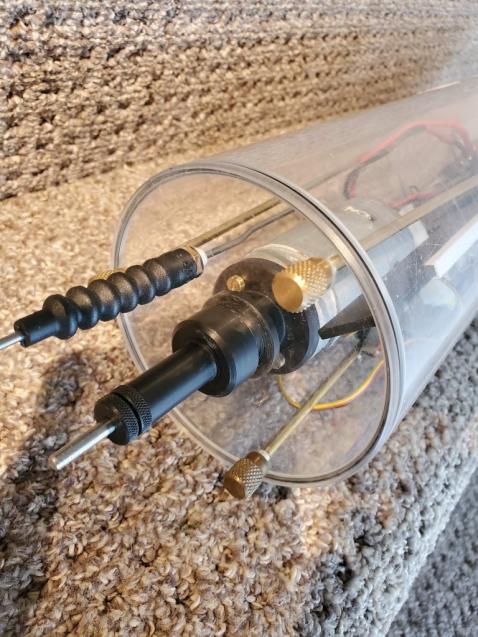

    This is the cylinder that I'll be modifying for use in the Arkmodel Type VII buildup for Ed. Bigger than the "stock" 2.5" unit with a stubbier tank for better water control.

    This was a weird one... I had an OTW cylinder come to me for refit. The owner said that the motor was "broken" and wouldn't spin. It just "grinded". It turns out that the seal assembly was completely melted and fused to the stainless drive shaft. I have NO IDEA how he did that. I couldn't figure out a way to do that if I TRIED! At any rate, Jason and I disassembled it, cleaned it up, machined new clean faces to the parts and installed a bigger seal. Working perfectly now and I'm pressure testing it this morning.
